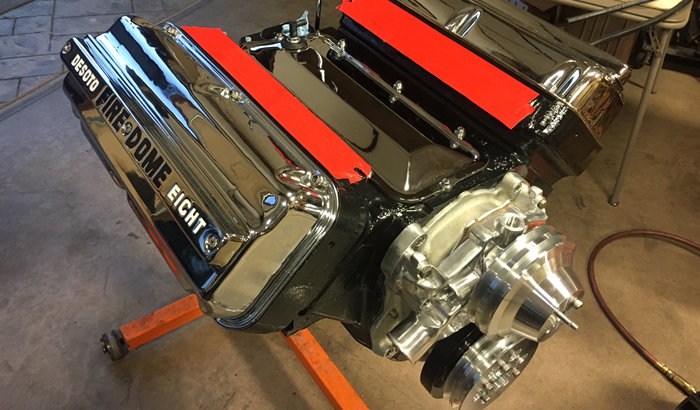

    I got one for my Desoto from Hot Heads.
    Stuck my SBC water pump on temporarily tonight to see if the pulleys are going to line up properly. Looks right on. An awful lot of spacers had to be used though, it still engages the hub but barely.
    bostonhemi likes this.
  22. DDDenny
    Posts: 11,857
    Thems' some shexy rocker covers Billy!

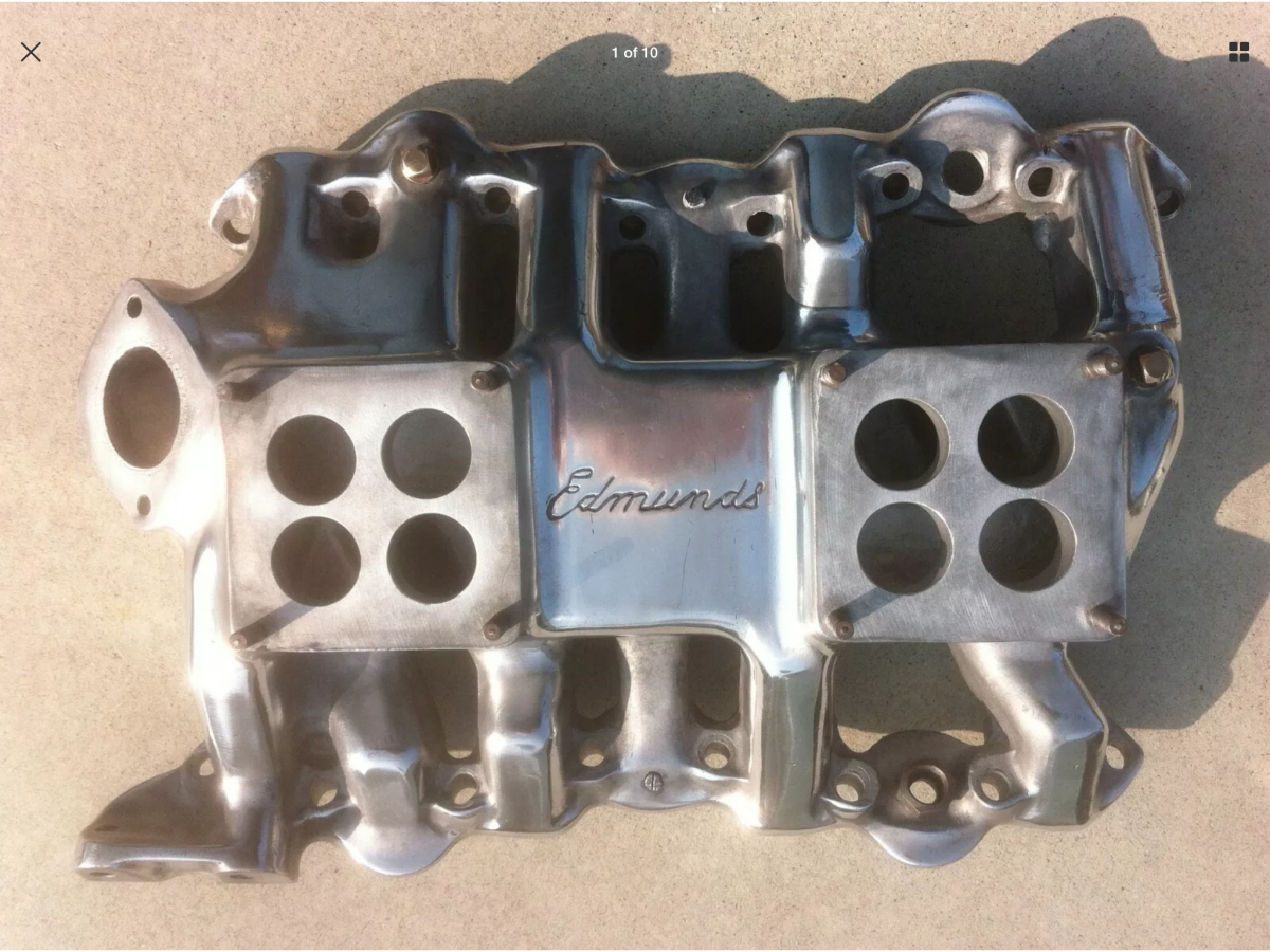

    This would be the proper manifold for my motor? 5CEF7332-5BC3-4D8B-A1B4-AA5FB2E37844.png
  28. oj
    Joined: Jul 27, 2008
    Posts: 6,100
    oj
    That Edmunds would be tits unless you find one of these: 001 (4).JPG
  29. loudbang
    Posts: 21,211
    That's a rare piece but I don't know if it will fit your engine. There is a thread here on the HAMB for Edmund intakes but can't find it at the moment.
  30. tubman
    Joined: May 16, 2007
    Posts: 4,190
    tubman
    We would need to see a bottom view. The '51-'53 heads have smaller ports than the '54's, so if was made for the early small port heads, it wouldn't be ideal for your engine. I have used later manifolds without the water outlets on the earlier blocks a couple of times. The NPT threaded holes in the manifold can be connected with the proper fittings and heater hose to a remote thermostat housing and you're done. I have a later Weiand dual quad on the '54 New Yorker engine in my dirt car. I think I can dig up a picture if you want to see how I did it.
