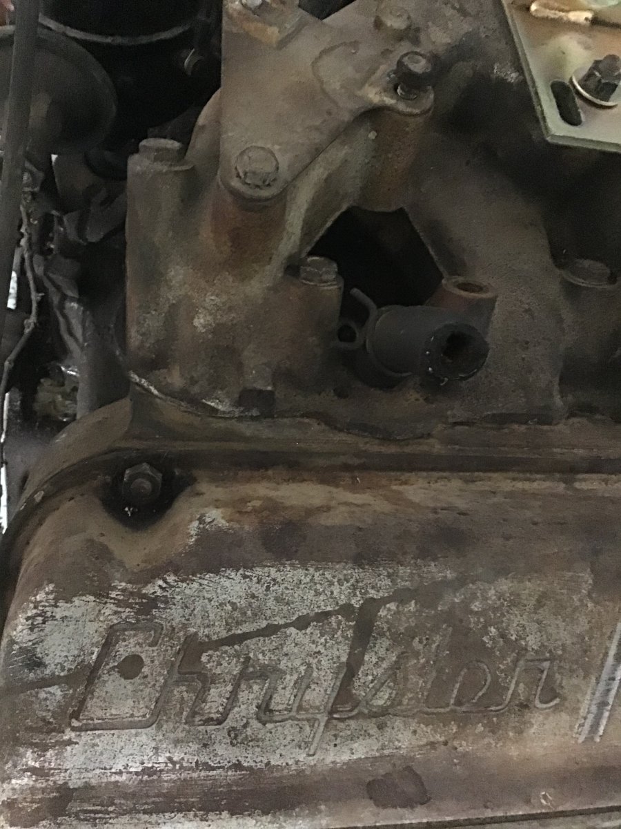

    5B92F980-D0B8-47F3-B31E-7FABA04823C4.jpeg Does anyone know what this cut off rubber hose is for? It’s on the passenger side, water?
  4. heater hose.
  5. Omarsvette
    Joined: Dec 7, 2013
    Posts: 272
    Omarsvette
    from Arizona
    Thanks, I can just plug it since in not using a heater
