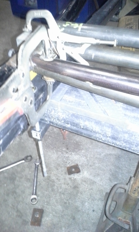

    My first recommendation is get a machinist level before anything. You will thank me later>

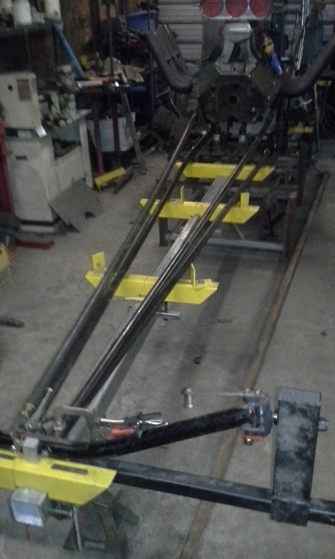

    Well I was able to re-do my seat uprights and made to carbon fiber seat work,I will run my front seat mount in the morning and tie everything in and try and get a few DZus fasteners in and get ready to start laying the tubes for the front end.
    As you can see I have setup my extendable jig by setting the front piece in place When I built the back part of the jig I added on cross braces to mount the part on and have it locked down. I have a few hours on the milling machine in the morning, The cross arms that are yellow that you see are being notched to fit down over the 3" tubing and then will have bolt plates that mount outside of the jig and have a piece of 1 1/2 square tubing that works as a pinch clamp that will allow me to square them up and lock them in place. The Since my tubes going forward are 1 1/4 I have taken some pieces of 1 3/8 tubing and cut them in half. I am them shaping some long bolts to fit the tubing and go into the slide cuts in top of the yellow cross pieces and can shim them and adjust the height and location on the yellow cross bars to lock down my lower rails. Pretty freakin smart if I do say so myself.
    Well thanks for following and your comments.

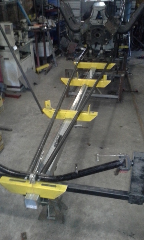

    OK Today I got my cross mounts fitted and anchored. As you can see with the pinch bars on the bottom you can level and square it up to the back part of the jig. I am setting up 4 cross bars to work a 10' run of the chassis tubes.
    I am running 1 3/8 rails coming through the engine compartment and will be stepping down to 1 1/4 headed to the front end.
    I will now work on my tubing mounts once I have everything PLUMB!

    The front axles in in place

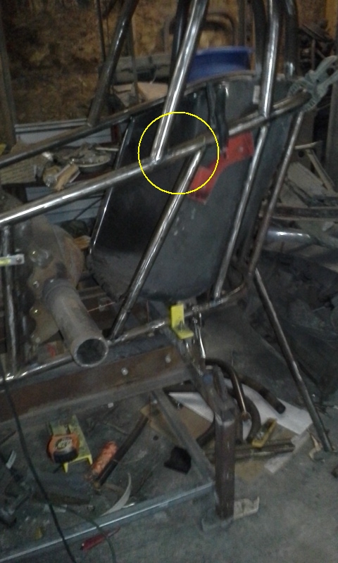

    blender,
    Shouldn't the chassis up right behind the rear axle housing be in alignment with the front roll cage hoop?
    McGurk
  16. dreracecar
    Joined: Aug 27, 2009
    Posts: 3,476
    dreracecar
    from so-cal
    NO, spec calls 1" min to 6" max space between the upper and lower. To put one on top of the other creates to much heat affected zone and can make that area to ridgid. having some space lets it crush a little instead of breaking.

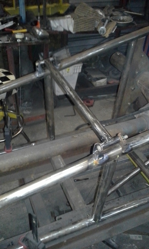

    I just got the lower rails bent and fitted. More of pain than I thought it would be but there is no tension on either rail so I guess the bends were right. Now One to the top. Thanks Mr. Bruce I wanted it to follow the mold of the seat, Do I need to add a diagonal. I already have the 1 3/8 inside the hoop to the rear bend of the hoop and past the front motor plate so it is pretty stout. I have also added an extra 2 bar in the back to make up for the width and make it a little safer I think.

    Well just got 1 upper rail bent and placed now I have to fit it on the lower and the front axle mount I hate pie cuts they take forever and I never like the way they fit.
  19. dreracecar
    Posts: 3,476
    dreracecar
    from so-cal
    At the point where the the end of the frame rails meet the top centerline of the front axle it should be 2.25-2.5" wide so that you have material encompesing 180* of the axle half tube mount and heat the ends and tap them down (taper) to finnish welding. If you try and fit the tubes smaller (1.75")your fit will be very long and require a whole bunch of welding whereas with going wider you may only have 10-11 inches instead of 20-22 inches. Lots of tacs and start in the back where the rails first meet and weld towards the front. Do the outsides first then the inside of the last one you did the the final inside.
    Its a good idea to put a diag in the rear end bay 3/4 x .058 min going from upper rear end mounting plate to the corner where the front seat uprite and frame rail meet. One tube can be welded in and the other removable to get the housing in/out

    Well I just about have the front end tubes finished. Mr. Bruce I am thinking of welding some plates on either side of those tubes were they pie cut, your thoughts?
  21. rooman
    Joined: Sep 20, 2006
    Posts: 4,045
    rooman
    If you do that it will look like a Cen-Pen frame and you don't want that. Just do it the way Bruce suggested (Don Long style).
    Roo
  22. dreracecar
    Posts: 3,476
    dreracecar
    from so-cal
    Dont over think this, adding plates is adding more heat & weight and serves no purpose.
