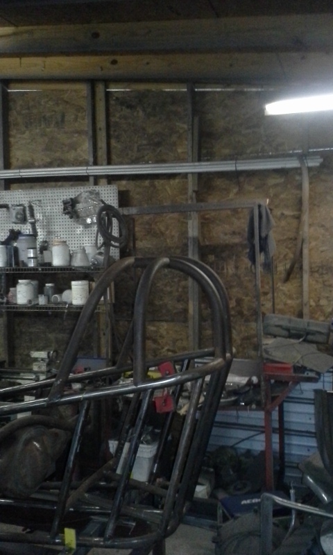

    Today started laying out the roll bar I used 1 5/8 .095. I Have my front rollbar set at 20 degrees and then went ahead and did a 6 point cage I still have a couple of parts left to put in I am using streamline tube on the top between the secondary hoop. A little confused about the the sfi specs as far as where bars are suppose to be I am thinking my size and long legs may cause me some problems on positioning. I have the front roll bar and the forward set upright 6" between the two. and I am about inch ahead of the other upright with my secondary bar, But I am way above the spec for the chassis and I have to make it fit me, not the inspector. So If I have to slow the car down and only run local tracks so be it. I did something interesting with the seat and will post pics of it later. Thanks for checking out the build. Mr Bruce thanks for the help yesterday.
    All in all I have to say it looks really good! I'm getting excited.

  21. blender
    Joined: Sep 24, 2006
    Posts: 56
    blender
    OK I want to know which one of you sick, twisted, sadistic chassis builders came up with the idea if fitting streamline tubing in the roll bar? I have been cutting and filing and sanding and grinding for hours and cannot figure it out for the life of me.
    I am a pretty smart guy and this is driving me crazy!
  22. Hey Blender...if it makes you feel any better, that tube is directly behind another tube, so the benefit of stream tubing is pretty much out the window...

  23. rooman
    Joined: Sep 20, 2006
    Posts: 4,045
    rooman
    The biggest benefit is the extra room above the driver's helmet.
    Roo

    Streamline has its benefits and looks great in the roll bar, I have just never fitted it before. But after 2 cigars, and a little cussing and a few sailing pipes I figured it out and once I did I couldn't get over how easy it was. I was just trying to make it harder than it was. Got to get my Halo bars bent and its done. Getting ready to start running the front rails and axle.

    Well I got the roll cage almost complete. STREAMLINE TUBING included. Mow I will run over to Boogie Scott's shop in the morning and have him make the bends in my 1" Halo bars, I don't have a die that small with my bender. And that will almost have my backend of the beast finished. I started making the swing bars for the steering after looking at Rooman's chassis. I will set the front bars up on my jig so I can start laying out the front frame rails and get the axle attached. I am using one of the Mark Williams front axles that was given to me by Steve Nicholl. If I can get this layed out by the weekend I can get the front wheels and tires on and maybe get the rearend setup and put it on the ground in the next week. Shops been slow his week so I have spent most of my time on the dragster. Its 7 o'clock and I think I am going to call it a day! Thanks for checking in!

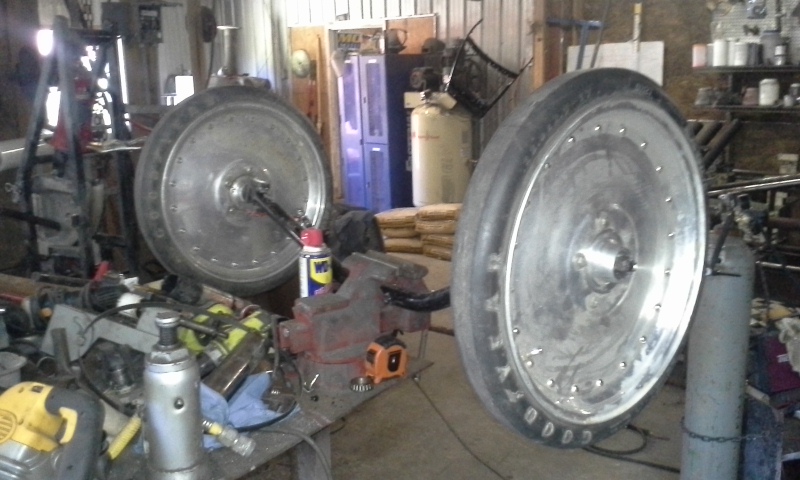

    Today started working on setting up the front axle, bearings,seals and wheel. All went pretty smooth. I had to do a little machining on the washers that the spindle nut goes in it was a little to thick for me to get a cotter pin in. I am wondering if there is a set length for the radius rods, a formula or something for the wheel base which is 160". I only have 4 " of clearance from the bottom of the tires to the bottom of the axle so it looks like mounting it in the lower tubes if going to be only option.
    When I filet the upper and lower tubes should I weld a plate on each side of the tubes to make them stronger?
