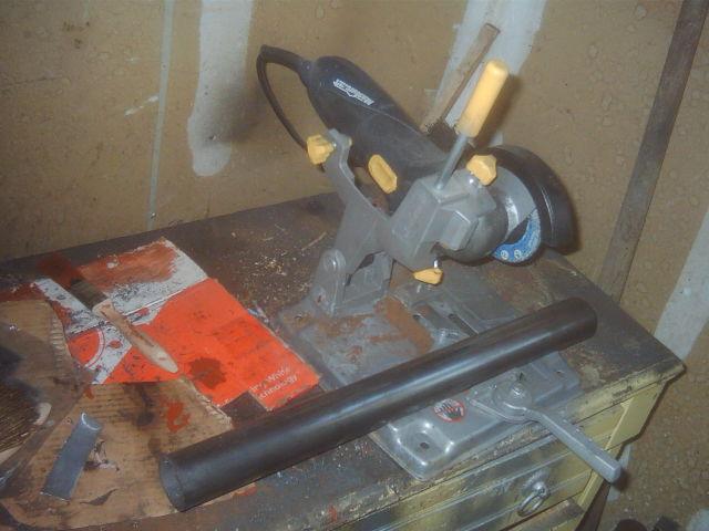

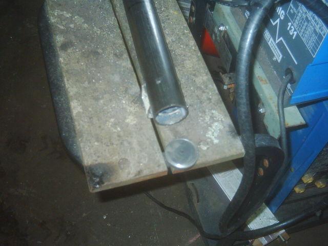

  12. Today I made the end plugs for the front crossmember using old hole saw plugs from another project and turning them in my mini lathe for a press fit in the ends of the tubing. I also drilled them through so I can thread them later for old style fricton shock. I haven't decided on the bolt size so I just gave them a pilot hole while still on the lathe. I cleaned the inside of the tubing and popped them in with a light tap of the hammer, then using my mig I tacked them in three spots and made sure they were straight. I then welded them. I quit here as I had accomplished my goal for the day successfully. This works for me as I won't get in a hurry. If this stuff seems detailed and too slow, remember every big project is just a series of tiny projects completed and put together. Set small goals for each day or week and make sure you complete them. Don't think about the end other than for planning. Just plug away on each small section till eventually the whole thing is done. I spent about 1 1/2hrs today. It was fun without being burdensome.

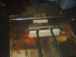

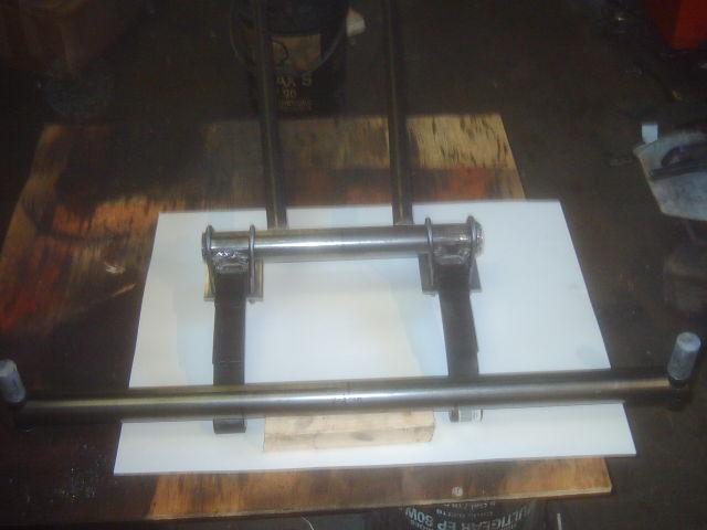

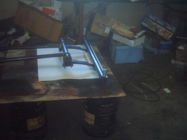

  19. While I need my wooden jig to do the build and i cant get it out by myself, the bottom rails came today. After picking them up I could not resist at least laying out the front crossmember/suspenion mount, the future front tube axle and the two new rails. When i got back to the shop Vern had left for the day but there was a note "Your "CAT" is ready to be picked up!" Cat -- JAGUAR? Obviously! Tomorrow I will have that here as well. How is a man supposed to sleep?
    Don

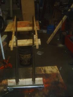

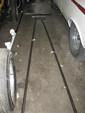

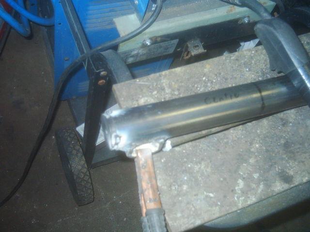

  21. Worked on the layout today for the new chassis. My old jig doesnt work for this car. Will have to make a new one. Otherwise the car will be too long. Big problem is to make the front rails close together at the front crossmsmber (about 8 inches) and yet still have enough room for the bellhousing AND STARTER (a part that often gets forgotten til it is too late) I am wanting 130 inch wheeelbase because of the extra length of the Jag engines.

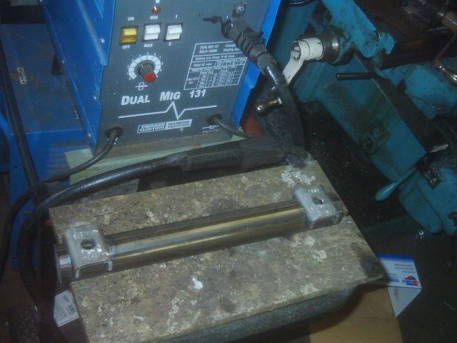

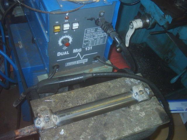

  22. The build begins. I was able to rework the old jig slightly to get it were I wanted it. Front crossmember which mounts the 1/4 eliphtic front suspension is now welded in place. Squareness has been checked before the final weld. I need to add a crossmember upstream from the front end so nothing gets bent or misaligned. After that I will make the front tube axle which is sitting in this picture with the laypout done. I intend to fab the complete axle including spindles.

  25. Not "making" ,I made it a couple of years ago. Because most cars use or are built to accomodate a V8 at some point in their life dimensions are fairly similar. Biggest bugggaboo i have dealt with is making sure there is room for a starter on a V8. Even though this is being built for a six I want to be able to put say ,a early Hemi, in it if I want as well. Also because i am wide myself I have to make sure there is enough width for me to get in and out. By building and using this jig i know those items are going to be ok. This build is a bit longer than my other cars and I wanted the narrow front end set up like the old FEDS so I had to come up with a plan. A couple of shims made from 2x4 fastened properly at the right spot on each side gave me the design I wanted and I can hold it all secure while I weld it. How do I hold the tubing in place? I thought you would never ask. With wide elastic bands.
    Wood is more stable than steel temperature wise.
    Yeah it will work . This is the third car I have built on it. I use the jig to keep eveything lined up. I know there are a hundred guys who need a surface plate and a dial indicator.
    I have an engineer friend who built telescopes.He built an aligment fixture for fine tuning the mirror from Maple. Works to a millionth of an inch he said. He taught me to use wood for things you only need for a while. The Ontario Science Centre borrowed his wooden tool too because it was more accutate than their exotic one.
    I have to come clean though. I have made parts of intake manifolds (2X4 top) from wood for testing and have run them (without problems too) as well as engine break in stands for running in Race engine that was being shipped to Europe from my shop here. Noahs Ark was made of wood. The Titanic was made of steel . And then there are the Misquito Bomber we made here during the war. All wood . Two Rolls Royce Merlins of humunguous HP hanging on them and top speed of 400+mph. Would and did accidently carry heavier bomb load the a Flying Fortess. The Cesna Crane was wood (US has a different name for it. T50 maybe?) and there was another plane whose production in Canada only was all wood fuselage. Miss Supertest was wood as were many many very very fast race boats. Even my homemade fiddles are wood. Wood is good stuff , cheap, stable and easy to correct mistakes on . I often build things in wood first to see if it will work then copy it over into metal. Anyway It works well for me. Strong cheap and stable. No good for a production shop I am sure but for a hobbyist like myself tis fine.
    Don

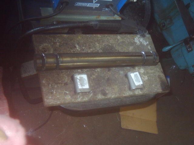

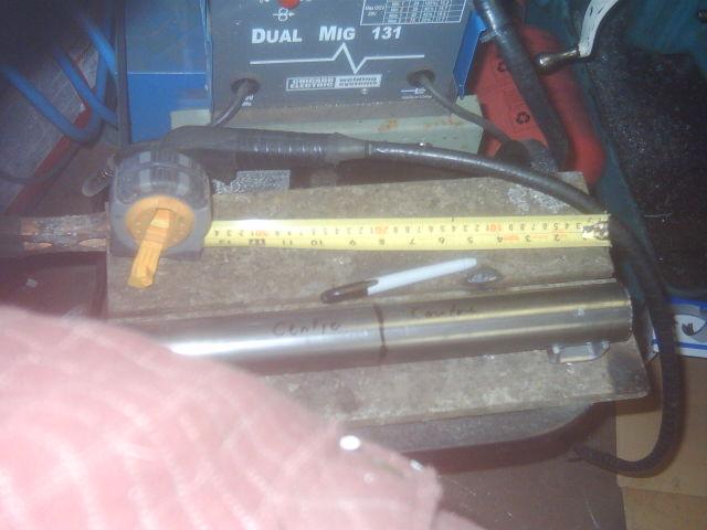

    Worked on drilling the axle tubing for the king pin bosses today. Here is the spot to spend time getting it right. The bosses will be welded in at exact right angle then the axle drop bent in giving the desired KPI. Havent tried this before but i think it will work. Mocked up the springs in paper today.

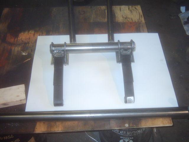

  30. Worked on the front springs today making them up from a single light duty trailer spring. Fitted it up today. I will leave them like this till the car is assembled then i can finesse the spring rate and number of leaves. I may also rework the bottom plates so they dont show. Tomorrow i will work on making the front tubular axle. As you can see I have already started.
