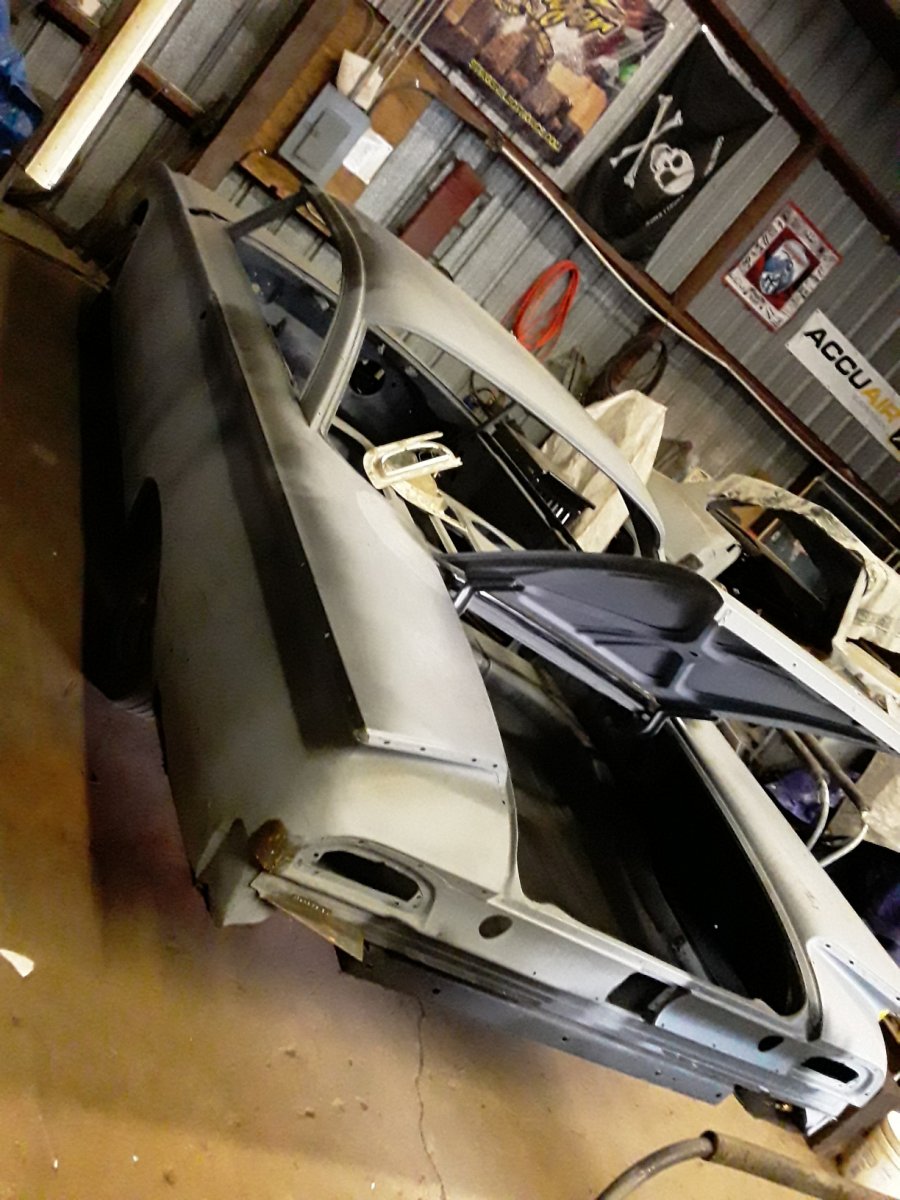

    It's been a slow build as my metal guy has been taking him time. No worries on my end as I'm not paying for storage. A few pics post blasting and some metal work.

    I wish I had more know-how and time but I'm going to leave this part up to the professionals. The shop has a great reputation and I don't want to risk messing something up. Of course I'd like to spend less but I live in an area with not many options. This shop is more than an hour away as it is.
