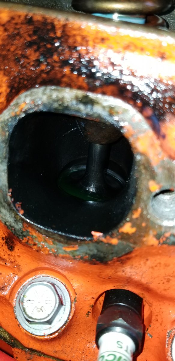

    Not the most relevant pics but ill have it apart again later and take some of the exhaust ports

    1520890847257931504617.jpg this is inside the header thought it might be of commenting value.

    15208910133241000043291.jpg this is cylinder 8

    15208910547771716633998.jpg this is 2 and 4 the other side is more of the same

    You had fair compression and you say you took a leak down test. What were the % of leak down for each cyl? Compression and bad leak down do not go together How did you do the leak down?. As stated before a engine put together properly will start on a couple turns, then will not smoke. May use a little oil over time to seat rings. You need to Know what parts were used in the rebuild. For sure what rings (oil rings for sure) Are they oil rings that need a vacumn pump. give us some pic's of the exhaust ports. DO NO RUN THIS ENGINE UNTIL YOU FIND WHAT IS WRONG.

    You have a oil ring problem. IMO I thing you have low pressure rings or who ever put the rings (oil) on over lapped the expander spring . Take it apart and prove me right or wrong. Guilds or valve seals won't cause that much oil in the exhuste ports .Hope You find the problem
