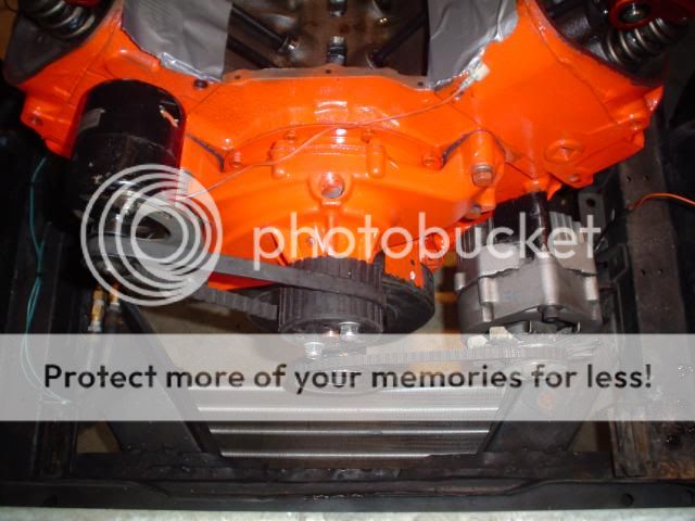

    Cam and valve train installed.
    Front accessories installed.
    Radiator clears OK.
