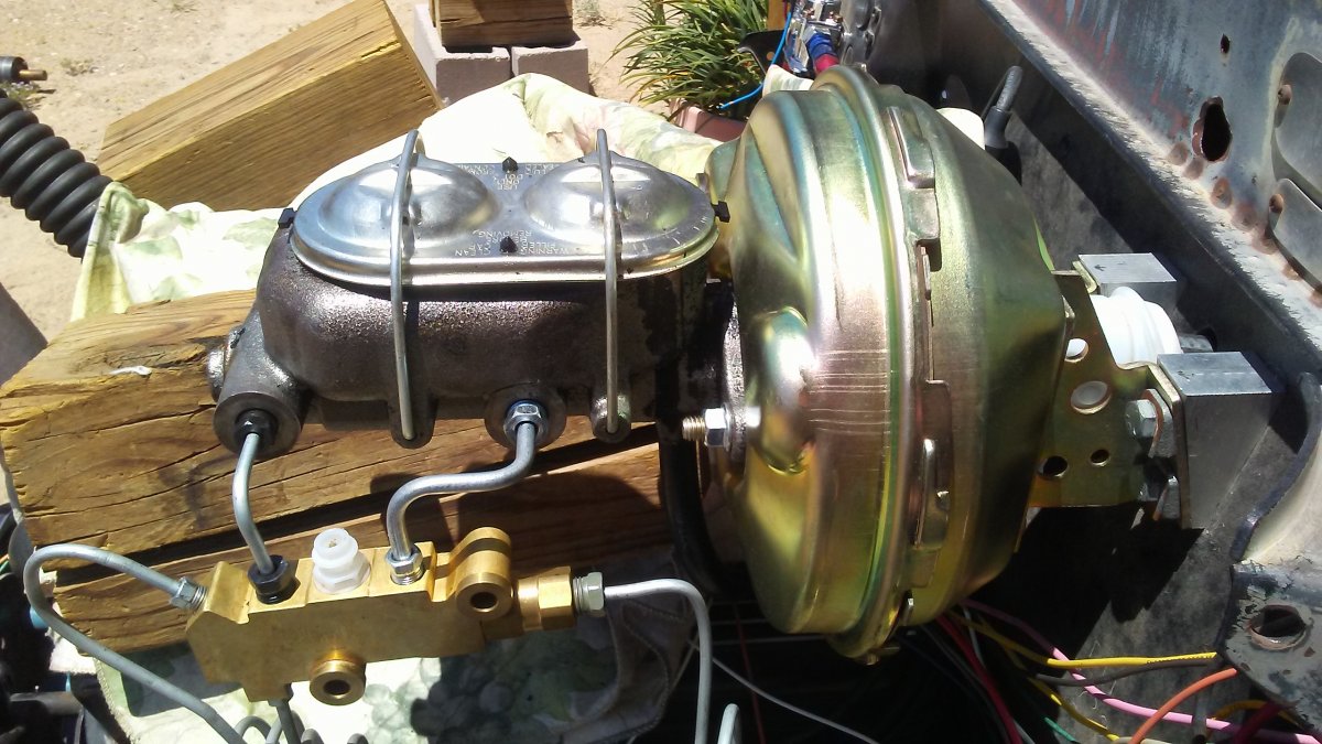

    Ok, working on the brake system, 4 way disk brakes, right stuff proportional valve, Cardone master cylinder and power booster.Made my own lines leaked all over, took lines off and had a shop do all the flaring- no more leaks. Bench bled the master cylinder, hooked lines up, pump the pedal and have fluid at all the bleeder valves. I open the valves and some air came out, (not as much as i thought for a dry system) and then only get fluid. I started at the rear passenger side, rear drivers side, front passenger side and then the front drivers side. I get NO pressure build up. I made the brake pedal for this car - the rod to the master cylinder moves about 3/4". Is this enough, redo pedal get more stroke, is my proportional valve bad, master cylinder bad, don't know really what to tackle next.
    Thanks for help.

    Way too short a stroke.

    May sure your pedal will bottom out the master cylinder and also have clearance when it is in the up position. Easiest way I know to get it right.

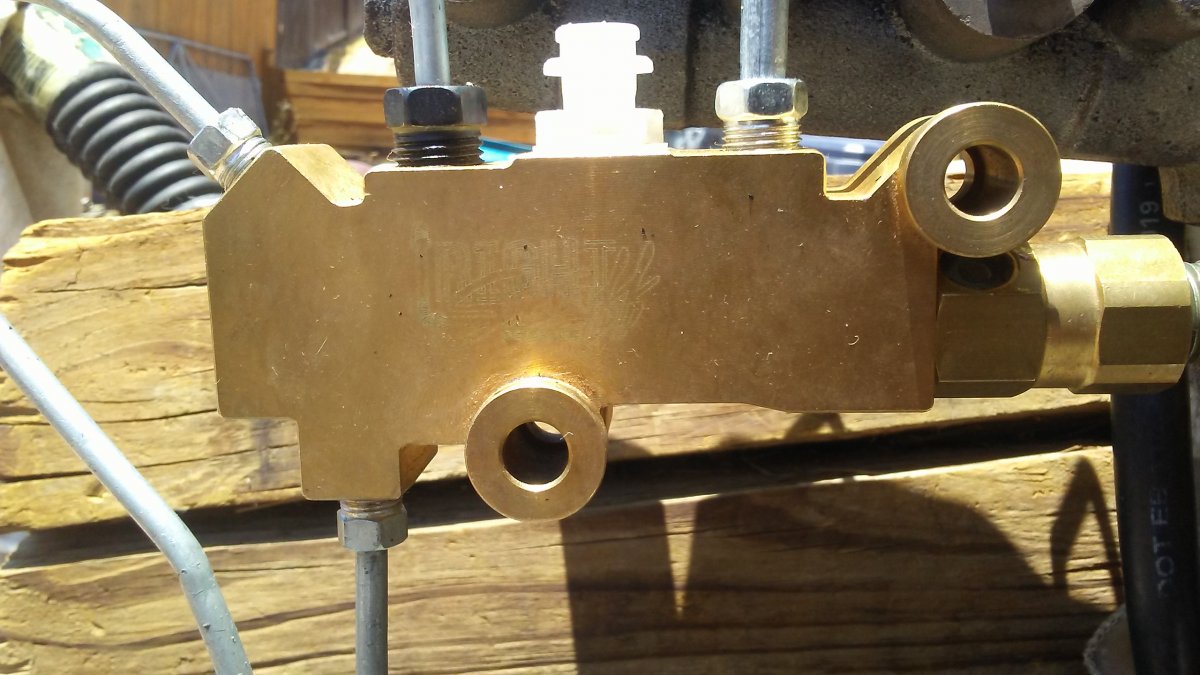

    I hate those damned proportional valves. They have caused me lots of problems. The spool will shift to block off flow to the side that does not have pressure......and once it shifts, good luck getting it back "to center". This tool should be installed BEFORE you start to pump the pedals. https://www.summitracing.com/parts/clp-pv-tool
    Also, you must get the pedal lever ratio right and it sounds like you are a little short on that.

    If the isolation valve has moved forward, take out the metering valve from the front, and push the isolation valve back to center. Reinstall the metering valve.
    If the isolation valve has moved rearward, take out the proportioning valve from the rear (the big thing sticking out the back, where the rear brake line attaches), and push the isolation valve back to center. Reinstall the proportioning valve.
    In both cases, you can verify that the isolation valve is centered, by checking for continuity across the terminals of the brake failure warning switch. If you have continuity, it is not centered. Moving it off-center completes the circuit that would be used for a brake failure warning light, were one installed. When it is centered, that circuit is broken.
    I have used both of these procedures on several cars, never had an issue, and was done in minutes. It takes longer to put down protective coverings and sorbents to protect the paint, than it does to do this.

    I corrected the brake pedal travel, got the tool that holds the proportional valve in its center position. I see the spool moving when the pedal is moved. When the pedal is released the rear reservoir bottom port pushes fluid up about 3/4" , front reservoir doesn't do that. I pump the brakes, open the bleeder valve and fluid squirts out in the rear. In the front fluid comes out but doesn't seem to be as much pressure as in the back (nothing substantial). I get no air when i open the bleeder valves. I get NO pressure build up in the pedal, i don't know what to do next.

    In looking at pics 3 and 4 I couldn't tell if you had a vacuum hose on or not. About 5 years ago I was bleeding new set up on my 32 and made the mistake of having the new booster vacuum nipple capped off! Couldn't get a bleed until uncapped it!
