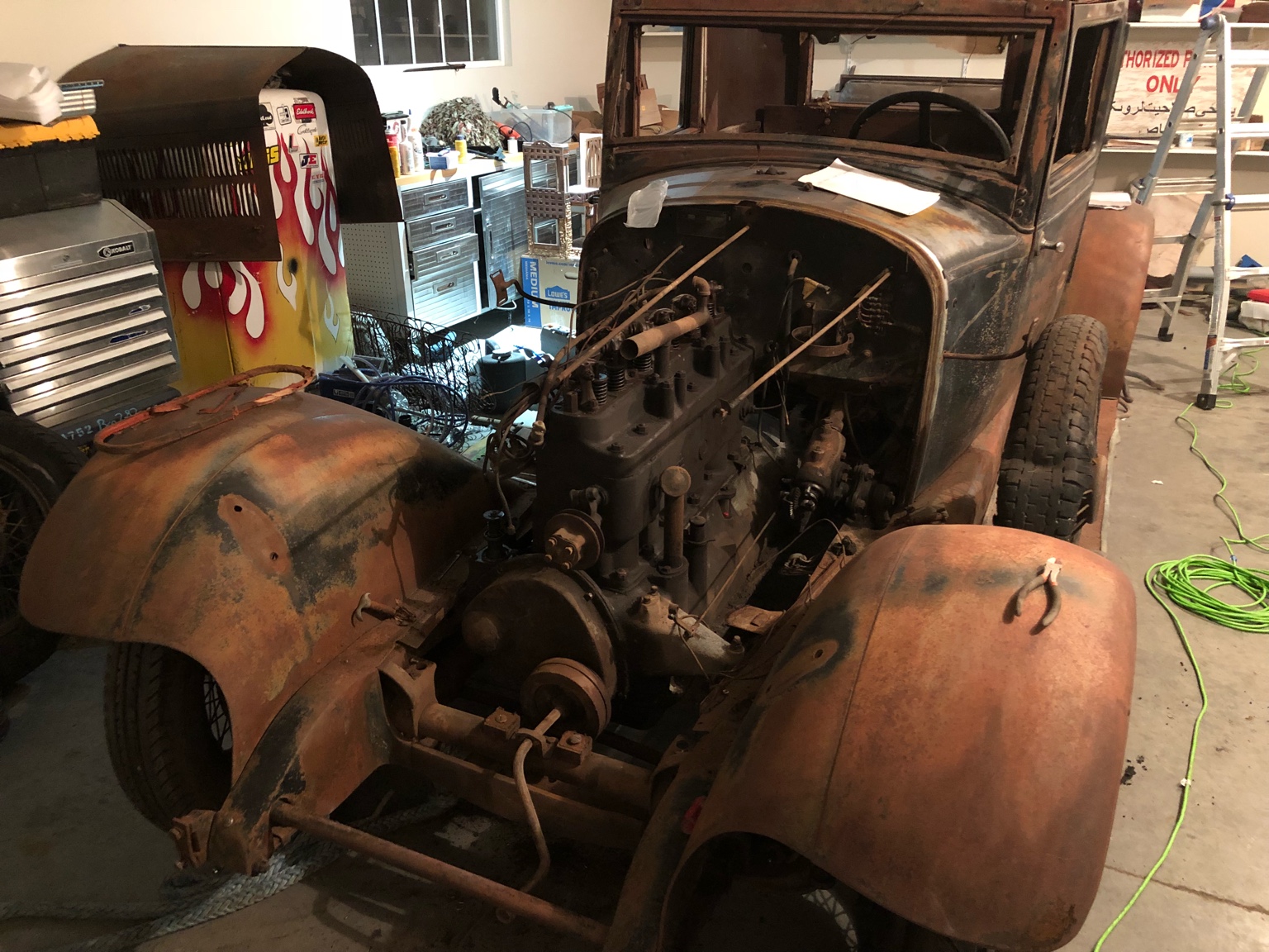

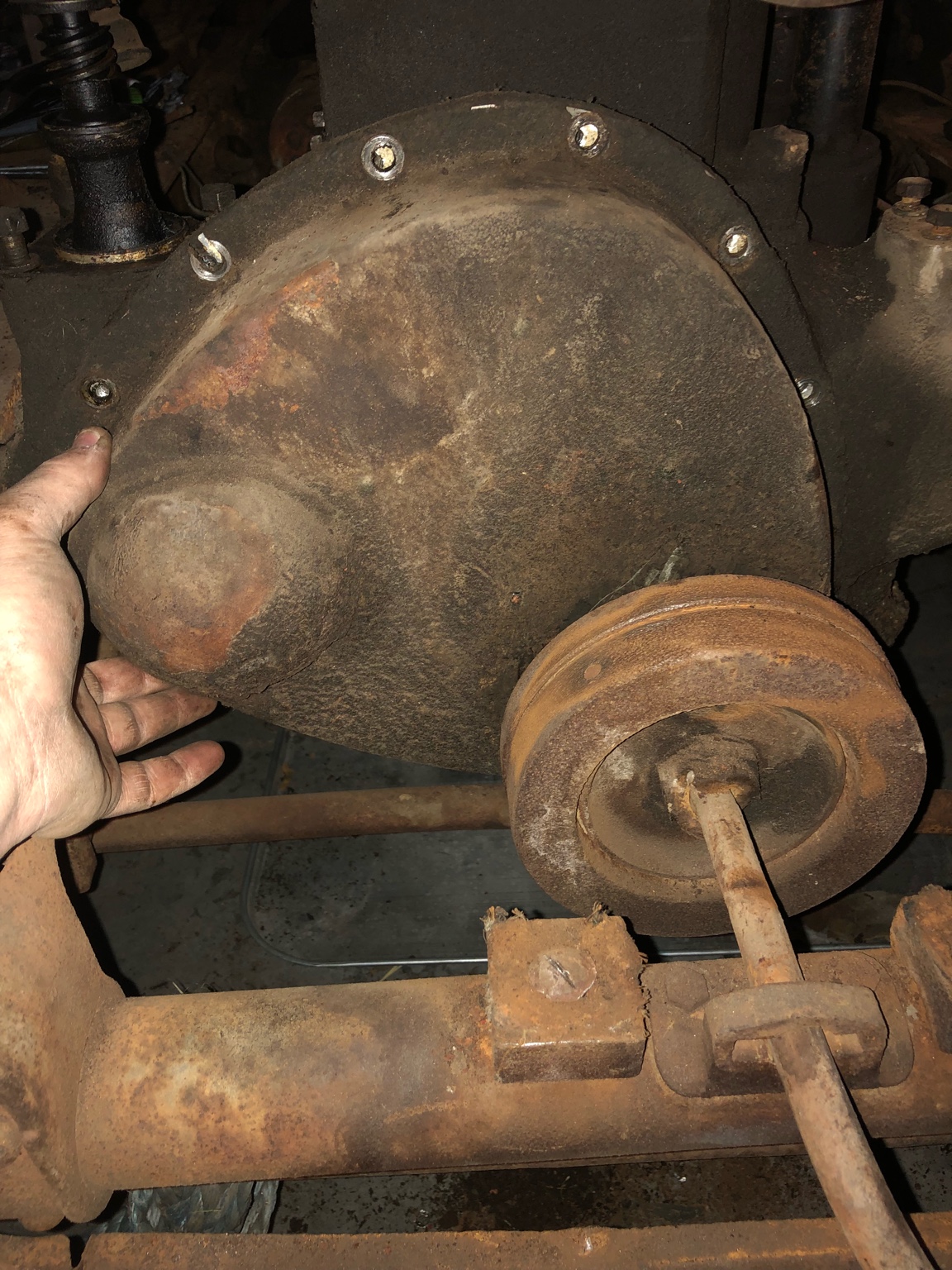

    Well I’m all moved and at this house I have a garage, though I still wish it were bigger it’s a two car (wide) and over deep it’s been challenging to set it up on paper, the other issue is the 10’ ceiling and manufactured “W” trusses which won’t allow me a standard lift unless placed awkwardly in the mid of the garage. I started taking the Hudson apart everything looks great but no luck turning it over (yes it’s in neutral) I was told the timing chain can get stiff or rust making it impossible to turn but when I peaked behind the cover it looks brand spanking new! Behind both inspection plates and the valve cover makes her look like a runner! The water pump shaft is pitted but it’s disconnected so I know that can’t be the issue, otherwise I’d have some play.... I think I need to get the front crank/fan belt wheel off, it looks like that’s a job for one hell of a spanner wrench a size of which I can’t find... Any tips for removal or other ideas??? I’m waiting on a lift before dropping the pan as it’s only about 6-8 inches off the ground.

  30. You should take out the plugs and get some penetrating oil in the cylinders and let er sit several days then try rocking er back and forth. Put it in reverse and rock the whole car a little. Google a sesrch for staring old or stuck enginrs. Valves could be stuck too. And lifters. Looks like fun
