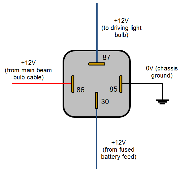

    I've spent the last fifteen minutes looking for real info on it from a number of sources and what I primarily find is that BS artists try to out BS each each other about it.
    Simply put you are switching the ground side of the relay rather than with 12 V from the switch.
    What we know as a normal positive switched relay in the top image with power from the switch going to the 86 pin.
    The lower image showing the Negative switched relay with the switch between the relay and the ground on the 85 connector and the 86 wire hardwired to the relay rather than switched.
    To me this would be a real pain in the ass for anyone who followed behind you and had to trouble shoot the wiring including any mechanic you have work on it. It goes backwards of normal systems and normal trouble shooting procedures.
    Personally I just don't see the point of doing it just to be doing it.
    Some systems such as a temperature controlled fan on the radiator are negative switched because the temp switch grounds the relay.

    @Mr48chev , Thank you for the diagrams and your input, I'm starting to feel confident enough to wire up the headlights/relays.
