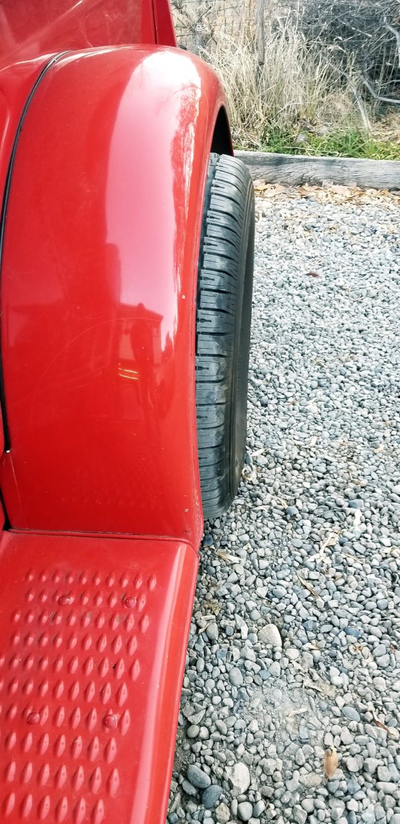

    So I picked up this little honey not too long ago....but she's in dire need of wheels and tires.
    Not only are the wheels dated, but the tires are crazy old as well.
    See how they stick out past the rear wheel wells? Yeah - that drives me nuts. I can't stand it.
    Any ideas on where to go from here? Fronts are a different size than the rears, for what it's worth.

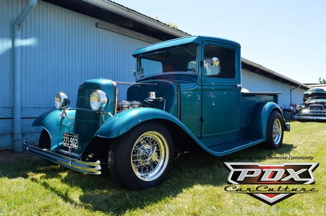

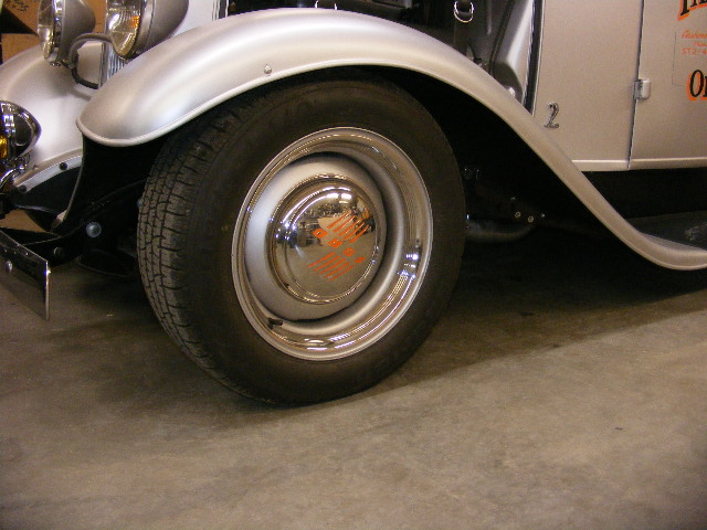

    I really love this truck - belonged to a member here....but I can't recall exactly who's it was.
    That simple wheel with chrome centers and trim rings looks so clean to me. I dig it. Something like that would really make a nice improvement, in my opinion....

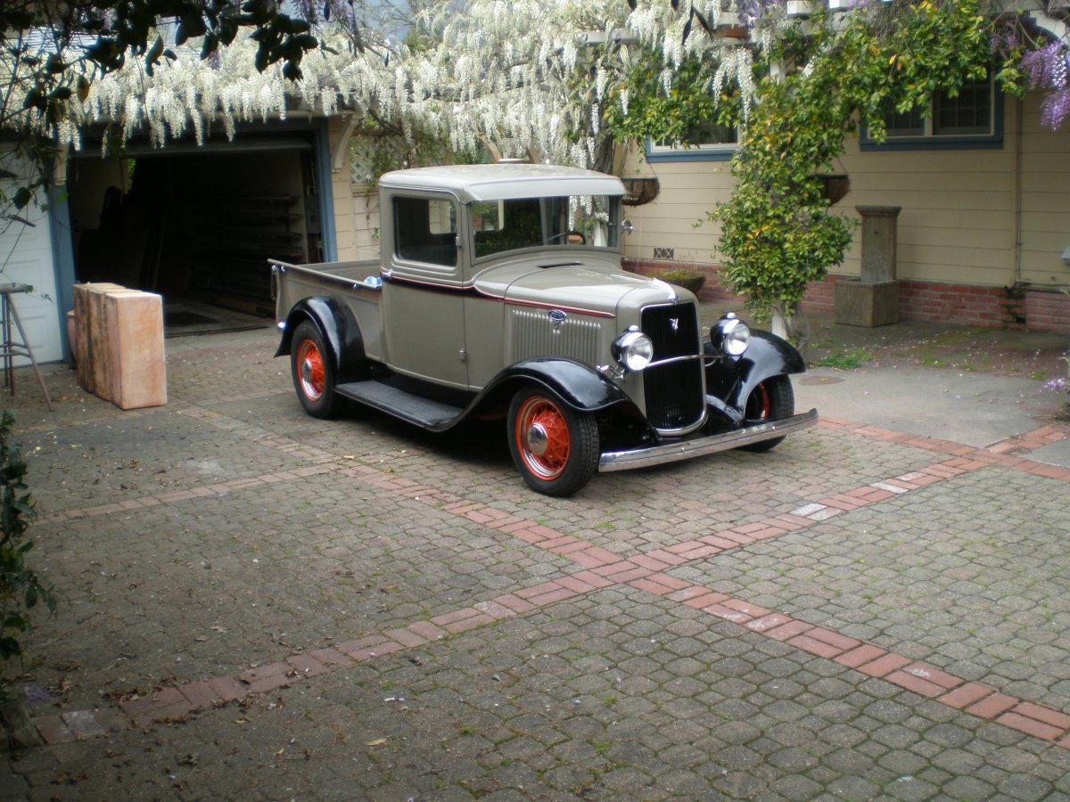

    I ent with Excelsior Stahl Radials on mine. It completely changed the look of the truck. P4080018.jpeg

    If you have 5 on 5-1/2 lug pattern a look similar to that truck that Vintage_MPG posted could be done with some 15 inch Ford pickup steelies and caps. with or without rings. It might take finding the hubcaps you want to run and then find wheels that match the cap and fit the truck .

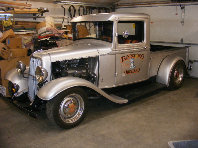

    First step is to measure the rear end WMS to WMS. The wheels you have look like the same size all the way around. Probably 7" wide and 3 3/4" BS. Still they stick out waaaay to far. Normally you would only see wheels sticking out like that if they are reversed. That axle may be too wide for the truck.

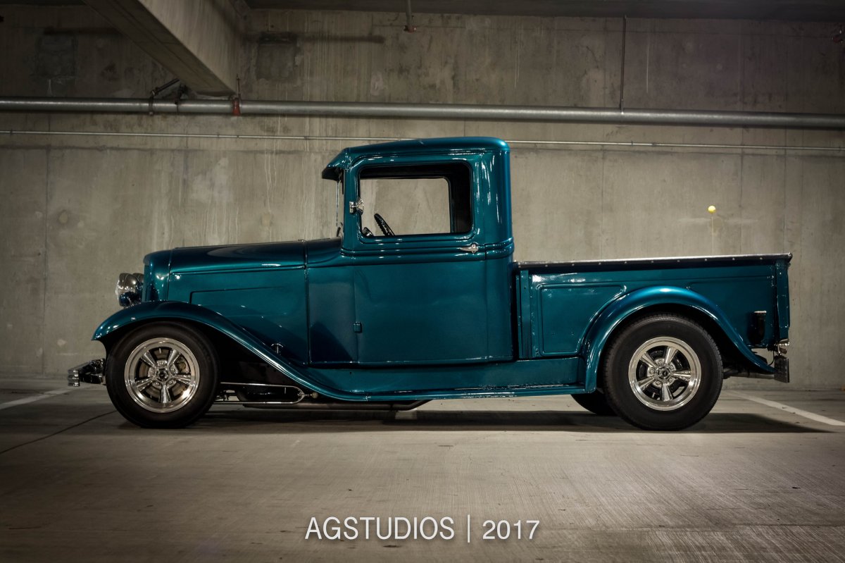

  10. I have 15x7's with 4 1/2" backspacing all the way around on my 33. rear end is a stock width 68 Camaro 12 bolt
    38174815162_0728c3a791_k.jpg 38174816822_2bedcef74d_k.jpg 38174820922_2893630435_h.jpg

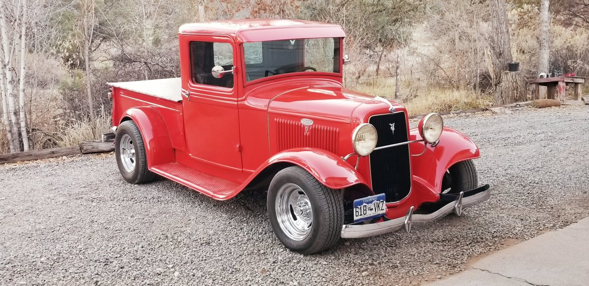

    Front P205/60/15 6" wheels
    Rears P255/70/15 8" wheels

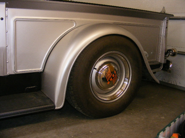

  13. I like the steelies. HRP
    my pal Dave like the chrome reverse.
    and my pal Steve's pickup.
    HRP

    This is it. This is what I'm after.....I love that simple look, with just the right touch of chrome.
    Now to get that rear end measured. The rear end my very well be way too wide. Not really sure. I know the wheels don't match as far as bolt pattern is concerned; the fronts look to be 5 x 4.75 and the rears are 5 x 5.5. Not sure why that's the case, but it is what it is. The rears are huge - carrying some serious meats. I don't want that much tire at this point, so I'm more that willing to slice some off. Hopefully I can massage it into place with wheel and backspacing - not swapping rear ends.

    So it only took me two weeks to get the numbers on this rear axle.....but I've finally got some hard figures!
    The WMS to WMS is 61.5" total.
    The wheels are 15" all the way around, but the rears are wider - with a different bolt pattern as well. The rear tires are 275s, so they're big and wide. Too wide for my taste. Fronts aren't quite so bad - but still a bit much, in my opinion.
    What does that tell me? Now that I know my WMS to WMS digits, where do I need to go from here?
