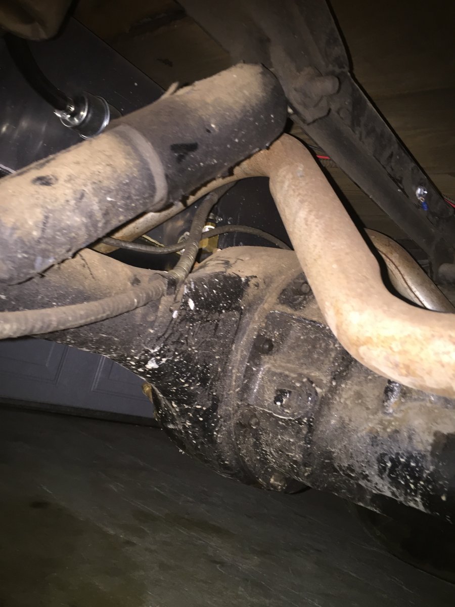

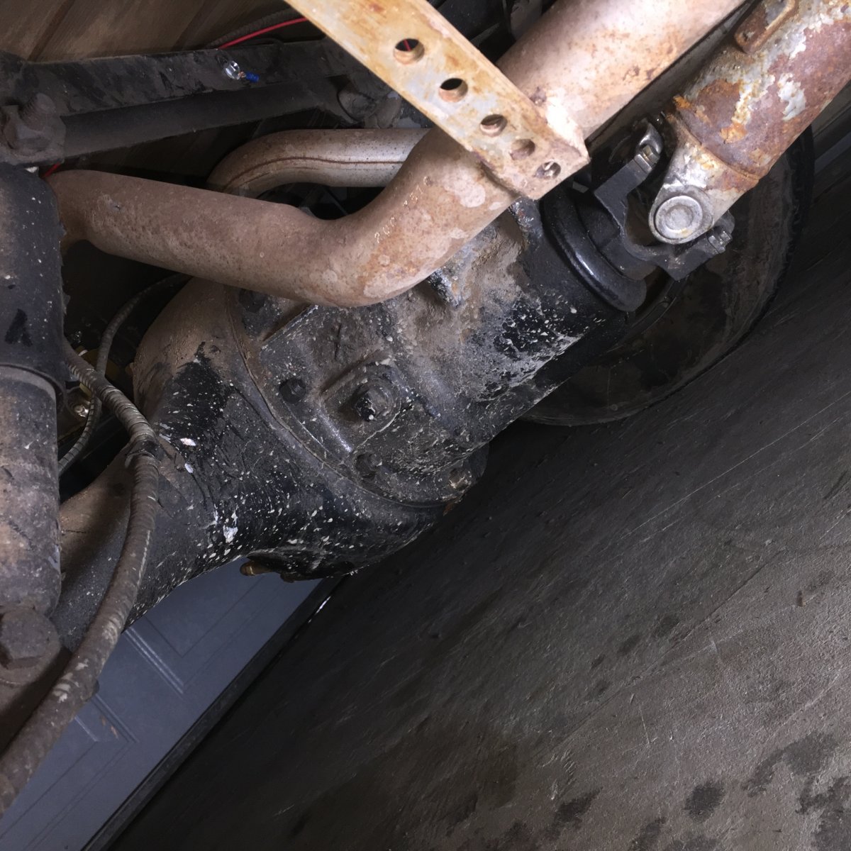

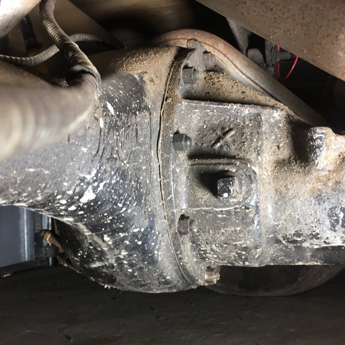

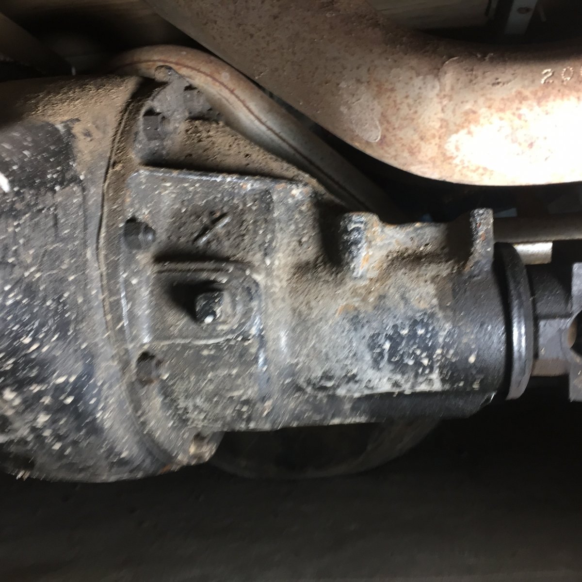

    Sorry for delay, just getting back to car location. Here’s the additional pic’s from drive shaft side. Looks similar to a ford 9” don’t recognize the X on right side? What is it?

    I believe that's an 8-3/4 Mopar. The 'X' denotes that it is the '741' type.

    9 inch ford you can't get a socket on the bottom bolt
  27. Not Ford at all, 8 or 9". Could be 8 3/4" crashler as suggested above.

    Count turns to figure out the ratio. It's a MOPAR just because of the pinion snubber mounting holes.
