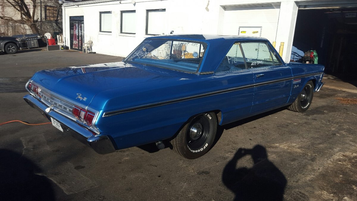

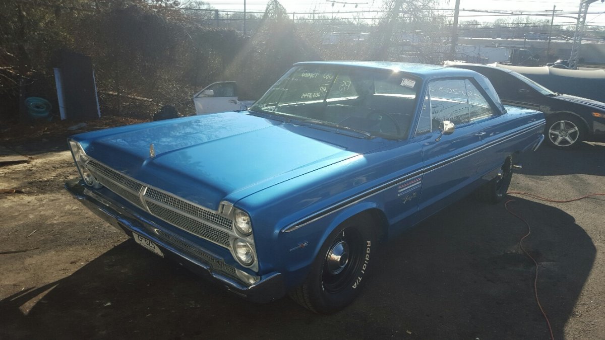

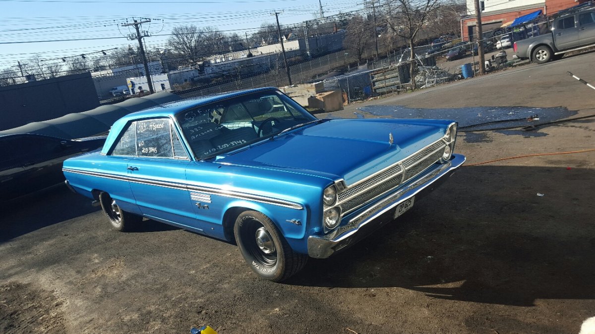

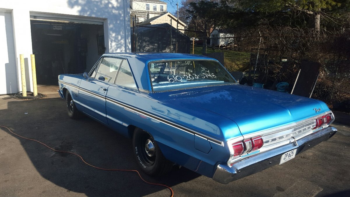

  27. Barsteel
    Joined: Oct 15, 2008
    Posts: 726
    Barsteel
    from Monroe, CT
    For anyone who cares, here are some pics of the car.
    It's got a freshly rebuilt A833 4spd (with receipt), and the rear end doesn't make any funny noises or have any leaks, so I can only assume it's in good shape. The car has a 95% rust free AZ body, and it's very clean underneath. I bought it how you see it. The PO completely stripped it, painted it, dressed up the (shot) motor, did brakes, lines, and a ton of small stuff. When I got it, someone had slapped a new interior in it, but the windows were falling out of their channels, channel flocking was shot, window regulators were super stiff, there was no interior chrome installed, there were no fuzzies, no headliner, no windlace, half of the exterior chrome was in the trunk, and none of the gauges or interior lights worked. All that is fixed now.
    All it needs is a motor...
    Chris
    warbird1 and saltflats like this.
  28. falcongeorge
    Joined: Aug 26, 2010
    Posts: 18,341
    falcongeorge
    from BC
    NICE^^ buddy of mine had one of those when we were teenagers, nice car.
