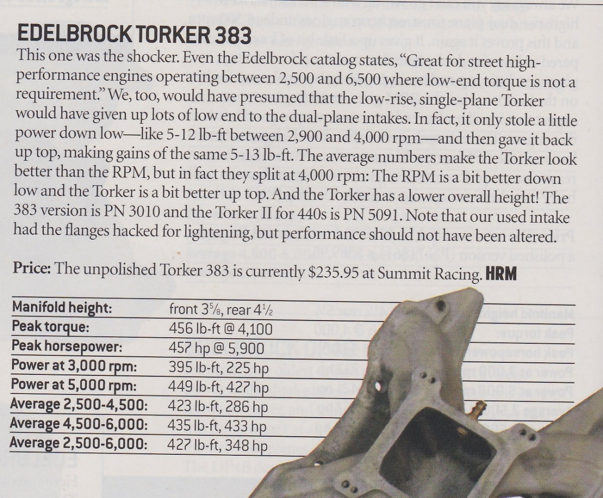

    Yes, you definitely need to get rid of that out-dated POS torker and spend $300 on a nice, shiny, new, Car Craft approved Performer RPM...

    Well and whats REALLY funny is the content of the text vs the actual numbers. 1 ft lb difference (which is well within the margin of error for dyno testing) in the average numbers between 2500-4500, yet they tell you in the text that the RPM is "better" down low. Talk about spin!
    Reality is, theres no difference, and if you spent $300 replacing your 30 yr old torker with an RPM, you would not feel ANY difference. NIL, NOTHING, NADA, ZIP.
    Yet virtually everyone (well, not you or I, but pretty much everyone else) has been telling this guy he "needs to get a dual plane".
    Man, and to think they busted Alan Freed for taking money to play records!!!
