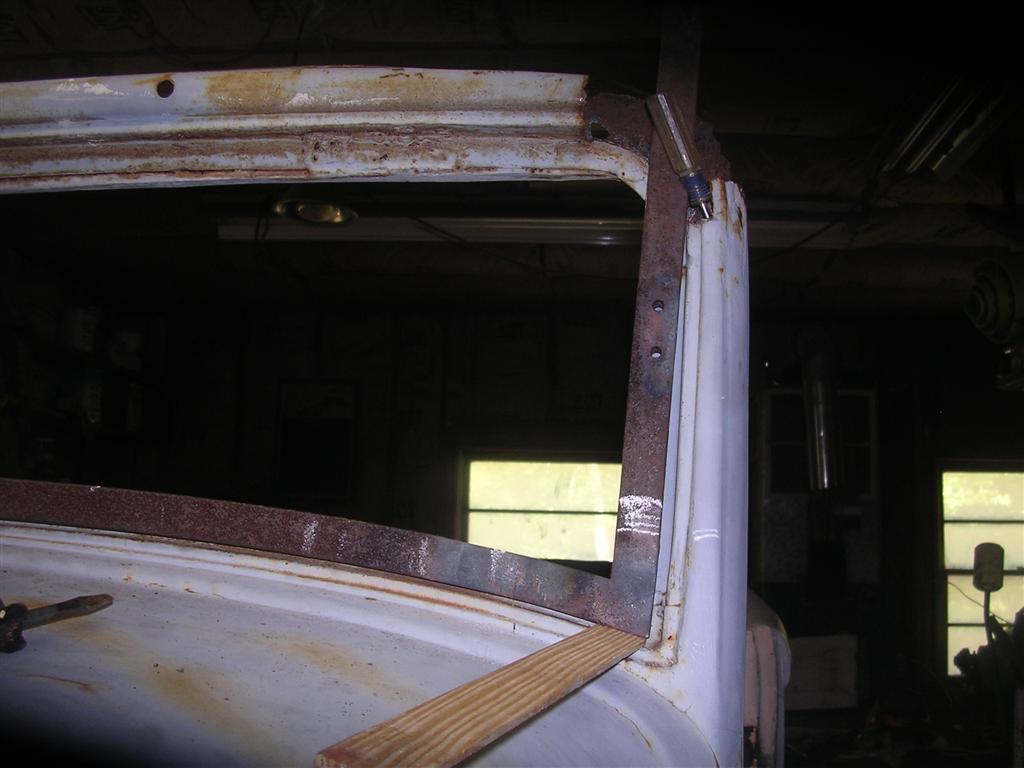

  5. cpd682
    Joined: Oct 8, 2012
    Posts: 38
    cpd682
    from DFW, Texas
    This is from a four door if it helps.

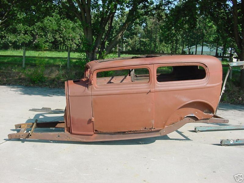

    here is a poor pic of a hacked up 5w, without a roof.
    They welded a plate to fill in the pocket for each winshield hinge...but you can see how the flange hanging down, is supported by the inner piece shown on the 4 door in post 5.
    sorry, the pic I saved of a 2 door side view has the doors still on. So it won't help the side problem.

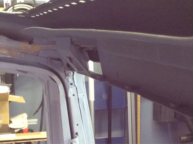

  9. cpd682
    Joined: Oct 8, 2012
    Posts: 38
    cpd682
    from DFW, Texas
    Is this closer?

  10. walker
    Joined: Dec 29, 2008
    Posts: 235
    walker
    Perfect on the windshield opening. Thanks!
    My 32 door opening is a little different, but that is the exact area.
