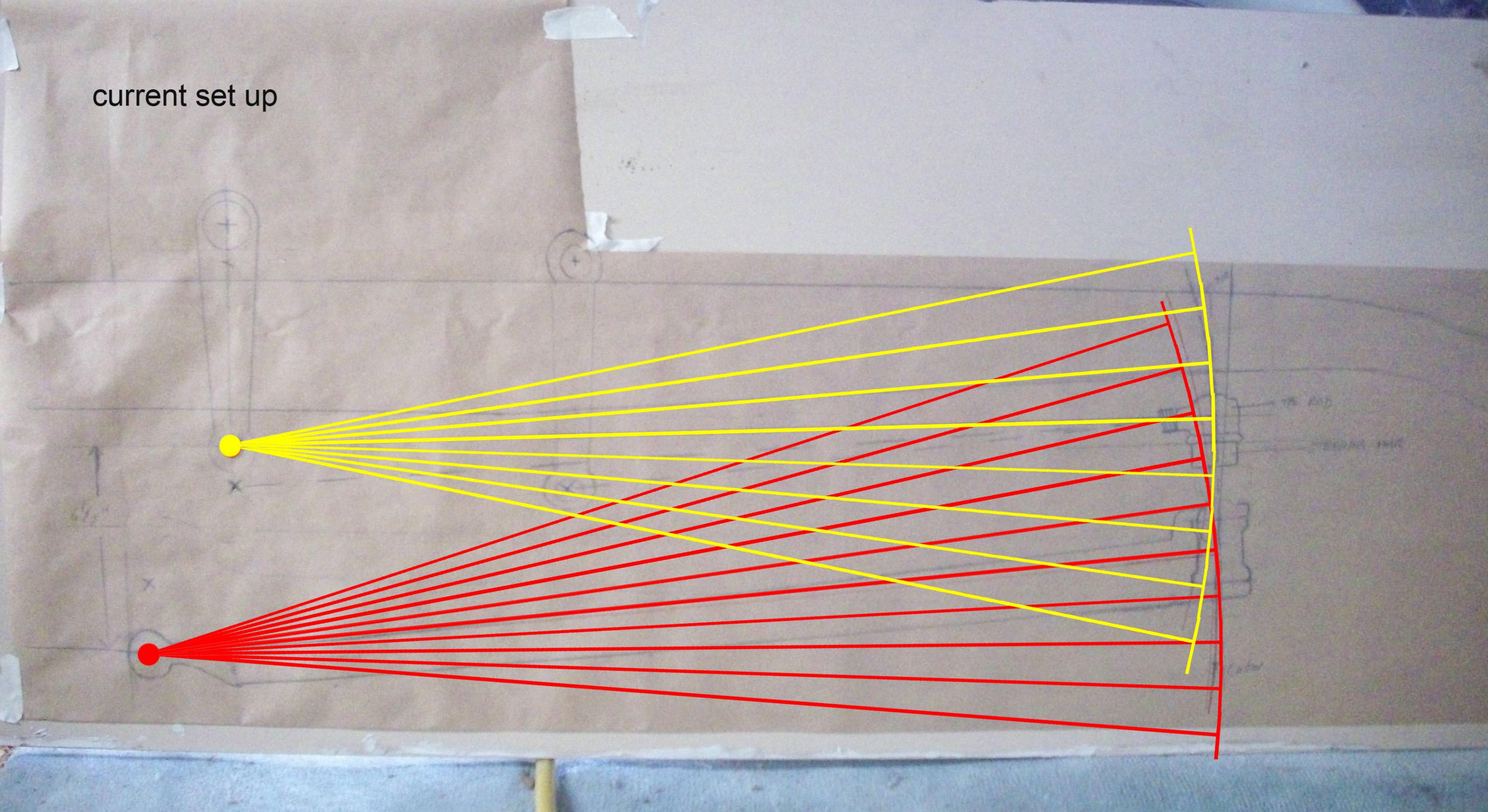

    I hope these are enough to put us on the same page... i can move the pitman arm down and forward slightly as per the yellow line but i dont know that is enough or makes any real difference.

    Just my opinion Aussie... Your set up will work OK with virtually no noticable bump steer. It is very similar to mine except I am running split bones, so I can say that from first hand experience.
    However it is not the ideal set up as you clearly understand. So it might come down to what you need to do in order to satisfy those who must be satisfied

    Ideally, the steering arm should end as close to the 'bone pivot point as possible. With a wishbone attached solidly to the axle, not a parallel four-link, the steering link being parallel to it makes no difference. All that affects bump steer is the vertical distance from the pivot point to the rear end of the steering link, in your case, maybe 3".
    When the axle moves up and down a few inches, it's only going to affect the steering about 10% as much if the bones are 30" long. That ain't much.
    The ball socket on my "A" frame is about 4" below the rails, and it is a few inches lower than stock with a non-dropped axle, reversed spring eyes, and modified front X member.

    your photo (first one) with the coloured lines introduces some parallax error to your arc calculations. With the wheels straight ahead the ball joint on the steering arm will be in line with the spindle axis. Having the ball on the pittman arm 3" ahead of the wishbone ball tightens the arc of the drag link a little but they should still be close enough to not cause any problems. Actually tightening the arc will probably help as the axle will be moving back due to the low mount on the back of the wishbone. I presume that the RTB won't let you cut the wishbone near the axle and move the rear pivot point up closer to the chassis.
    The best way to figure out the arcs is to make a stick model of the various parts and cycle it through the expected travel. We used to use icy pole (popsicle) sticks to work out four link geometry on drag cars back in the 70's. Now I use high end software but the stick version is lots cheaper.

    Rooman, off to play with sticks...photoshopping a photo didnt really work out too accurate did it?

    well david, i never thought of that! I will go to shed and look...
    carcrazyjohn, thanks for the vote of confidence.
    as Rooman pointed out, my pics may not show it the best so i have done some more accurate ones. I did a 1:1 full scale drawing and set to work with string lines and the computer.
    what do you think. better or worse!?
