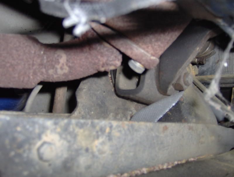

    My 34 has a later 59AB in it, its a real tight squeeze, heres some Pics I just took, Don't say I never gave ya nothin" :D. Sorry its all grody lookin', I haven't been workin' on it in awhile. the measurements will have to wait till tommorrow. On a side note, this swap was done in the 60's by a friend of mine and is still unchanged, right down to the crappy engine mount spacers. In order to squeze it in front of the 39 gearbox, the front crank pulley was machined off, and the generator mounted fan was used.
    ENGINE MOUNTS IN RELATION TO RADIATOR ON CROSSMEMBER
    A CLOSER LOOK
    ENGINE MOUNT SPACER
    ENGINE IN RELATION TO RADIATOR WITH FAN
    Hope those help
    Drew

    hey drew thats awesome, thanks heaps for the photos!
    im running a 5speed Toyota box in this (sorry!) so gearbox position isnt a limiting factor..
    damn that is tight at the front, theres no way a twin belt pulley would fit in there!
    how tight are you at the back of the engine to firewall? that would give me enough info to go on i think.
    the radiator hoses look about 3/4" above the xmember..is that about right?

    Those "crappy engine mount spacers" are actually a cool old hot rod trick. They are factory motor mount brackets from a '49-'50 Merc that the hot rodders decided they could use to put a later flathead in the '33-'34 Fords instead of buying the spacers offered by the factory. They are functional and vintage parts, not that easy to find. Enjoy them.

    Heres the other pics you asked about. It's pretty tight againt the firewall, with just enough room the get the oil filler cap on(not an issue with an 8BA). The vertical surface of the block just below the head is right about and inch and a half from the lip at the bottom of the firewall, I had to use a straight edge becase the block sits below the actual firewall, the toeboard slants back. Anyway here are the pics.
    Hope this helps, let me know if theres anything else.
    Drew
