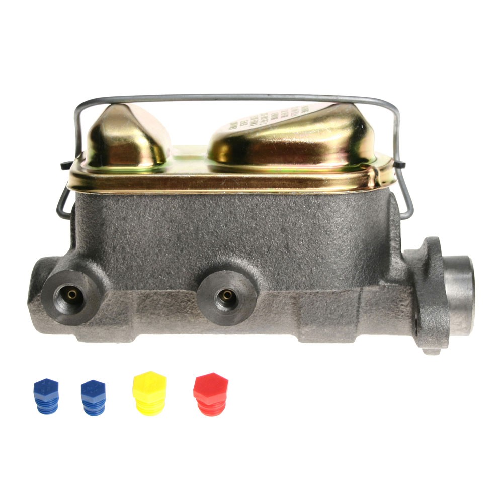

    Can anyone help in identifying this master cylinder? Was on the chassis (Model A Ford)when I bought it, it's now leaking and would like to go back with the same thing but having trouble finding out just what it is. Numbers stamped on it are 257-30 or 257-3D. Thanks in advance!

    It looks like your basic mid-70's Ford disc-drum dual master cylinder.

    I would agree with chessterd5 this is a picture of a Early 70s Master Cylinder for a Ford Torino. Joe bmc23_1_5.jpg

    I bought one that looks very similar to that about a month ago. It was for a 1969 Mustang 4 wheel drum brake system, no discs. Chances are good most of the Ford products from around that time period will have a master cylinder that is very similar. Just make sure that if your A is all drum brakes the replacement master cylinder is for drum brakes as well.

    69 Mustang worked fine. Thanks guys.
