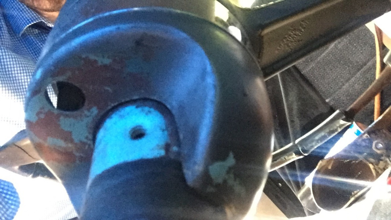

  8. StukaBomber55
    Joined: Jul 26, 2012
    Posts: 115
    StukaBomber55
    Pics as promised guys. I tried again with the horn button with no luck. Sprayed it with penetrating oil and will try again tomorrow.
    Here are pics as promised. Thanks for chiming in everyone!

  9. Hnstray
    Joined: Aug 23, 2009
    Posts: 12,355
    Hnstray
    from Quincy, IL
    Okay, that is little different than I pictured in my mind. I think the chrome 'cap' or 'bezel', the thing with the emblem in it, will pop off with a little prying at the seam with a putty knife or similar. That most likely has a spring around it's circumference, similar to wheel trim ring spring tabs. If that gets it to release, you will find inside the screws that hold the horn ring itself to the steering wheel, along with horn contacts, etc.
    Ray
  10. Sorry here's some pic's of one I have in storage - like Ray said you need to pluck that small center cap off and there will be three phillips screw holding the large chrome horn 20180831_173335.jpg 20180831_173346.jpg 20180831_174031.jpg ring on the wheel. You can see the three holes on my steering wheel. Best I can do with my eyes was about 39 splines....the piece you see with the two screws should be holding down the large chrome ring....I usually put them back on.....Mopar used this style way up into the seventies

  12. StukaBomber55
    Posts: 115
    StukaBomber55
    You guys are awesome! Thank you! Just got around to pulling the wheel. It’s been 110 here between monsoon downpours. The center cap popped off with a butter knife. No turning require. They three Phillips heads holding the horn ring on. They needed a bfh wack to break them loose. Check out the condition inside the wheel though. Both of my spikes were cracked through as was the entire hub itself. Not very safe at all. Glad I found this. I need a wheel puller but will count the splines tomorrow to verify 39. Thanks!
