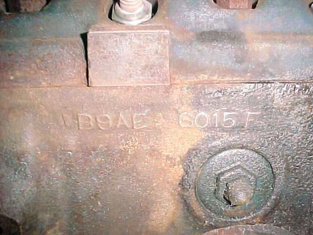

  1. Can anybody help me out decoding the numbers on my 312? B98E-6015F. I checked a few sites on the web & so far all I got was the B=1950's which I already knew.Any help would be appreciated.

    9=1959 (first year, but maybe not the only year, that this block casting was used)
    I think that the "8" is wrong. Should be a letter there indicating the car line. Double check it. Probably an "A" which = full size.
    E=engineering
    F=6th engineering design revision

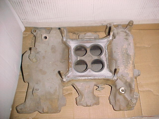

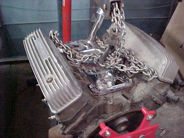

  10. B9AE-6015 is correct. Intake is ECZ-9425-B. Heads are 6090B.Here's a few photos.Thanks for all the help.:cool:

    Definitely a Y-block, and not an FE.

    That block code is correct for both a 292 and a 312. I think that if it has ECZ casting numbers on the maincaps, then it is a 312. A 312 will have a 3.80 bore size. A 292 will have a 3.75 bore size.
  13. Also, the mains on a 312 are larger, so get a main journal size and I can tell you exactly what you have.

    Chris is correct, and in this case, the F indicates that it was a block casting that was used for both the 292 and the 312. The difference is in the machining.

    Maybe B9AE 6015-F? This is a 59 or 60. S (B=50, 9 = 9) 292 or 312. Both years used the same casting #. If it came out of a Ford, its a 292 - If out of a Mercury its a 312. The only way to tell if a 312 or 292 is if the 312 main caps have a ECZ casting number. Another way - the 312 rear crank flange has a 3/8 or so raised dot.

    ECZ numbers were only used in 56 and 57. B9=59, F indicates either a 292 or 312.
