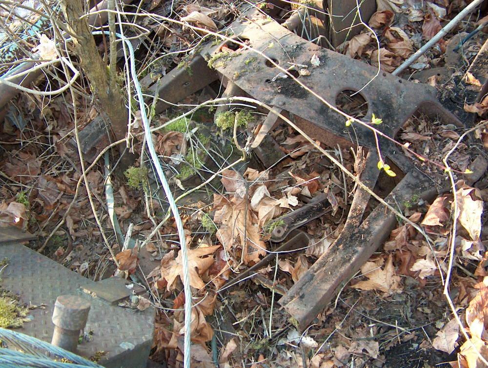

    i have no idea where NOLA is, the frame in my pic has been sitting there for 20 years or more even, i would just tack things togather and see how things line up, heres the other end of my frame.

    so i went out and double checked my frame, and its 35-3/4" at the bumper bolt locations, but its 35-5/8" at the very front.
