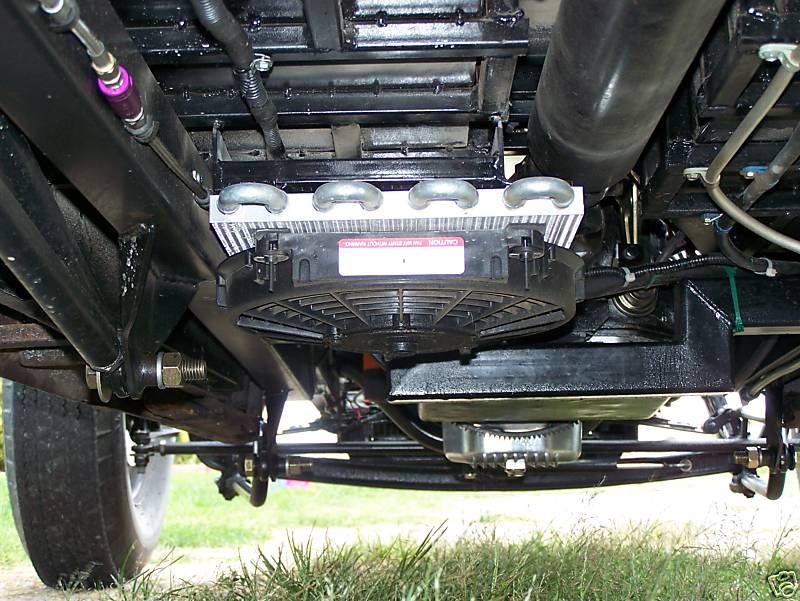

    I am looking for some pics of floor plans. Especially looking for pictures of the front ( covering the trans, and around the pedals) this is my first time ever doing a floor, and am looking for some pointers. Here is some pics of where I am at now...
    I really appreciate any pics, or pointers. Thanks a lot!

    Here are some pics on my old sedan,hope it helps.Nothing fancy.If your car has the subrails still in,there is a 90 degree notch that runs along the inside.You can take some thin guage 2x4 square tubing,and run it the whole lengh of the subrail,weld it top,and bottom,and run your side to side runners for your floor,off that.I used 3/4 square tubing for that,ends up being about a 3'' channel.Maybe you can tell from my pics.
