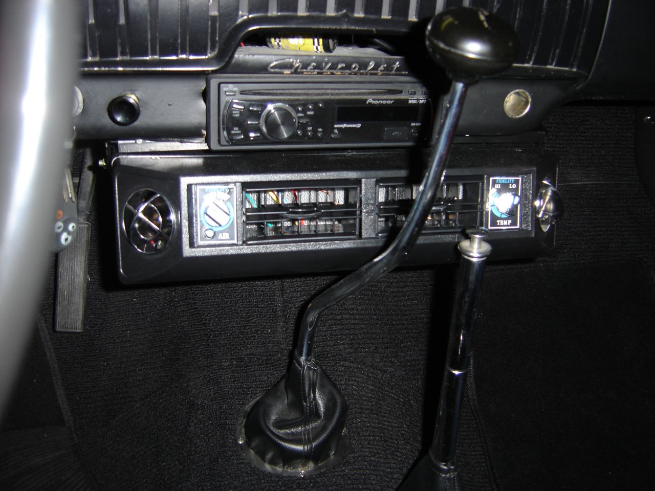

  9. Not my car but a picture of outlets ( love this car )

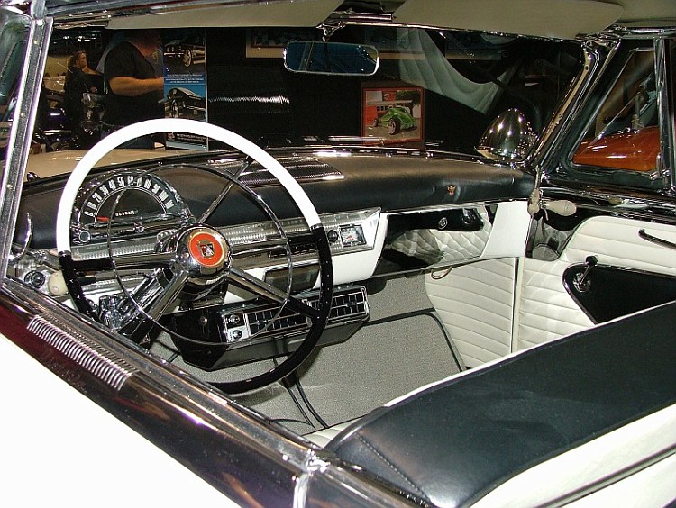

  20. 40StudeDude
    Joined: Sep 19, 2002
    Posts: 9,539
    40StudeDude
    I would have had a H-U-G-E radiator had it not been for the '78 Pontiac Trans Am sub-frame and the front steer box...my aluminum radiator is 19" wide by 21" deep, two 1 inch tubes and a double core, therefore it needs a shroud and a huge six bladed fan...believe it or not, the engine compartment in a '55 Caddy isn't that big...!!!

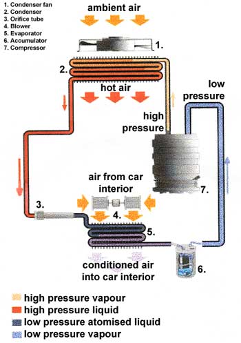

    just a thought. Is there any reason why an A/C set up from a modern car couldn't be altered to fit into a project car?
    the diagram shows the basic system, I know that the gassing side needs to be handles by a specialist (well it does here in UK anyway) but i can't see a reason why it couldn't be done?
    unlerss i'm missing something basic, and that wouldn't be the first time!!

    Here's the under-dash unit in my '52 Chevy. I run a 4 row triple pass radiator (copper/brass) from U.S. Radiator (direct-fit). Flex fan with a full shroud. Temp stays at 160 in traffic with the A/C on. Without the A/C, it runs at 140. I may switch to a 180 thermostat.
