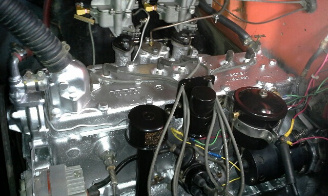

    George Asche Dual or Tri Carb intakes, and matched Carter B&B carbs, or a single Carter BB1 and single exhaust if you so choose.
    here is mine, runs like a dream, good fuel economy, and decent power for what it is, a basically 100-120 hp stock engine with a long stroke.

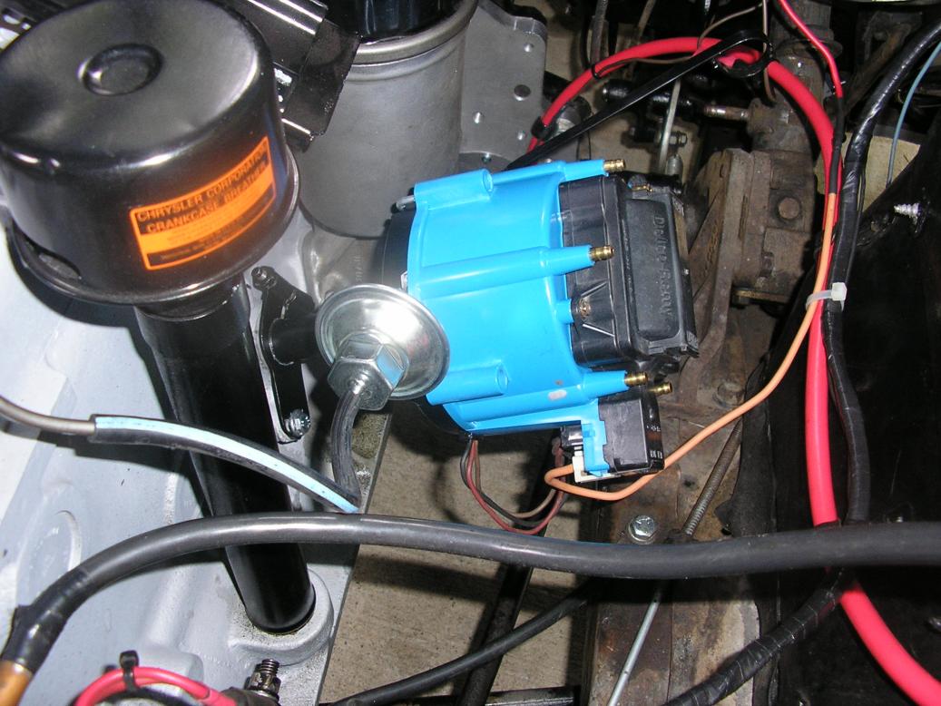

    I like the GM HEI ignition conversion. They don't know if its in a v or inline, cheap and work amazing on old engines. basically you cut the shaft down, and notch the end to fit the oil pump drive, bingo, Bobs yer uncle. Has anyone seen the flat head six with the 3 carb turbo on YT ?
  15. Flat Six Fix
    Joined: Feb 6, 2010
    Posts: 1,270
    Flat Six Fix
    Okay sounds interesting, got any pics of the process and install, on a Chrysler flathead 6?

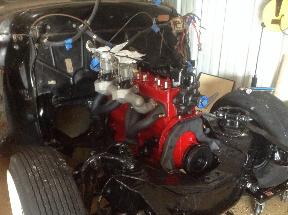

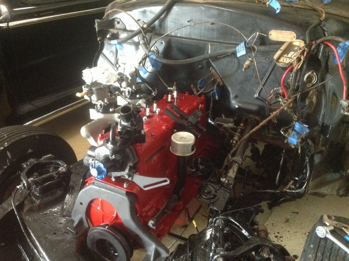

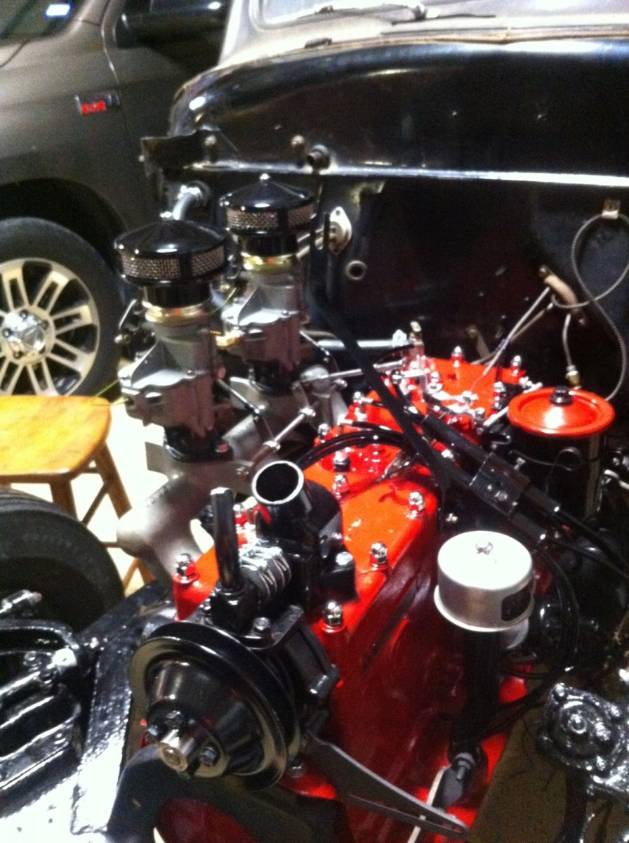

    After all the advice you guys/gals gave me, I'm making lots of progress! So thanks again!!

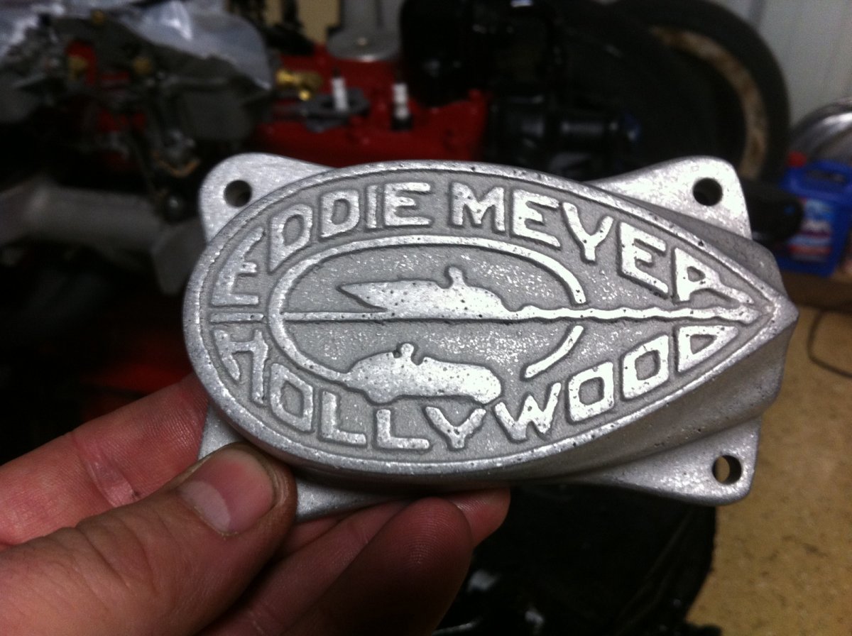

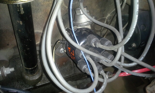

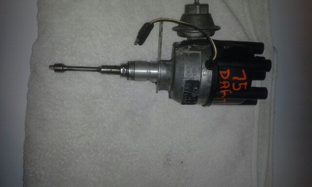

    I Never knew you could get nickeled & dime'ed to death on a total rebuild!! Damn... Cloth wire $$$$, Meyer fuel port $$, thermostat elbow &separate tube$$$, some Mopar parts companies got us by the twins on some parts, know it & price gouge us!

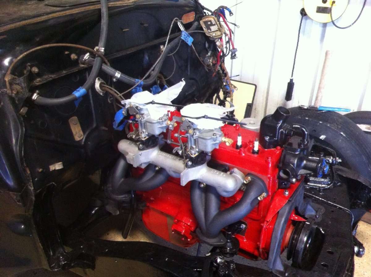

    image.jpg More progress

    how did it run with dual carbs . ive had a offy 2 carb intake for yrs. but my 50 wayfarer ran so good , ive never had the heart to install it. and with the 300 gears I get 20 mpg. and roll 70 + all day .split exhaust sounds like no other , at any speed!!

    Engine looks great!
