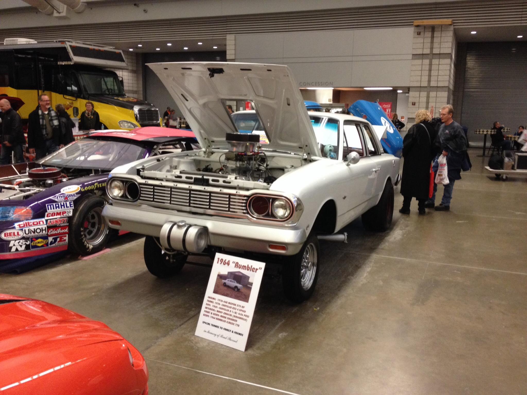

    I changed the rambler from auto to stick. Found a pedal assembly out of newer rambler- but I made everything else. Made the z bar and all linkage . One of the hardest things I've done to date ! I learned a whole lot about geometry during this 3 week project ! Examples - had everything assembled , but leverage was wrong. Remove trans again ! Cut and lengthen fork so as to make it 2:1 ball stud to adjuster - scratch build z bar for another 2:1 - linkage rod from pedal pivot through firewall it had to drop 4" at a 32 degree angle !!! All rods done with heim joints for additional adjustments ! In short - anything can be done , with a lot of sweat and perseverance . We just were sure we wanted old school linkage , not some hydroloc T.O.B. - would I do it again ? Yes ! It was a great learning experience and now the next one will be much easier
