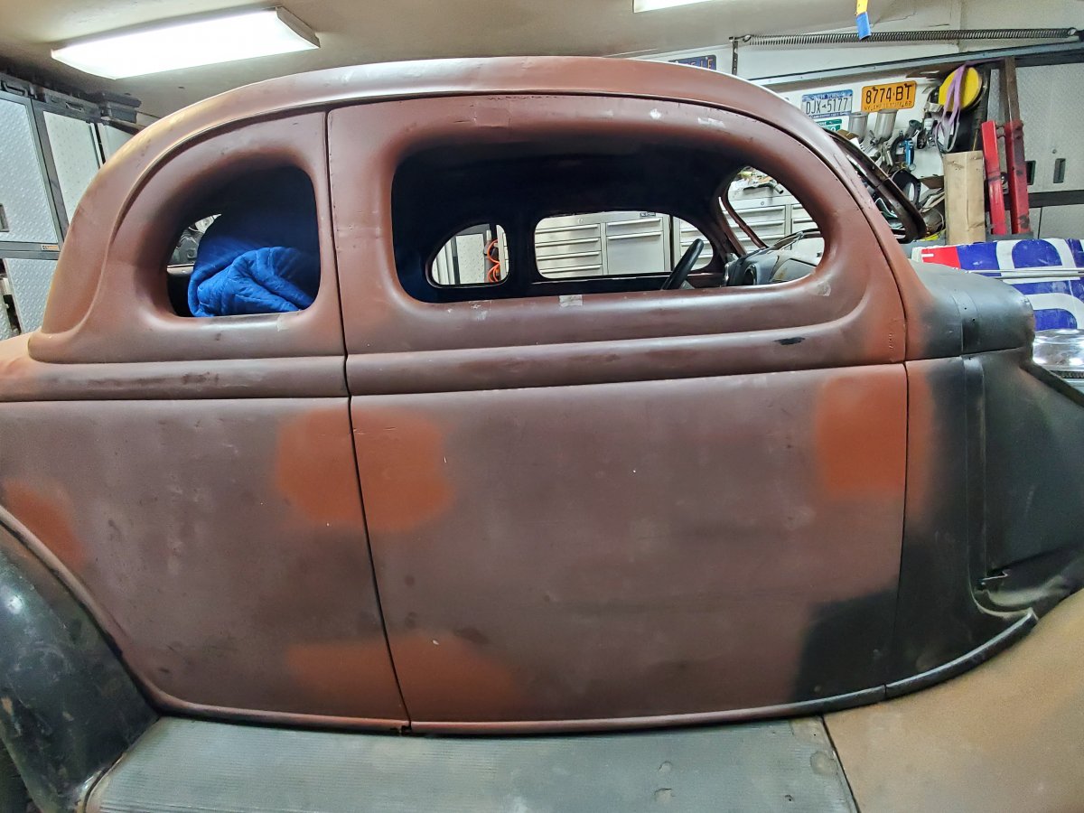

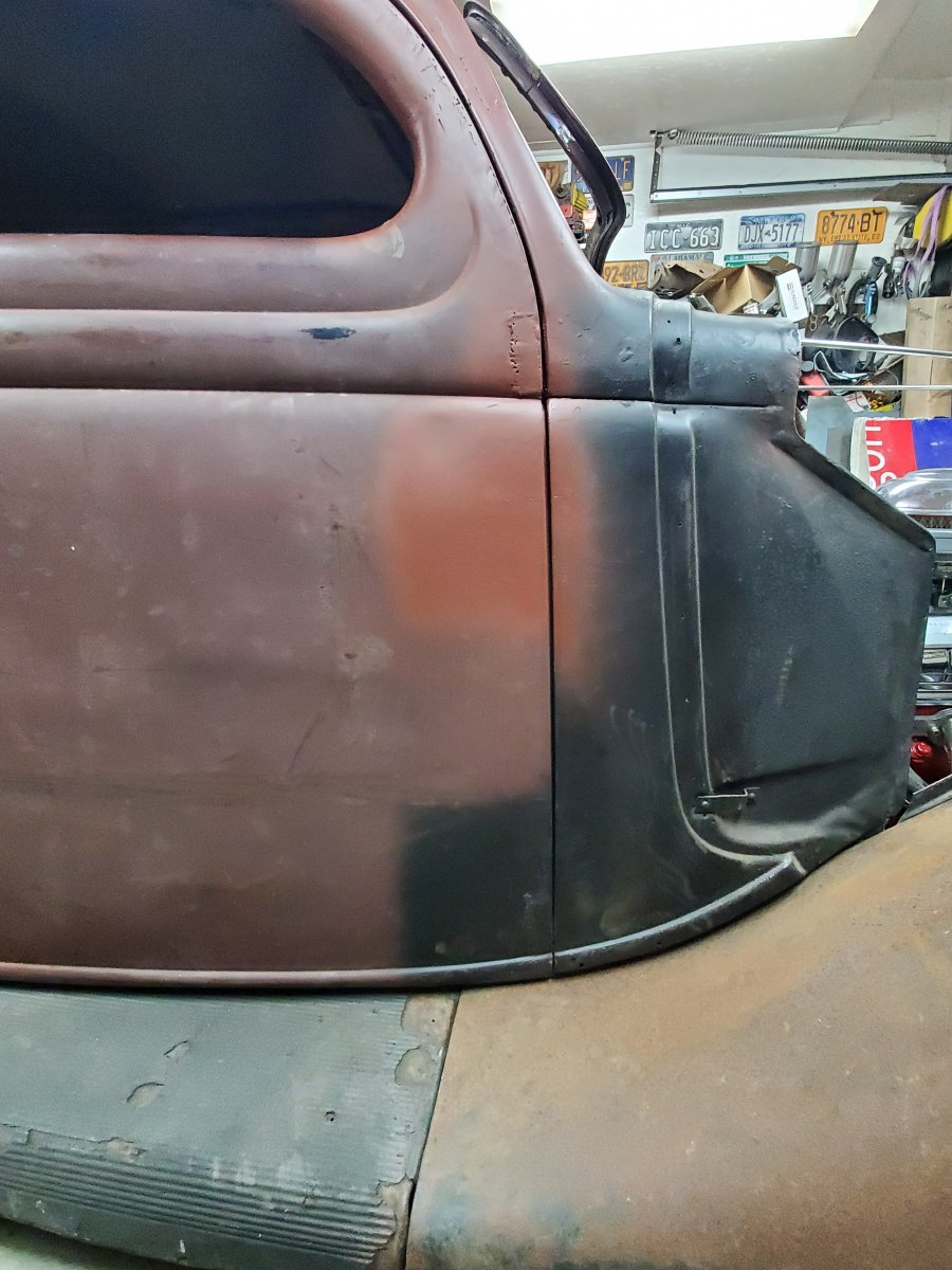

    When I bought this car the door gaps on both sides were very even. The chop on the drivers door looked a bit Fugazi but I figured since the dors fit nice it was something to pick at later. Now that I've finished the chassis and went to bolt down the body I found the body high at the left cowl. I had to pull it down with the bolts. When I did that the door gap changed and the door binds. It's rubbing at the top front of the door. I measured the door jambs and the are not the same dimensions left to right. Off by 1/4"- 5/16". My thought was to cut off the door frame, adjust the gap and trim the door frame to fit the roof. Any suggestions?

    Just to add the front floor is out and the P.O. replaced the firewall. I dont see any evidence of bracing. Based on that and door jamb measurements I'd bet the top wasn't chop while bolted solid to the frame.

    I thought of that. It's about 1" off. I feel that's too much to shim. Thought that would throw off the hood alignment.

    Using the bolts to pull down the body at the left cowl appears to be pulling down to much on the left front corner of the body even pinching the gap at the top of the door. I would unbolt the car from the frame and it should relax to the point the doors lign up again.Do some careful measuring on the body - cross measuring - try to be as precise as you can - something is amiss. Maybe like 46caddy stated the frame maybe the culprit , the mounting points might be out - pulling the body crooked. As you are unbolting the body watch the door gaps closely and see what happens. By the way your car is mucho cool!

    It was loosely bolted only in a few places.

    I dont have a jig. I did level the frame and across the crossmembers.

    Car has taken at least one hard kick in the butt and a punch in the nose.
