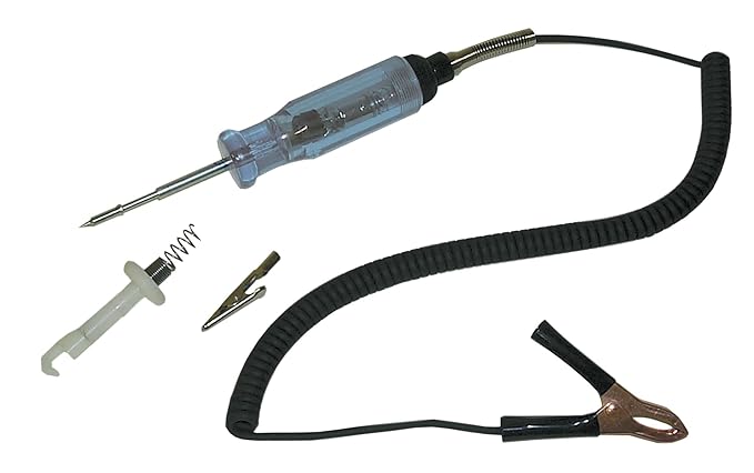

    During analysis use a flashlight bulb and battery type circuit tracer, thus or home made:
    this helps you figgerout where each mystery wire actually goes.
