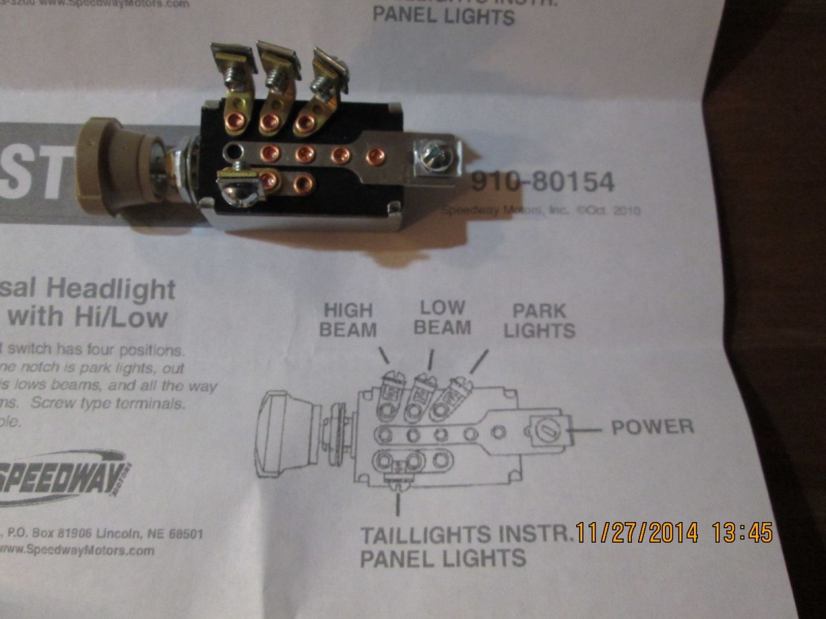

    I have two wiring diagrams and neither shows how to wire up an original headlight switch for my 47 Ford truck. Does anyone have one? Or can I get a pic of how yours is wired up?
    Thanks!

    There are letters in the plastic top of the original switch...2 B's for battery, H for headlight, etc.

  5. Invest in a shop manual, they re-pop most of them and I found mine on eBay for around $35.

    I've opened a bunch of those...Ford used them about '41-50. All were good once cleaned! They are a lot better quality than most aftermarket repro. And no silly re-designs like operating dimmer with the dash knob, like the repro shown...
    Gently bend back the little tabs holding plastic to steel case. Do this on a clean flat surface with no cat on it, and on a paper towel so stuff doesn't bounce or roll much. Carefully lift off plastic and carefully pick out the slider stuff and springs...lay out in order on the towel. Swizzle everything clean in lacquer thinner, grease all the contact areas with light grease, and reassemble. Takes maybe 10 minutes and switch will be ready for another 70 years.
    The dimmer can also be saved this way...most are die cast, gently bulge it a bit to get apart.
