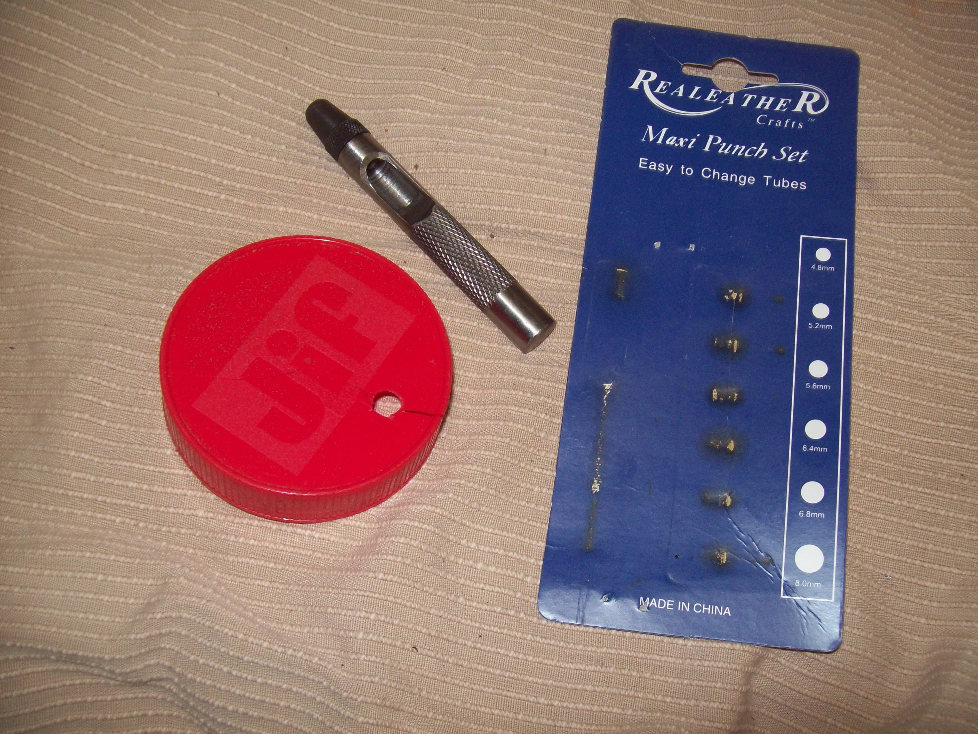

  4. The high beam indicator was also in poor shape so another lid,this time from a peanut butter jar was used. 001.JPG

    Didn't seem to me that the peanut butter lid had much light transmissivity.
    Took a flashlight to the kitchen and was shocked to find out it does indeed.
    Great tip (posted with a mouthful of peanut butter)

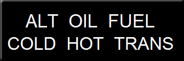

    I've gone to trophy stores before to have instrument panel stuff engraved. They can do pretty much any design, including turn arrows, etc. Normally I have them use the clear plastic that has a black surface. Their engraving machined cut through the black layer, leaving a clear plastic word or image that light will shine through. If you want to do some custom panel stuff, you can backlight with different color LED's. OK, not traditional, and sounds street-rodderish, but LED's used as turn signal indicators, temp warning lights, high beam, etc are pretty damn easy to do and last a long time. I built a 40 Ford pickup way back in the early 90's, with a 2" by 2" box mounted above the rear view mirror that kept me apprised of 6 different conditions, and the current owner told me last summer that they are still working. ALT, OIL, FUEL, COLD, HOT, TRANS. Yes, COLD. 1964 Olds and some other GM cars of that era have a temp sending unit that has two connections, one that grounds until the engine is warmed up, and another that grounds when it is hot. TRANS was for transmission over temp.
    Sample below.

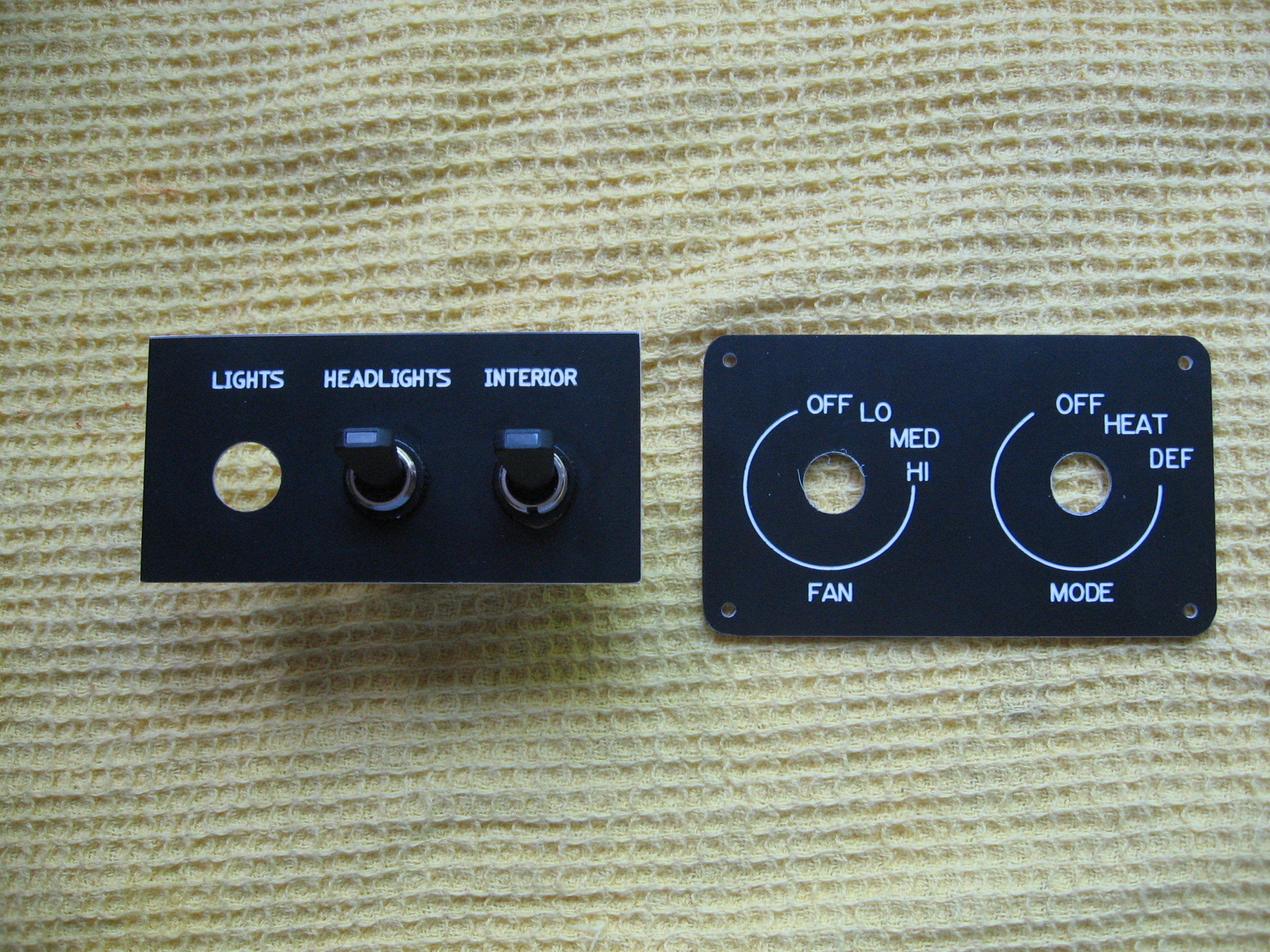

    I had a similar idea-used a local "promotions" company (your name on a pencil,etc) to copy my designs. It worked great inset into a wooden dash (left plate) and on a drop down panel made form a fuel door (right photo). Total cost for both was about $20.
