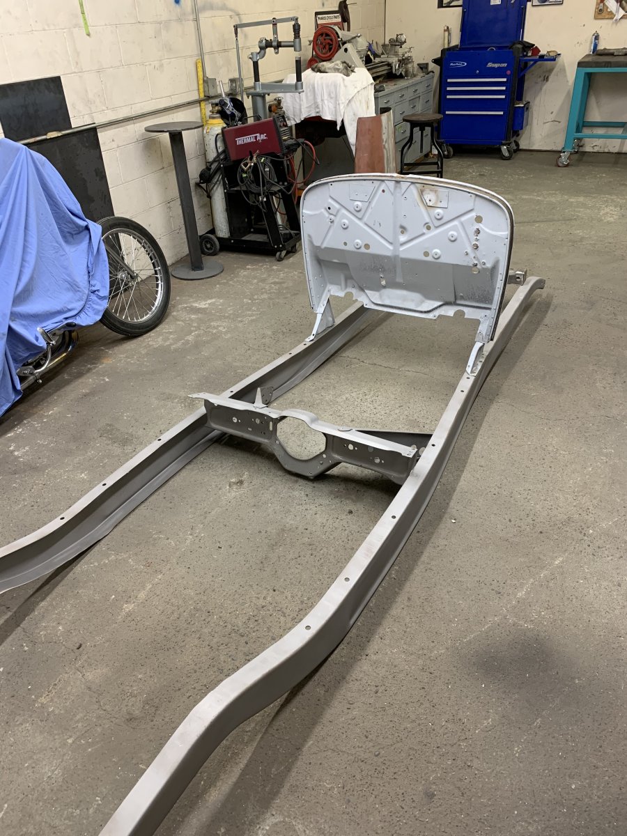

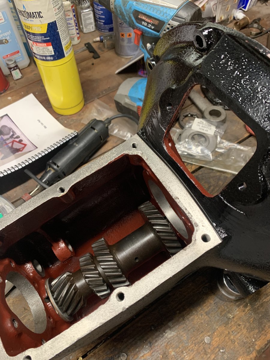

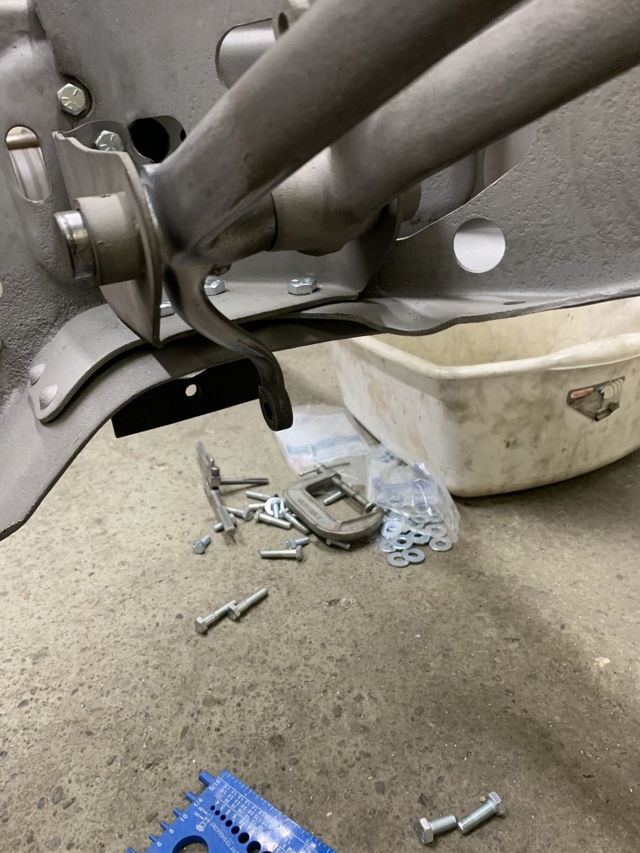

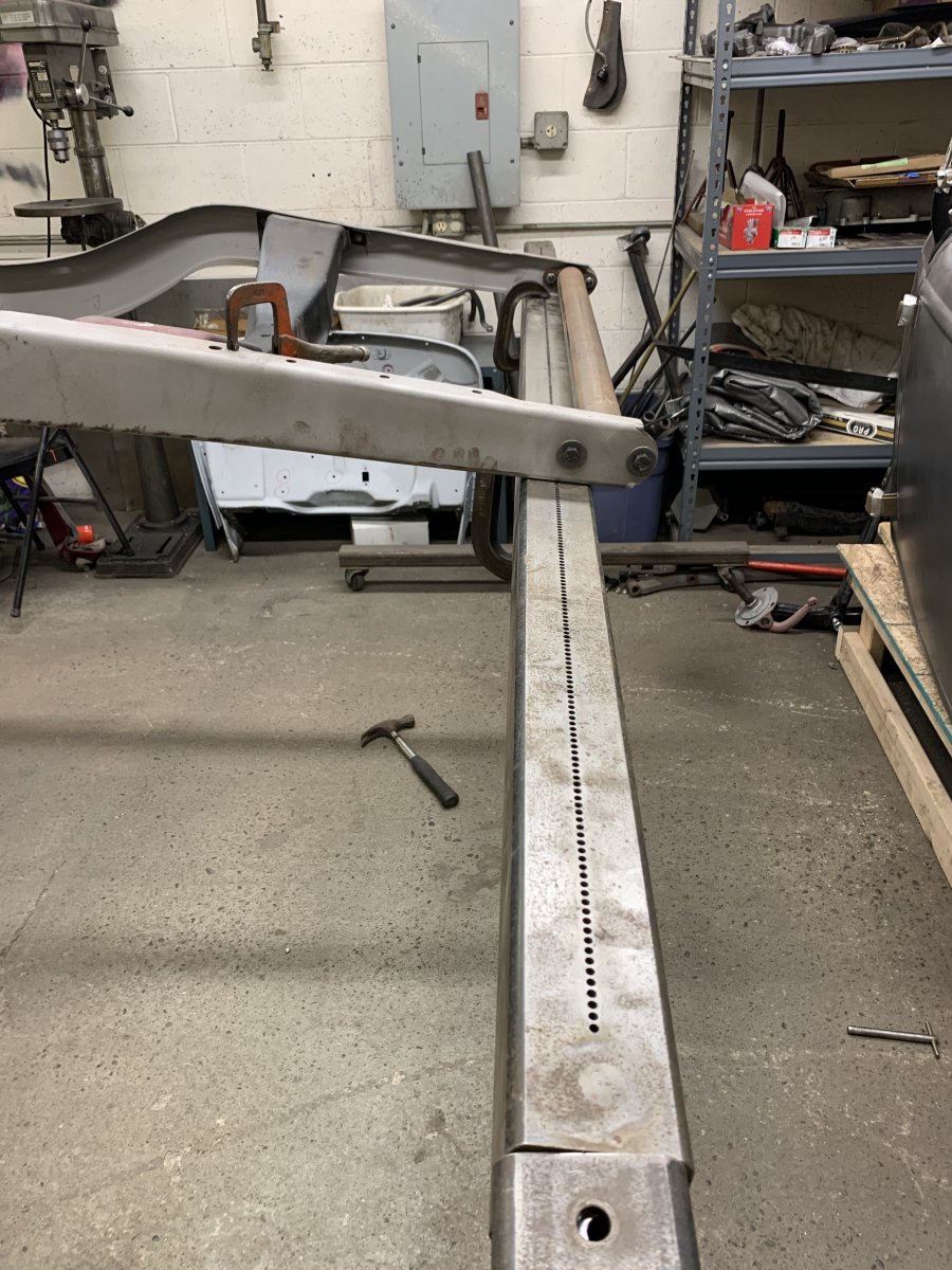

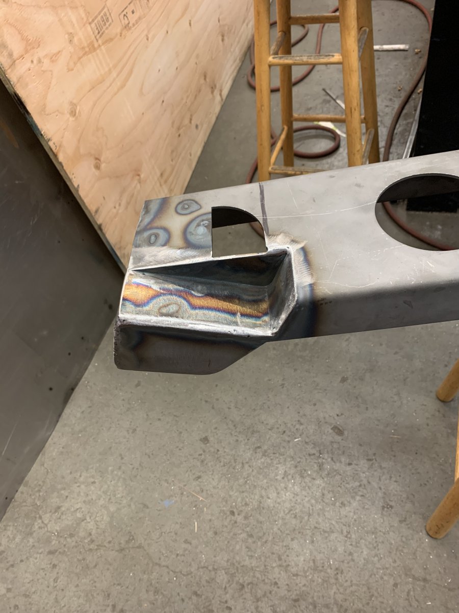

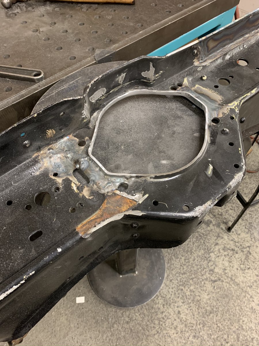

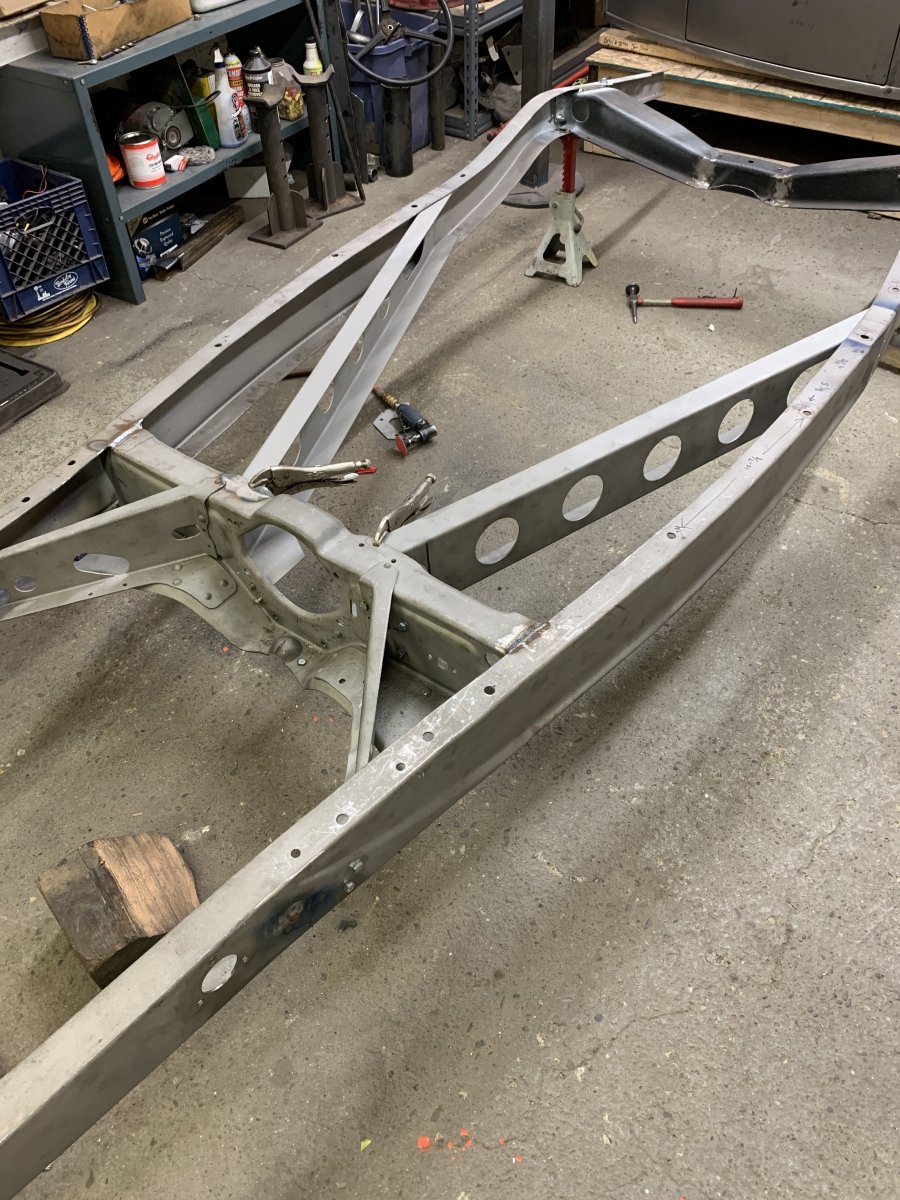

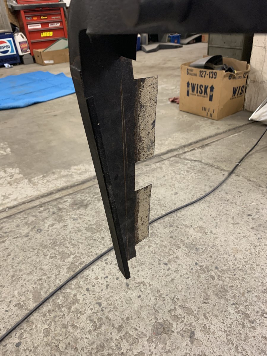

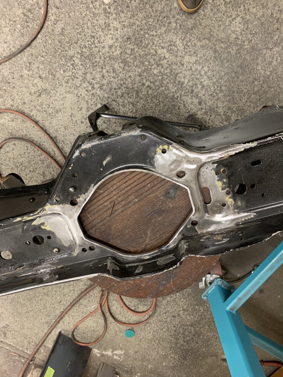

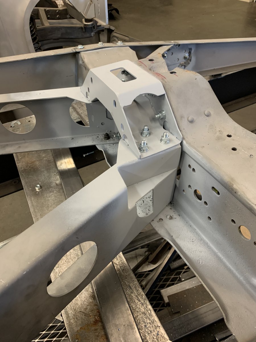

    A few years ago I sold a 32 seat to someone in Canada, so I called him to see if he had any 32 parts. He had a kmember, so I got that and set about repairing it . Seems as good a place to start as any so let’s go.
    I had to rebuild the flanges mostly . Next I got some ASC rails from squeak bell, a couple of crossmembers and a pedal assembly and a firewall and set about to repairs and a hydraulic brake conversion.

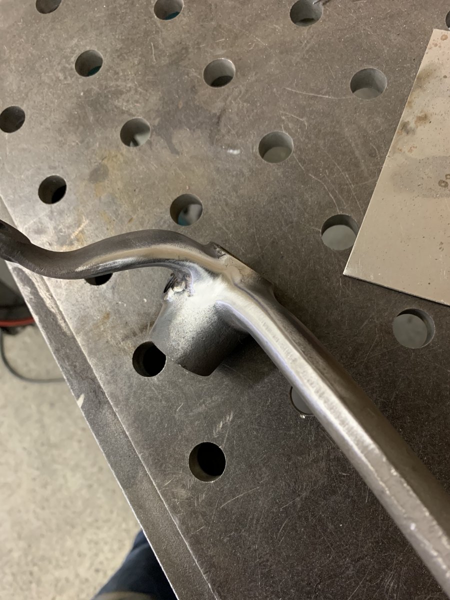

    heyitsnate
    It’s putting the photos kind of out of order, but you get the idea

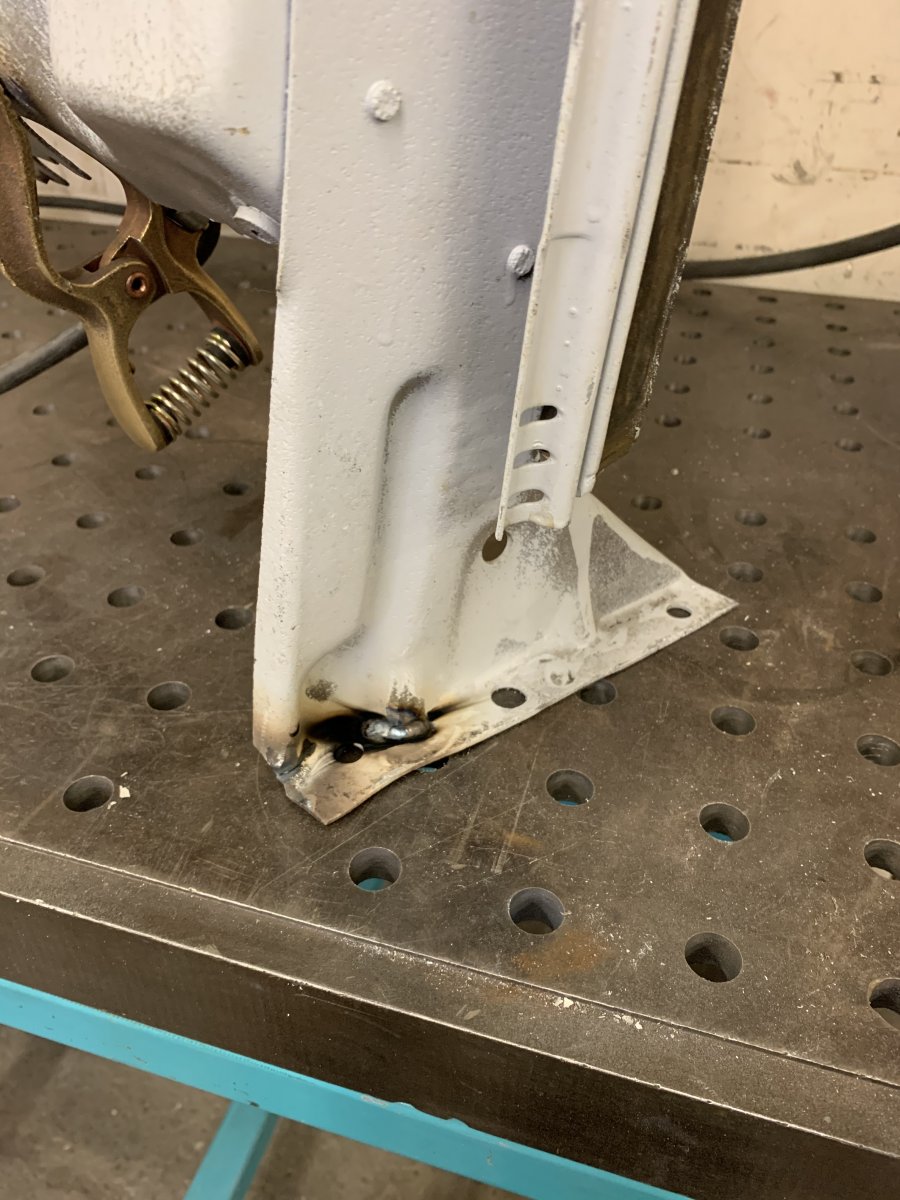

    Ok. So to give you an idea of the timeline, the last post is when quarantine struck, which just happens to be right after I scored a big load of parts. The build really started to heat up around then so I’ll post a big mess of photos tomorrow !

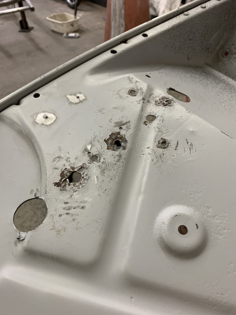

    Some fab fabwork going on there!
    Remember the days when guys would walk by a deuce firewall at a swap meet because it had some holes in it and keep looking for a nicer one.

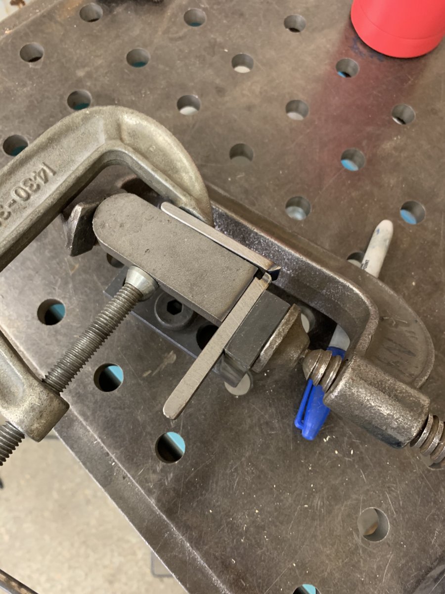

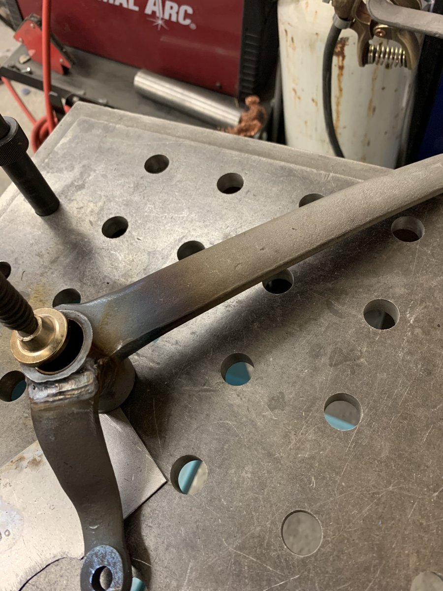

    Can’t wait! I love your fixture table is it threaded? Your thread holes seam pretty big! On mine it’s 1/2 20
    chryslerfan55, Stogy and heyitsnate like this.
  11. heyitsnate
    Joined: Apr 8, 2004
    Posts: 1,750
    heyitsnate
    It’s just 5/8 holes, no threads

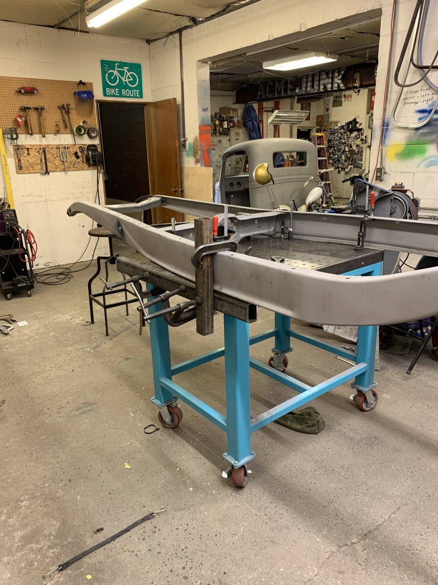

  12. heyitsnate
    Joined: Apr 8, 2004
    Posts: 1,750
    heyitsnate
    Someone did walk by this one at a swap, they must not have asked how much because I paid 150 bucks
    Runnin shine and Stogy like this.

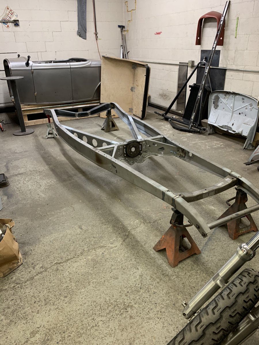

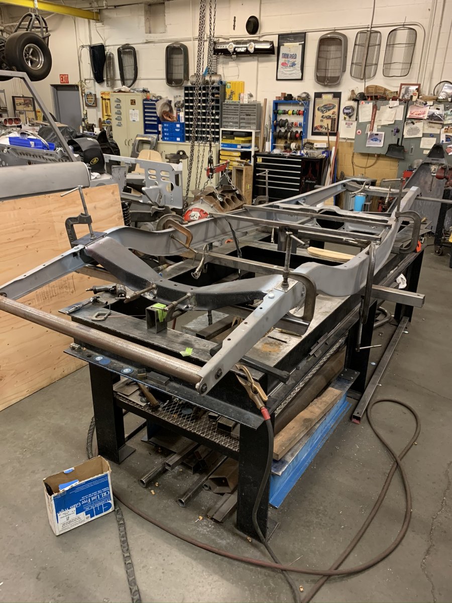

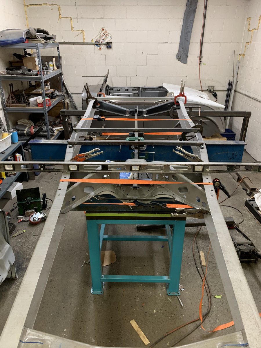

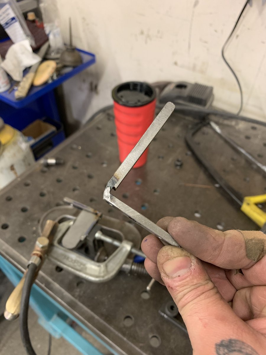

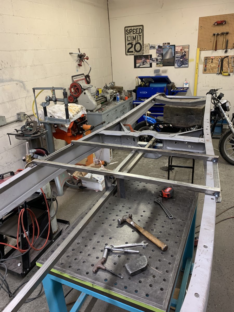

    In this thread you will see a few attempts at various things. One of them is putting the frame together.
    armed with a blueprint, my table and a motorcycle frame jig I made attempt 1 . 07609B84-6D06-48C4-BCB3-CB130F82A650.jpeg 55F3CB58-1020-40A1-990C-03BD8060CCCA.jpeg 3BCD25D5-9F83-4DEA-BCC6-C568AD06B43C.jpeg E69C7E47-C83E-416B-9E04-60C7F3D216C2.jpeg
  14. heyitsnate
    Joined: Apr 8, 2004
    Posts: 1,750
    heyitsnate

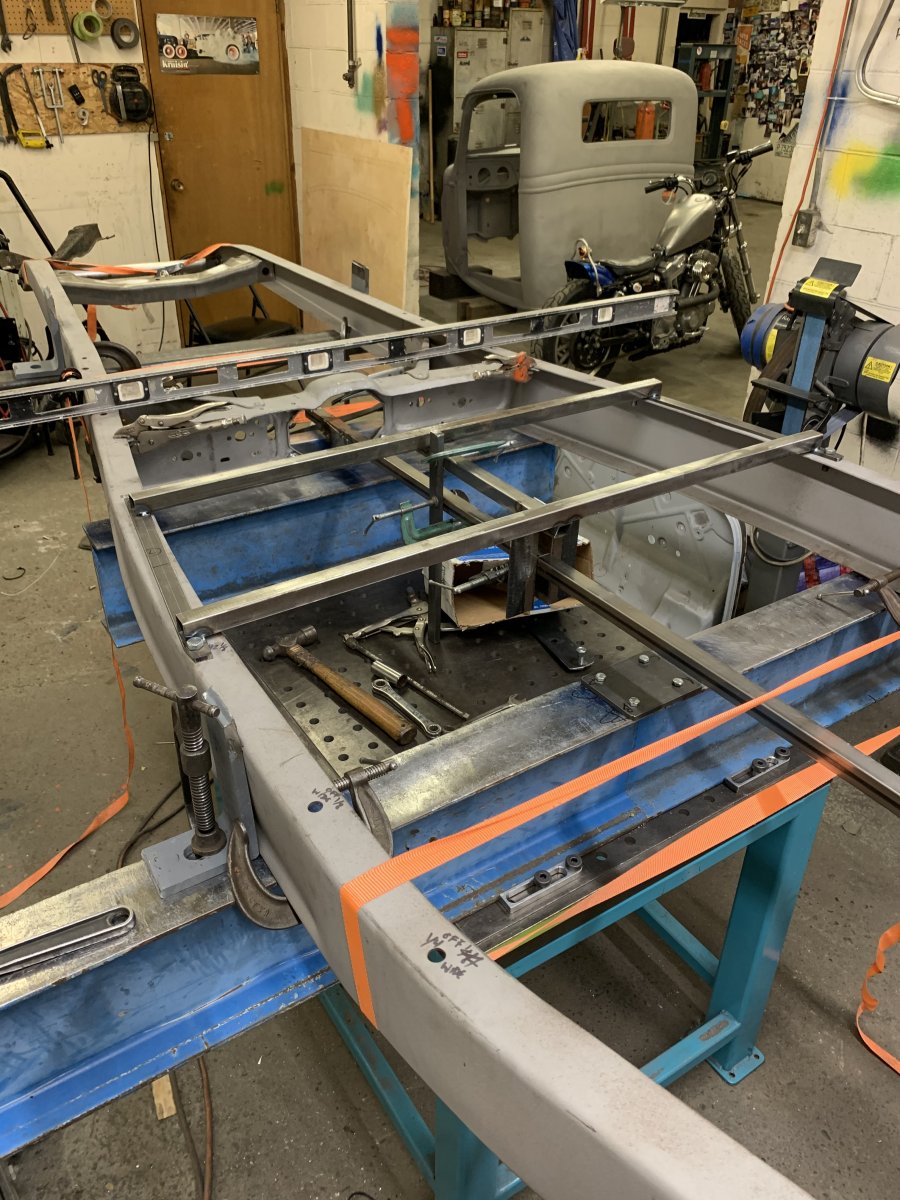

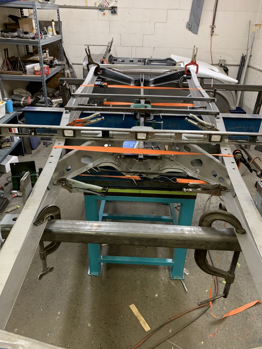

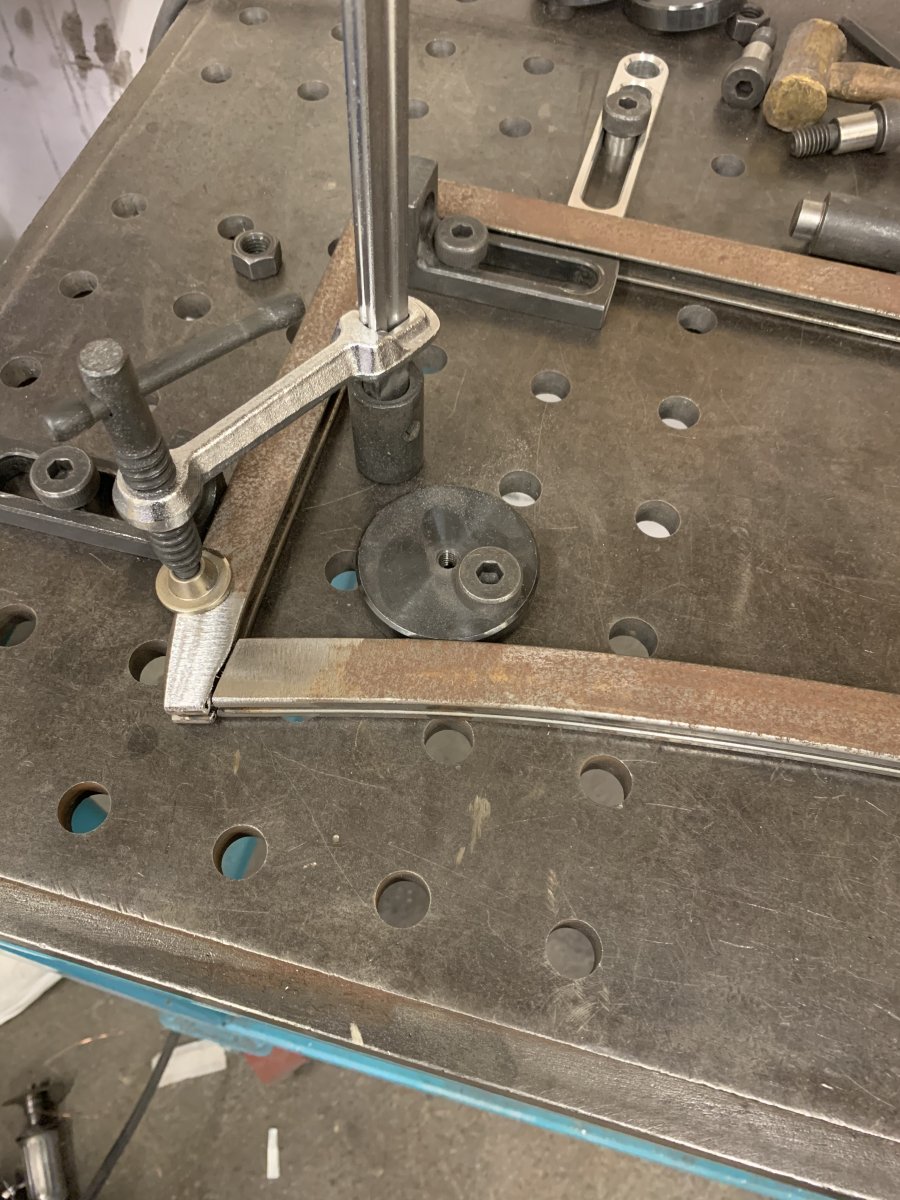

    Attempt #2 I added some borrowed Ibeams, and a fixture I made From a cherry 32 frame . A friend was nice enough to entertain my ideas.
    F32A604F-09B7-432B-8F4B-266E59390A2E.jpeg D1731F44-68D3-4E25-BB1C-68D064EF326D.jpeg 19C6E27A-D868-410E-A809-69850BDE999F.jpeg B7810A40-44E3-4AEF-A604-B2D34AA5EA10.jpeg CBEFDC23-B906-4056-B75B-A09B520CB2D6.jpeg

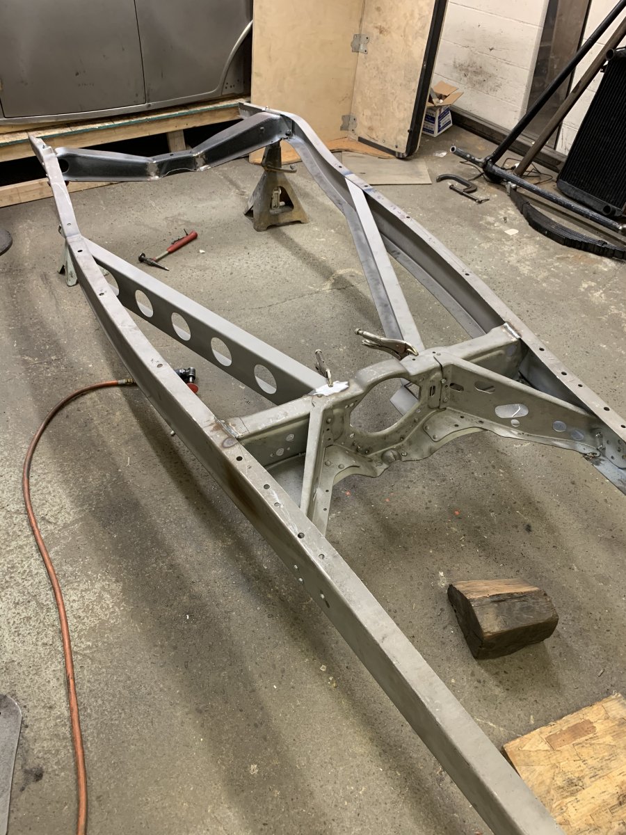

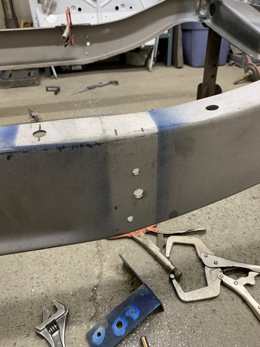

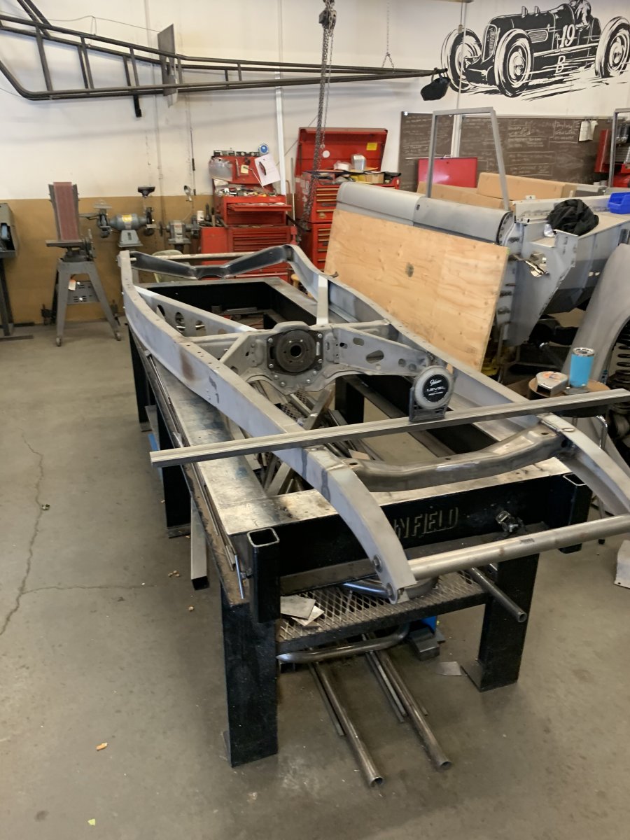

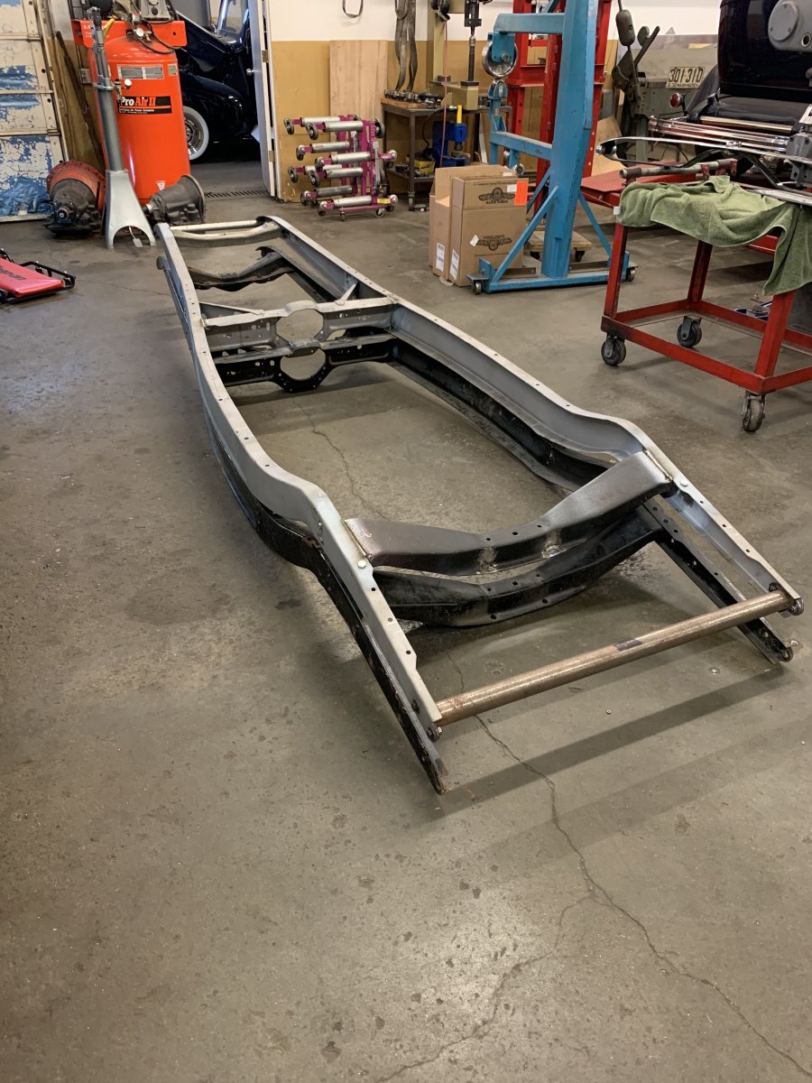

    after these attempts , Marshall at thun field rod and custom took pity on me and cleared his table and we got it tacked together. since time was limited on the table and since I was planning on adding additional legs to the kmember it was tacked enough to keep things moving forward and once the X member legs were sorted , then I could weld everything up final like.
    ADA4D9C7-CEB2-404C-93EF-8C6D87ACCD12.jpeg BDC8A438-B55A-4419-B12C-78B50B36B568.jpeg
  16. heyitsnate
    Joined: Apr 8, 2004
    Posts: 1,750
    heyitsnate

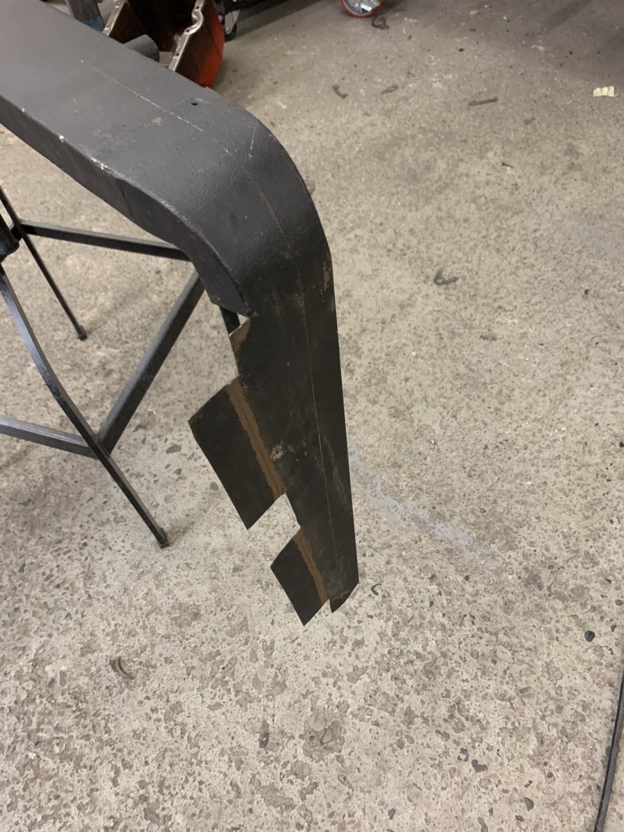

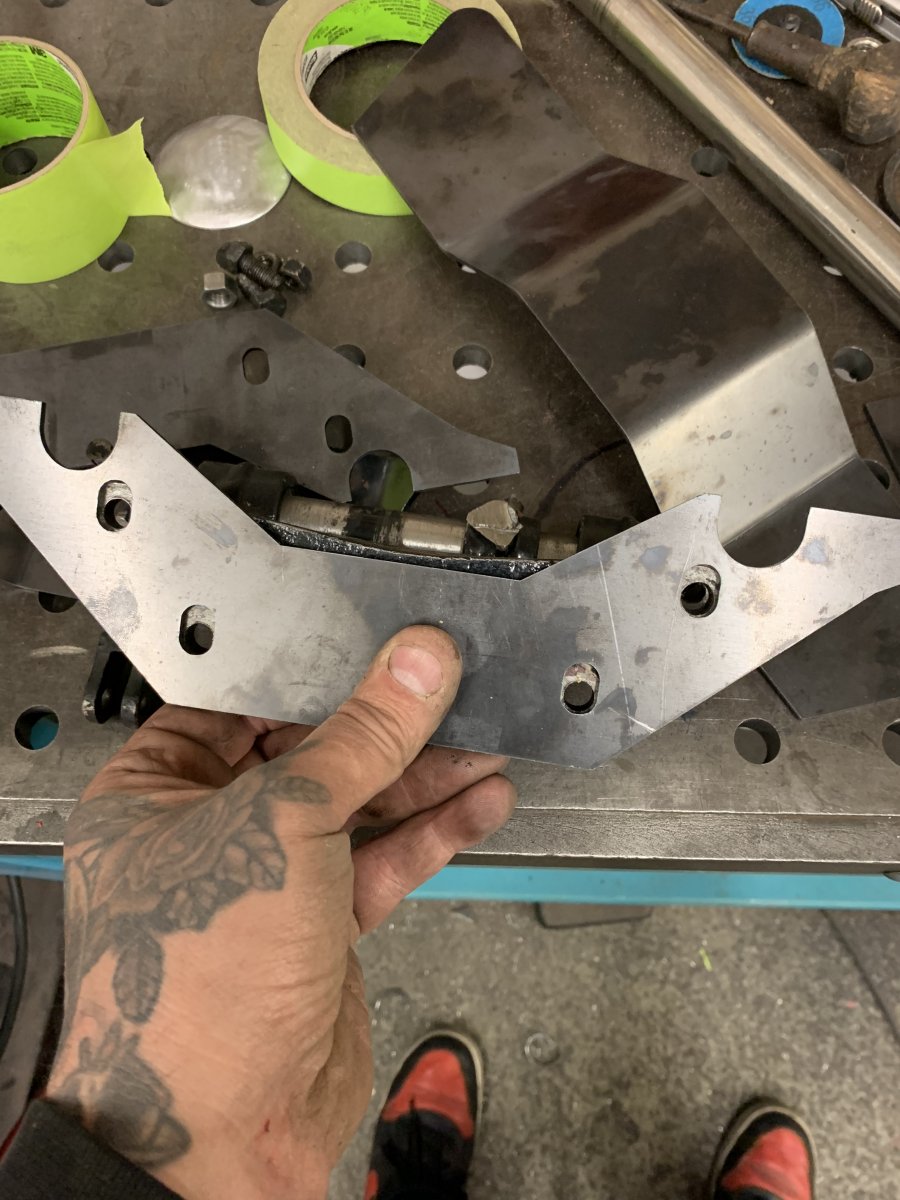

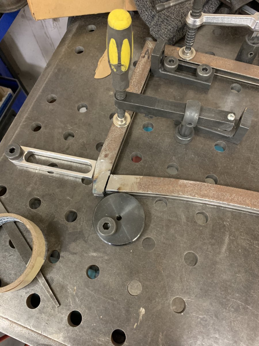

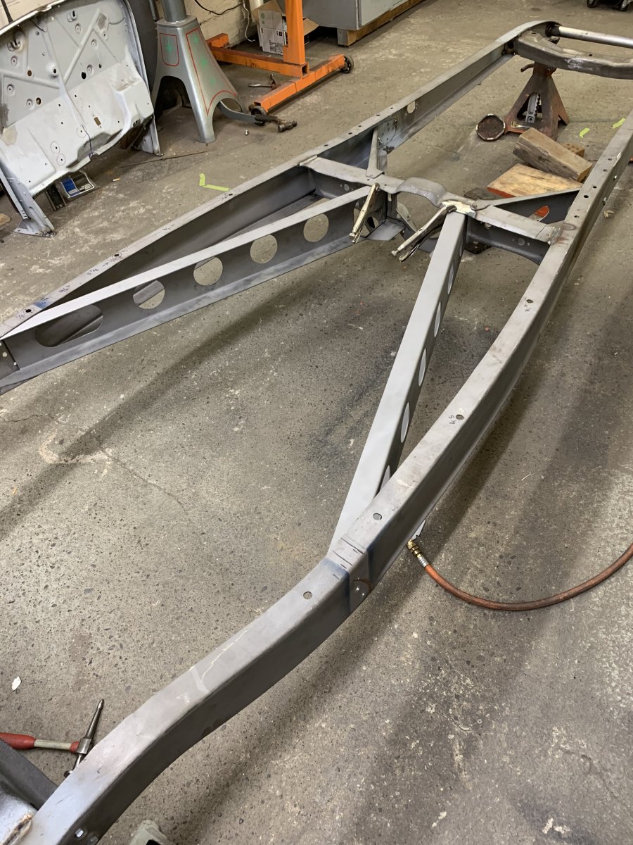

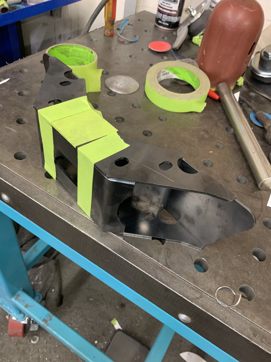

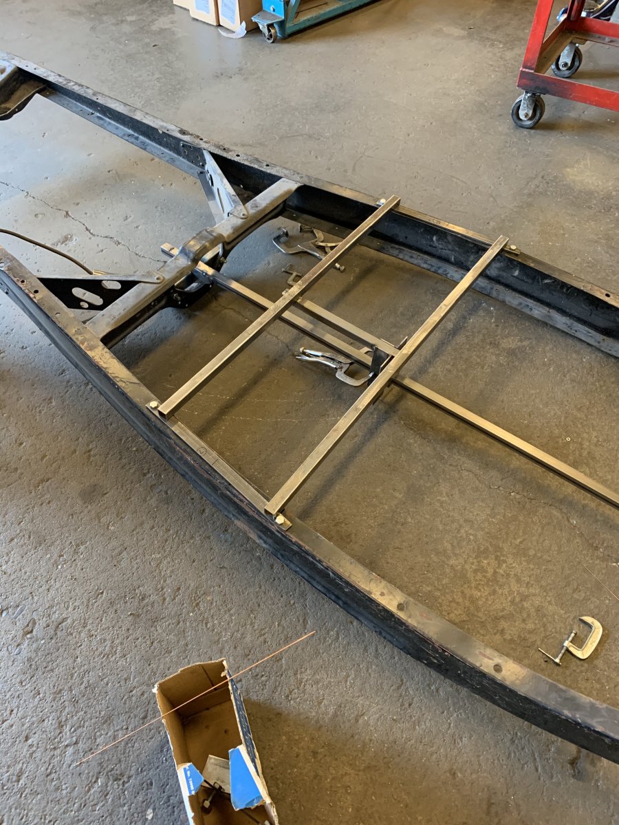

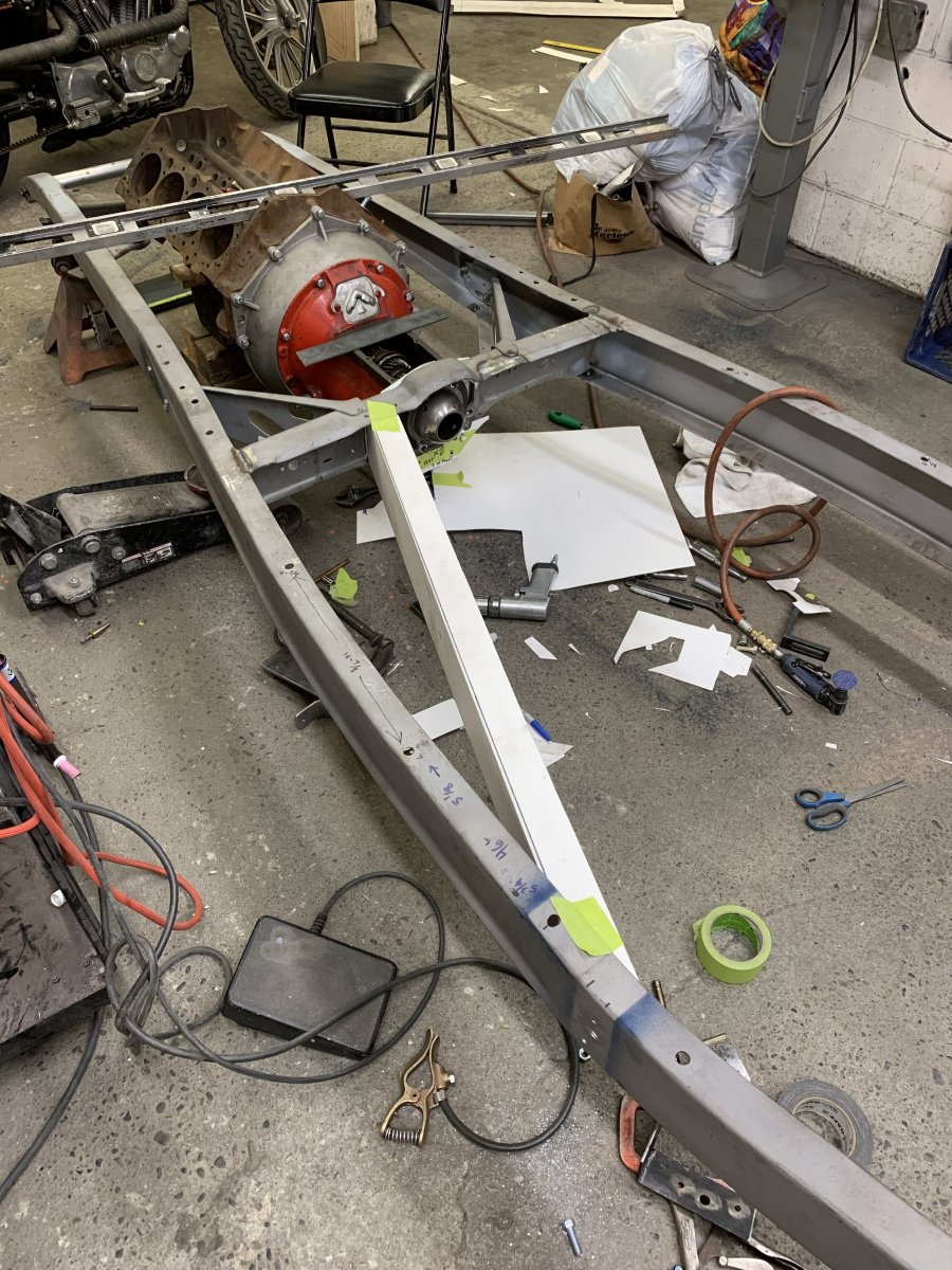

    When I got the frame back to my shop, I laid out some paper templates for the x member legs. Not ashamed to admit I took a great deal of design elements from industrial chassis and our very own British phenom fresh reflections (the pinstriper) . I’ll show you my cardboard crap then we will move on for a bit to modifying an f1 steering box . I made more fixtures from a stock frame for the rear legs/fender holes. you may have noticed the mock-up engine and trans. Since I had a 1958 chev 283 , that’s what I’m using , along with a 39 trans and 1940 rear. 172B585A-27C5-4A15-BF52-2A2C7082193E.jpeg 13B2A0F2-E7DB-4A53-8A4E-EF2C621DBB87.jpeg 4457BA00-D2AF-4FF0-9B4E-8C44BD4CEFDC.jpeg 1CDB1779-979F-4999-A17D-2265838157BE.jpeg 1A4AE4AA-AAE9-4517-90A4-07F3D1CC4283.jpeg

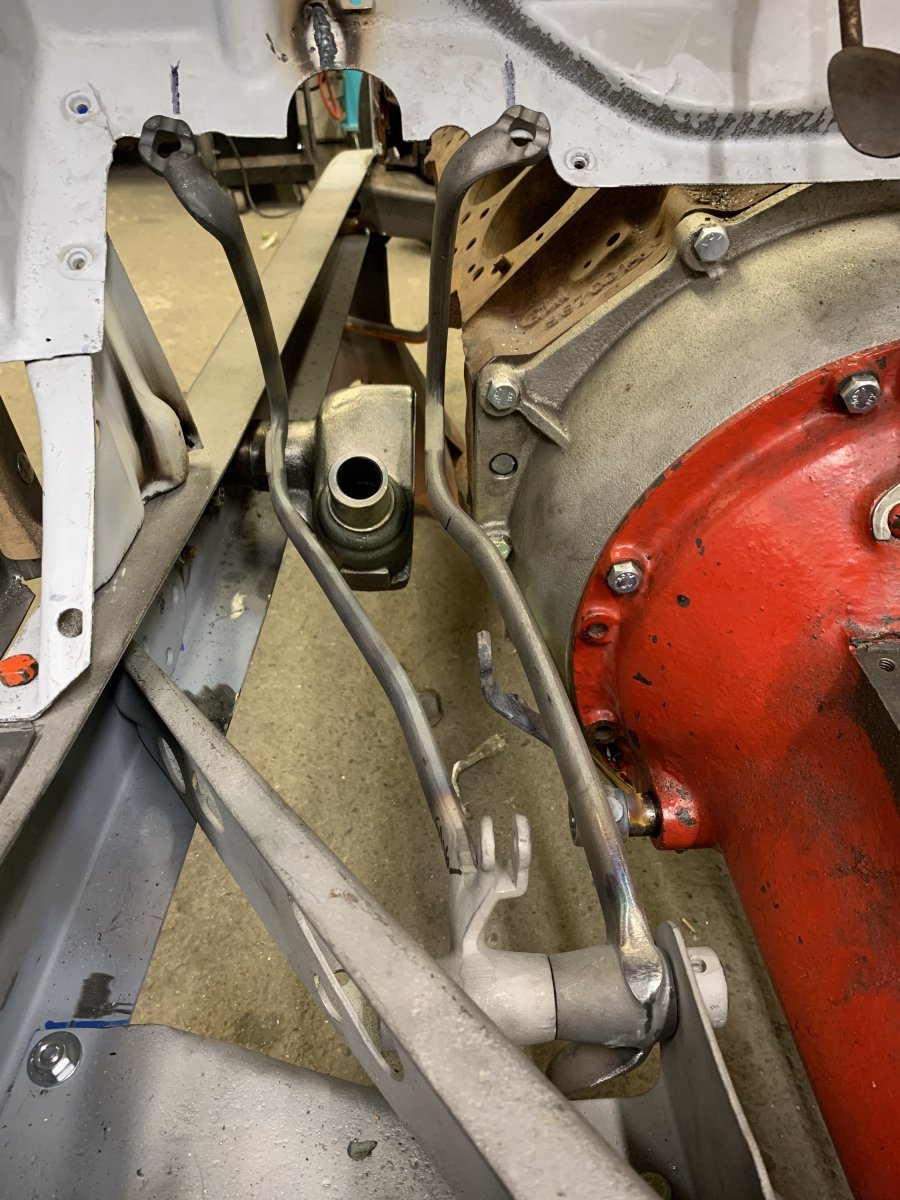

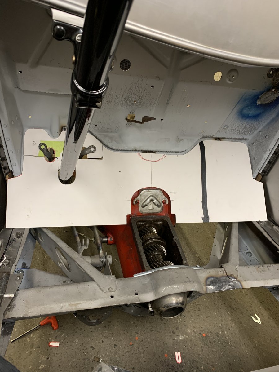

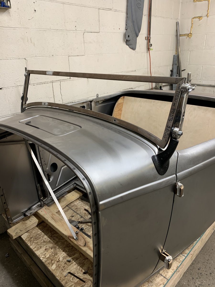

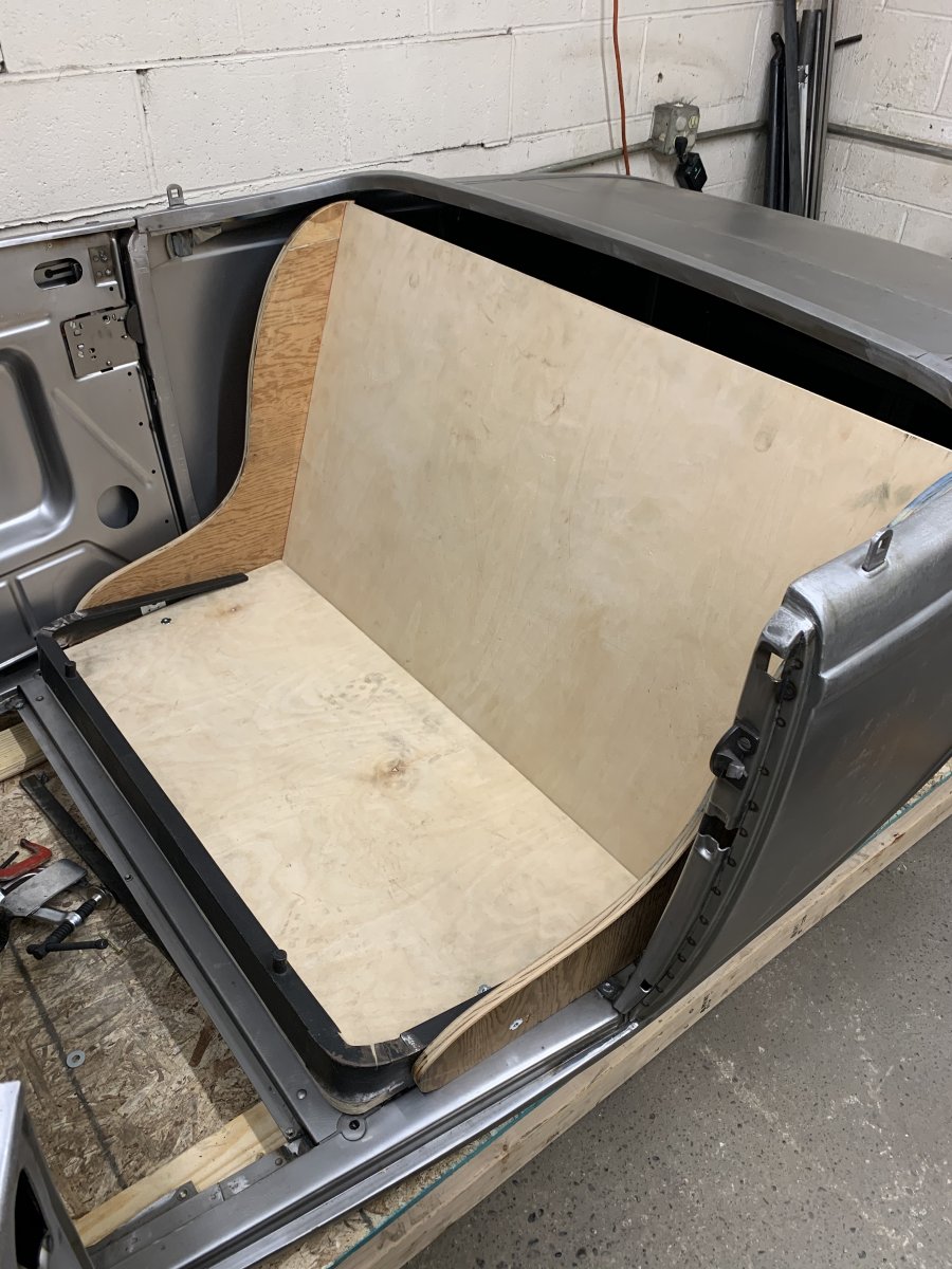

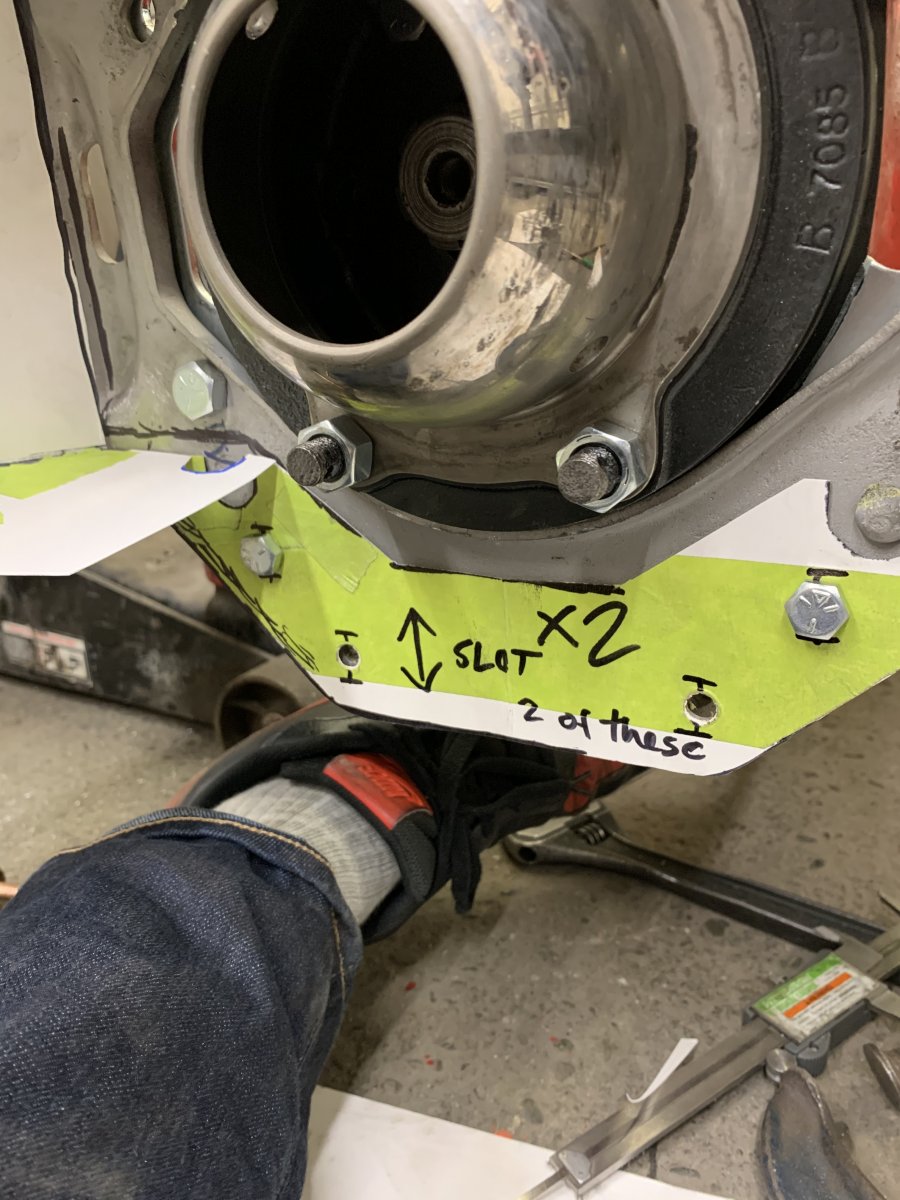

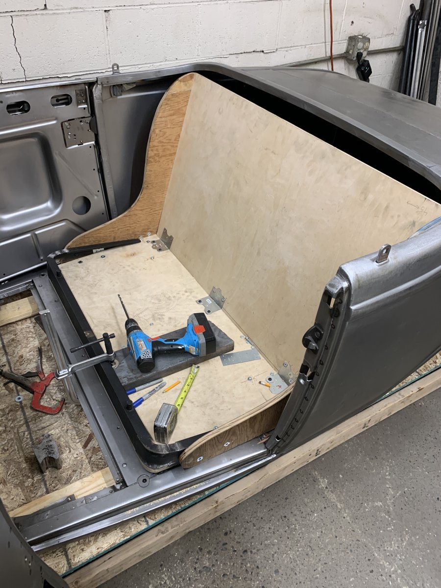

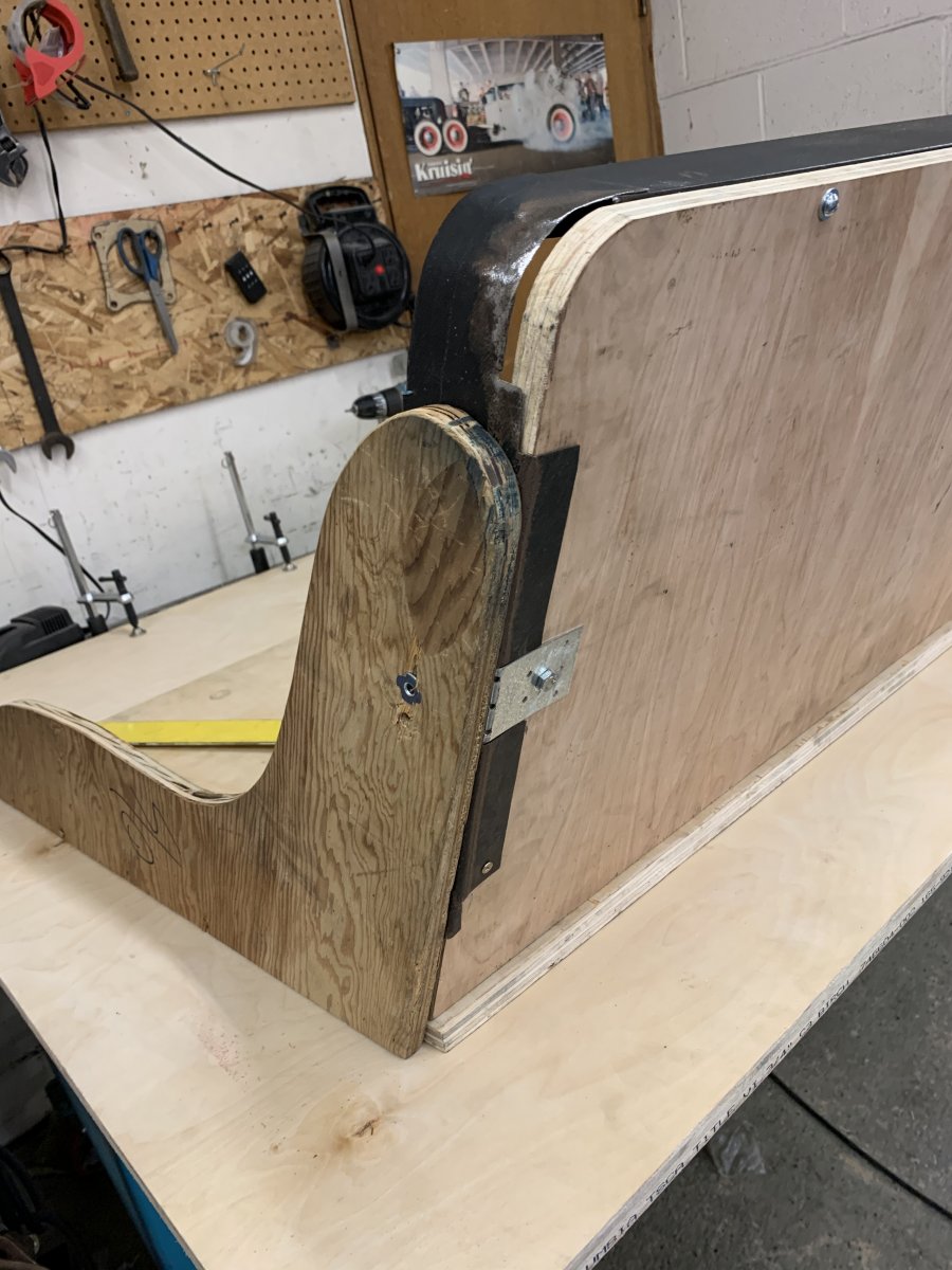

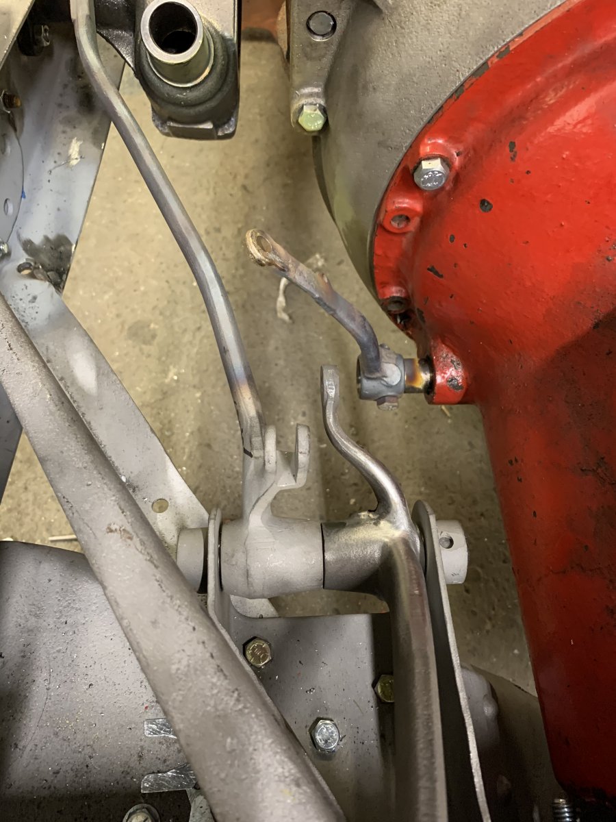

    Whole bunch of misc. stuff. I popped the body on, shimmed it , made an e-brake bracket, moved my column and pedals around, and set up the clutch and brake linkage and started laying out floor templates. Can’t find the pics but I also dropped my steering arms (round back spindles) and set up a tie rod . 304D97BD-7D43-44AE-9D48-CE524D77476D.jpeg CDCC65AF-68C9-4B8E-B93F-19ECB766C24C.jpeg E084F09D-9767-4160-BC38-F4027E08F30E.jpeg B1A7EA23-5562-436B-927B-22203F5B792A.jpeg C238F3CB-A870-450E-8983-F190C26AF169.jpeg E8088E83-C9EE-45C2-8BDC-830EB3E8F62B.jpeg

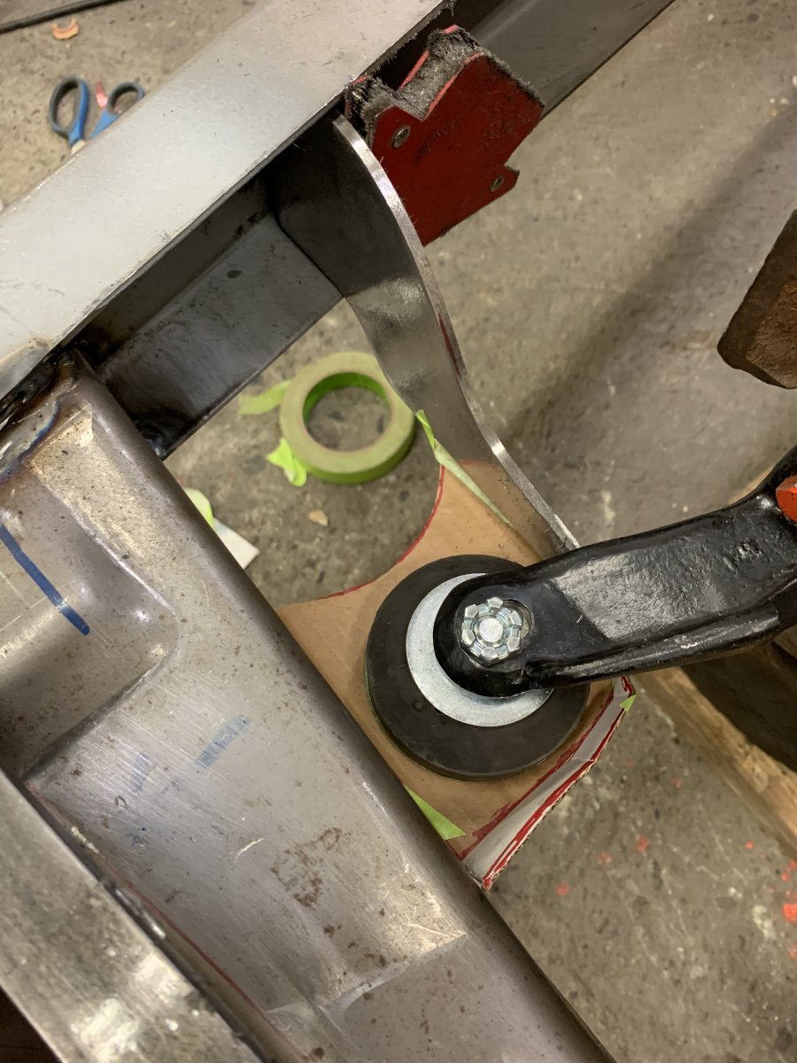

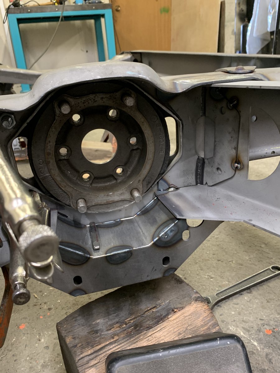

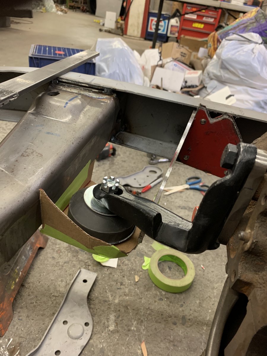

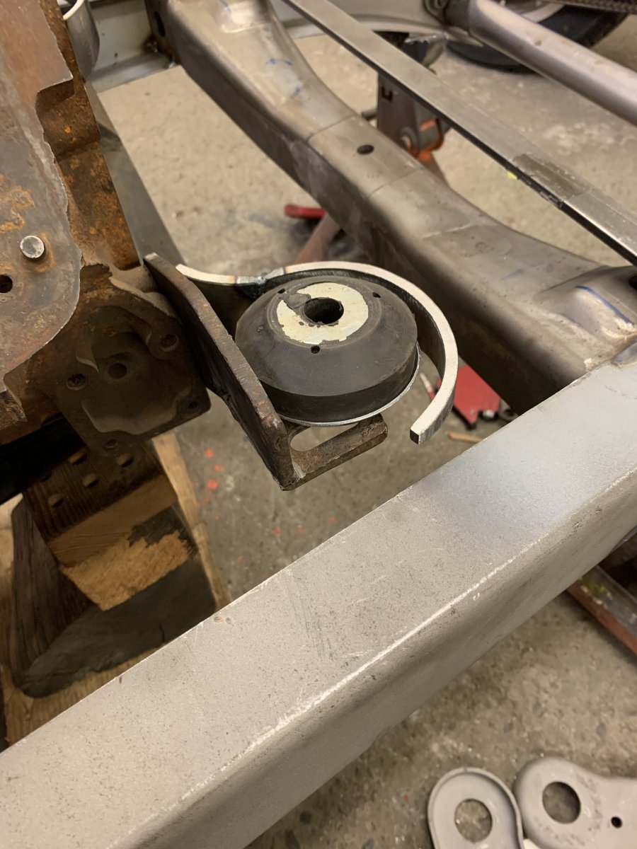

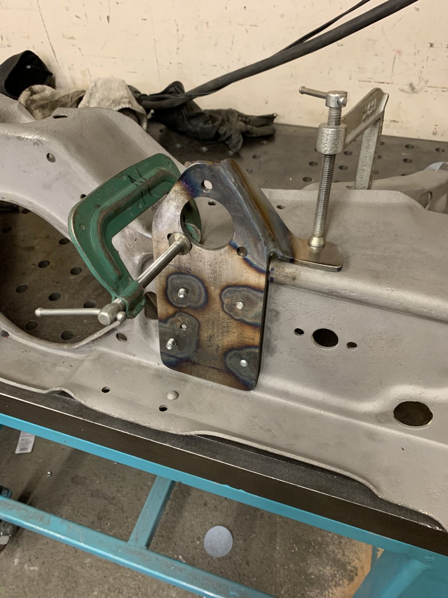

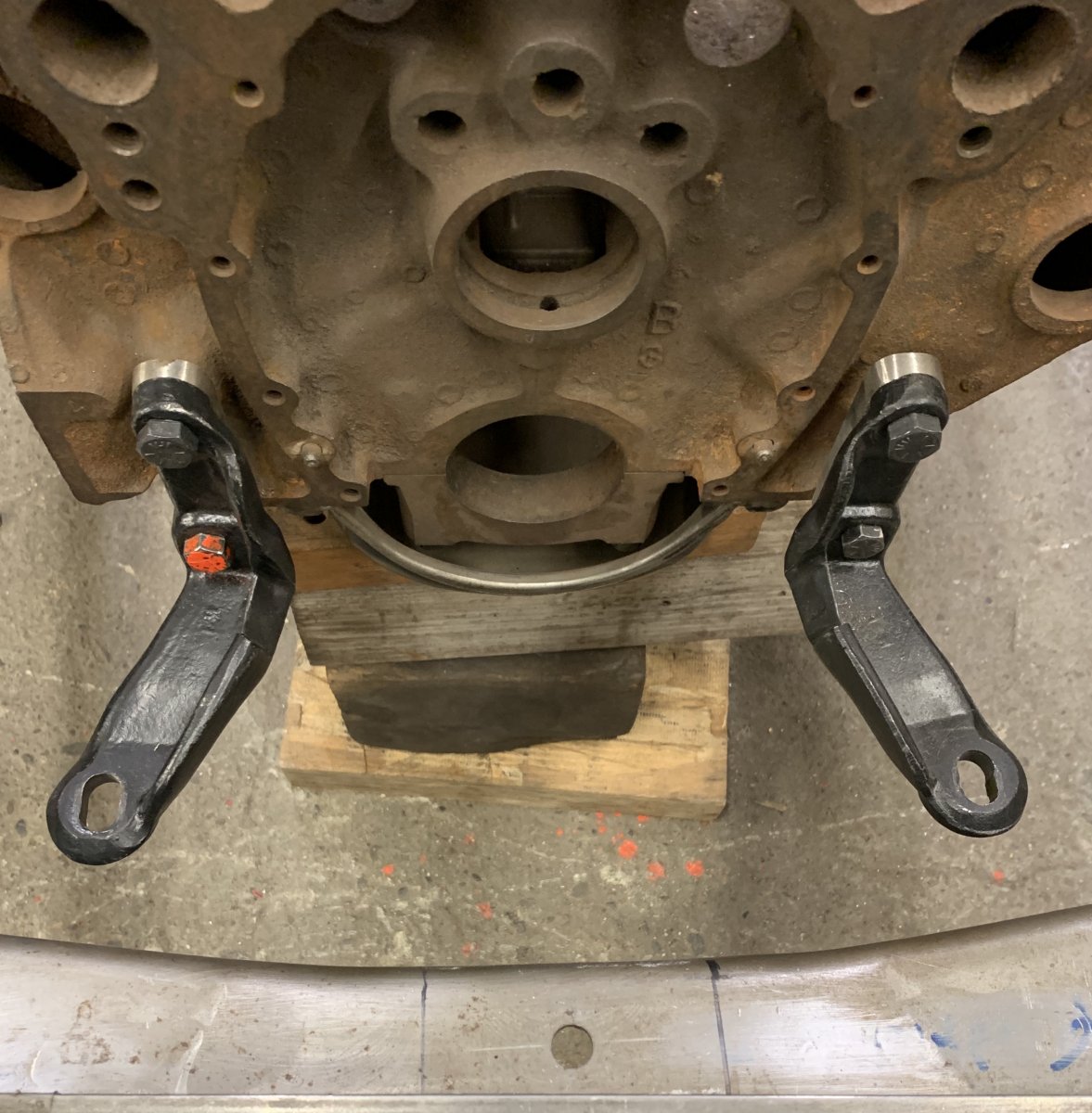

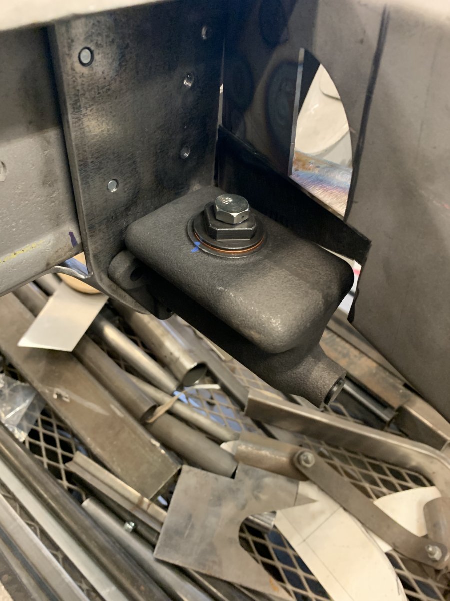

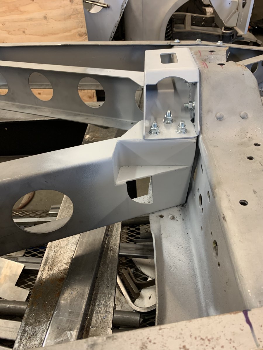

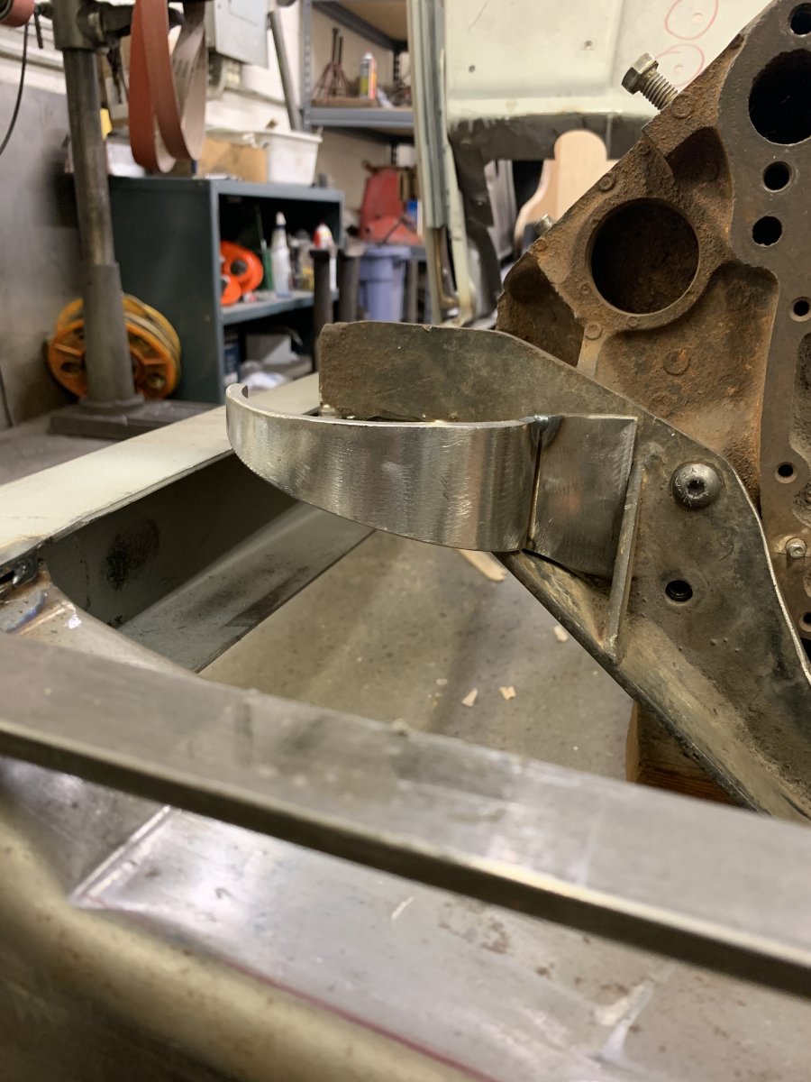

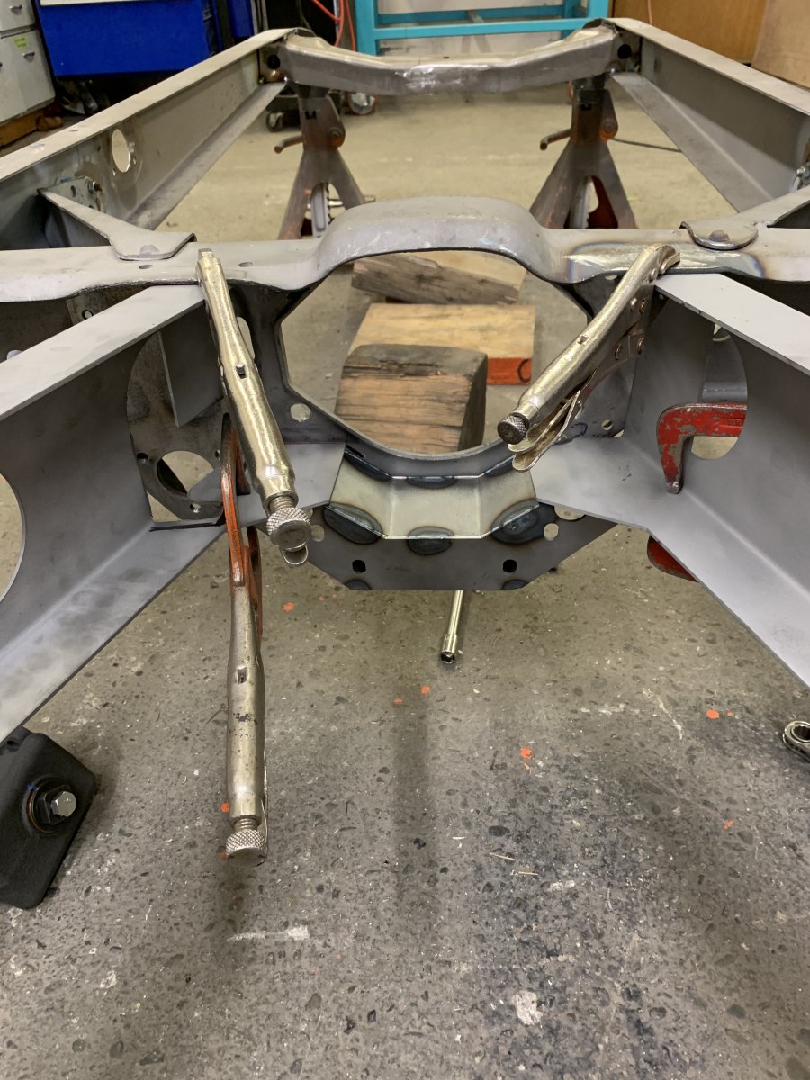

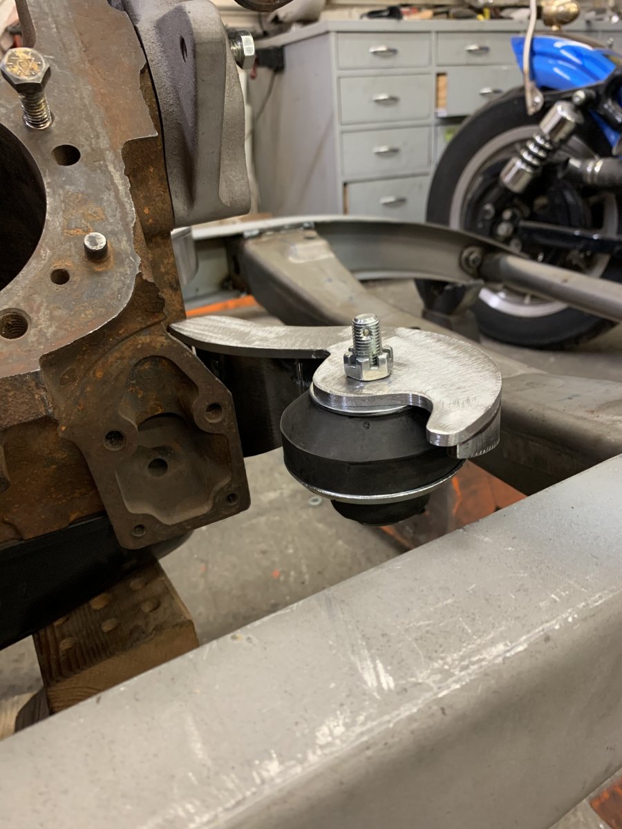

    No by this time I was kind of a little panicky over how to approach the motor mounts. my first thought was 32 v8 mounts and modify the model A style crossmember. That wasn’t happening . I couldn’t find a simple trick solution. Next I’ll show you a hurst style idea. Spoiler alert, I did not use that one either. 5B189629-DDA8-4298-8FCB-E3B24D7481CE.jpeg B547C6A7-875E-4960-A825-68F044D90E58.jpeg DD358B9E-8FF1-46DD-8EBB-74F541F2C1AC.jpeg 44C184DD-1F13-47F6-9CB5-8E429653EC0C.jpeg 1B377BE7-E0B2-4908-B388-EEB3747DEA16.jpeg B3355E34-15C9-4192-8758-65DAB41E6B34.jpeg 5B189629-DDA8-4298-8FCB-E3B24D7481CE.jpeg B547C6A7-875E-4960-A825-68F044D90E58.jpeg DD358B9E-8FF1-46DD-8EBB-74F541F2C1AC.jpeg 44C184DD-1F13-47F6-9CB5-8E429653EC0C.jpeg 1B377BE7-E0B2-4908-B388-EEB3747DEA16.jpeg B3355E34-15C9-4192-8758-65DAB41E6B34.jpeg 5B189629-DDA8-4298-8FCB-E3B24D7481CE.jpeg B547C6A7-875E-4960-A825-68F044D90E58.jpeg DD358B9E-8FF1-46DD-8EBB-74F541F2C1AC.jpeg 44C184DD-1F13-47F6-9CB5-8E429653EC0C.jpeg 1B377BE7-E0B2-4908-B388-EEB3747DEA16.jpeg B3355E34-15C9-4192-8758-65DAB41E6B34.jpeg

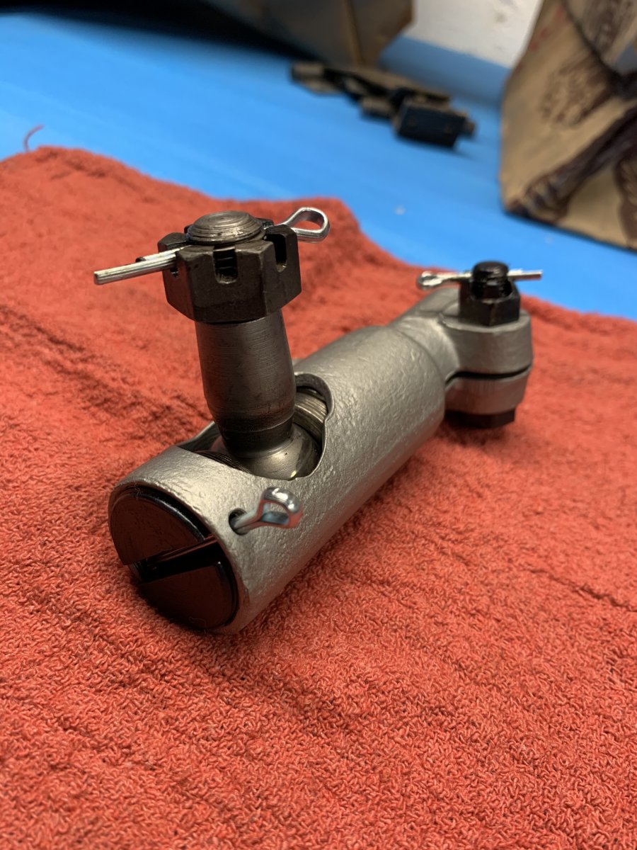

  22. heyitsnate
    Joined: Apr 8, 2004
    Posts: 1,750
    heyitsnate

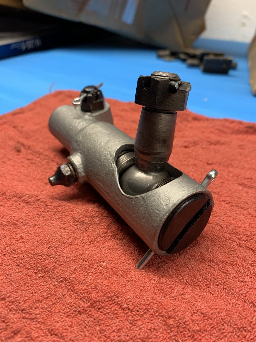

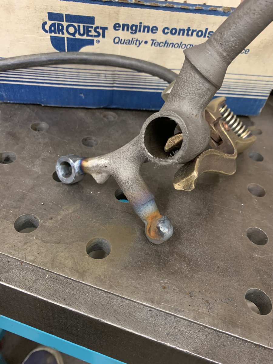

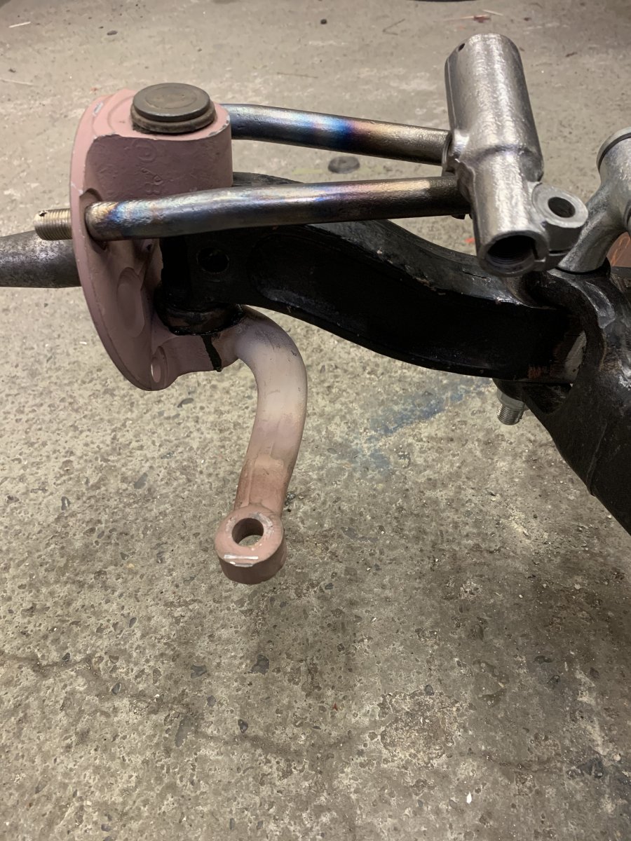

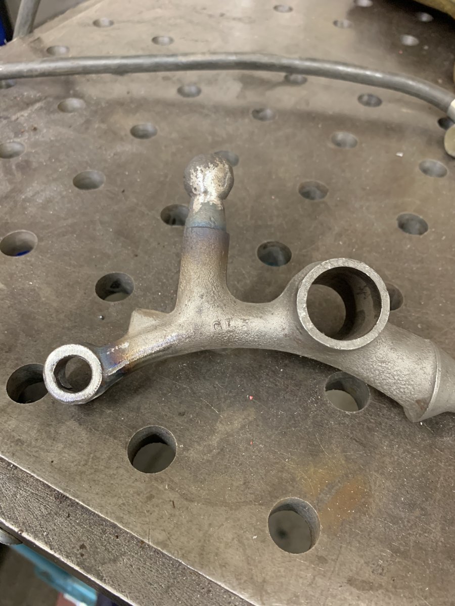

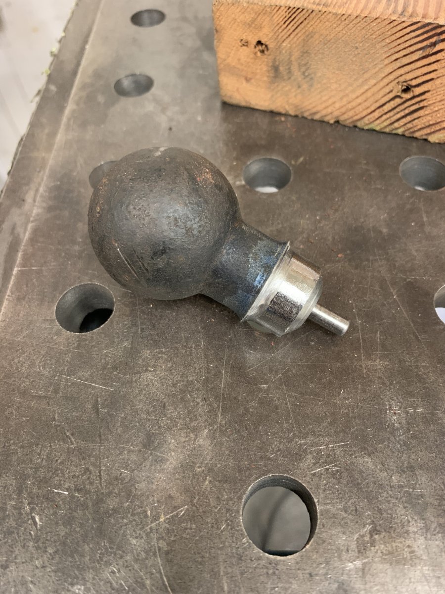

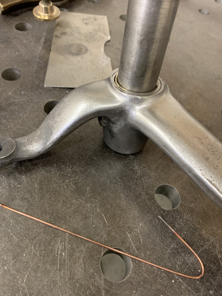

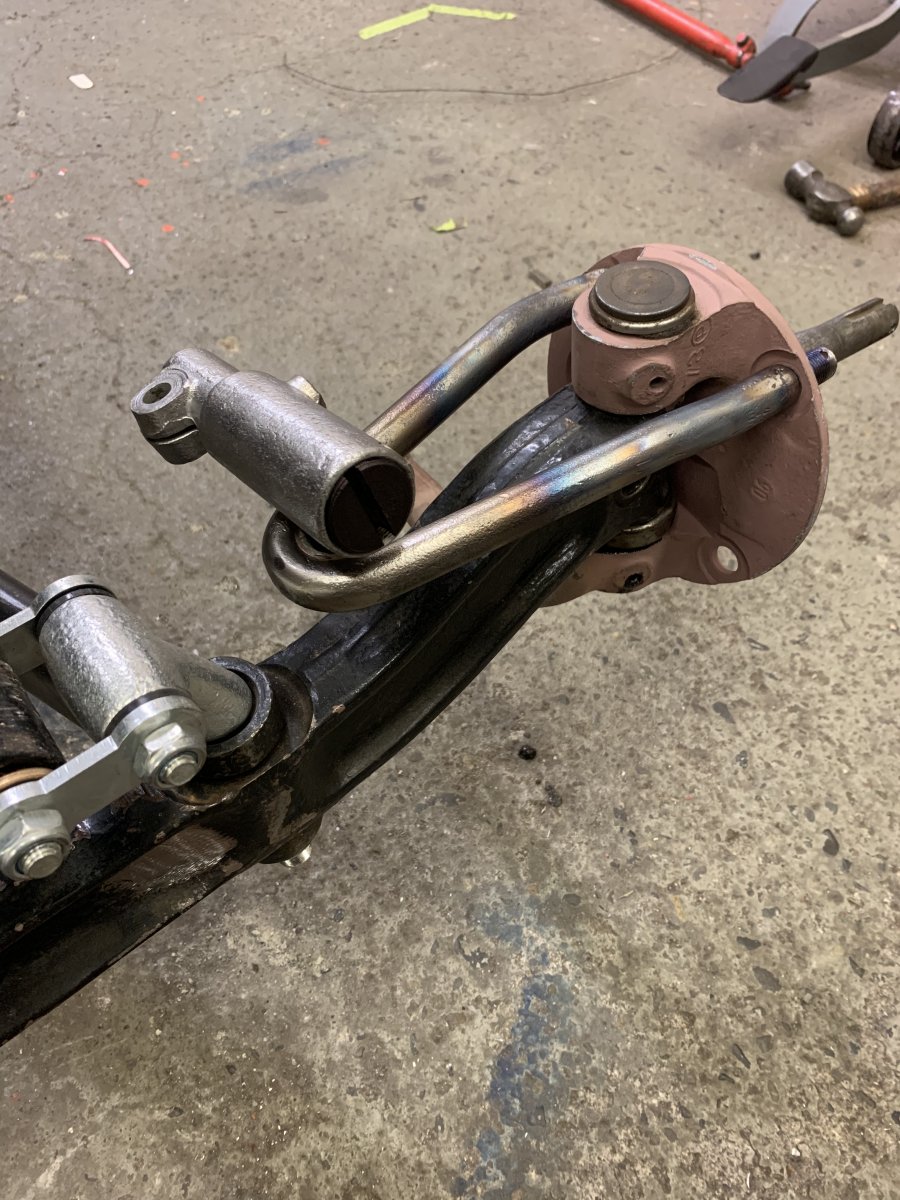

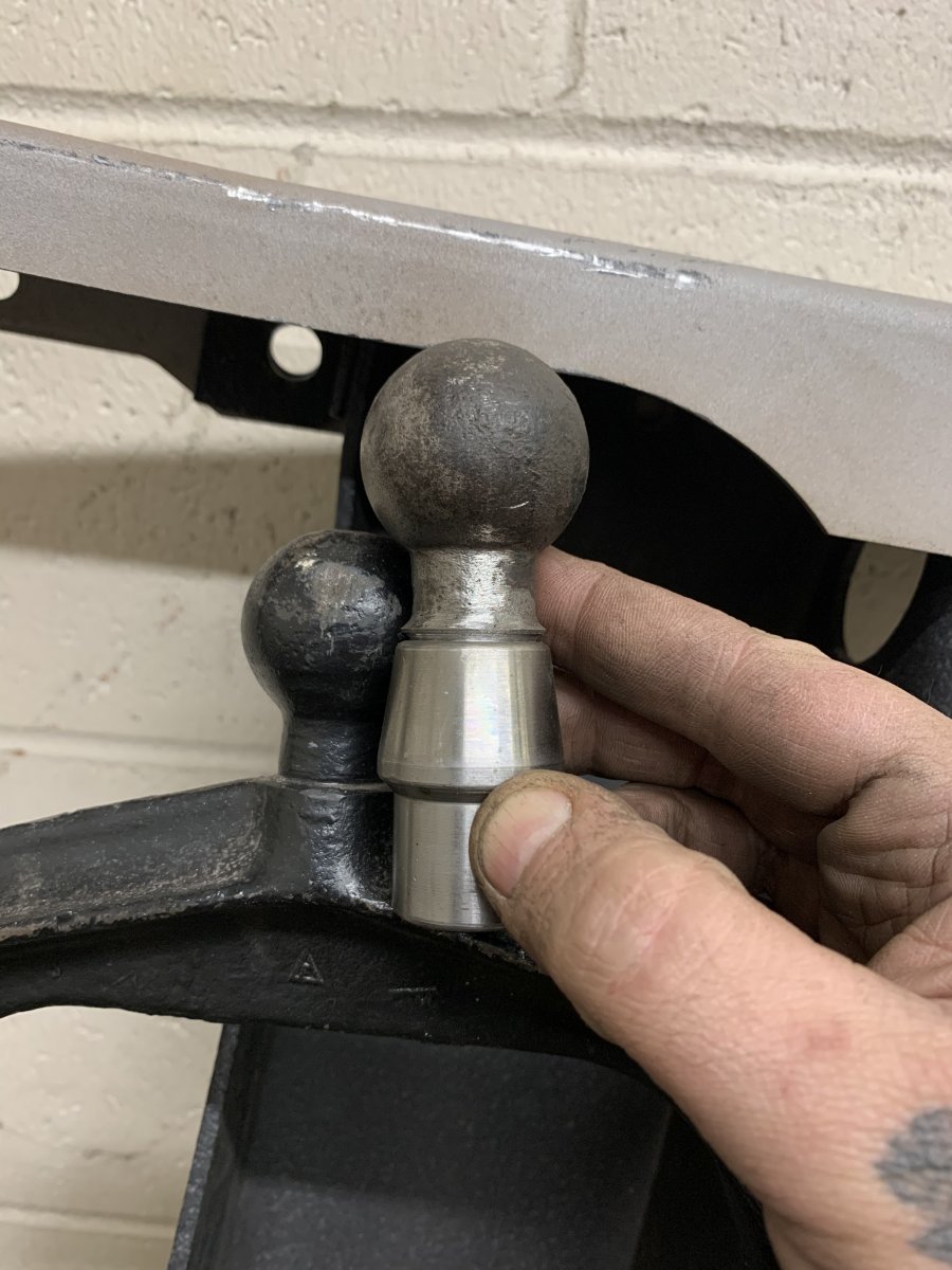

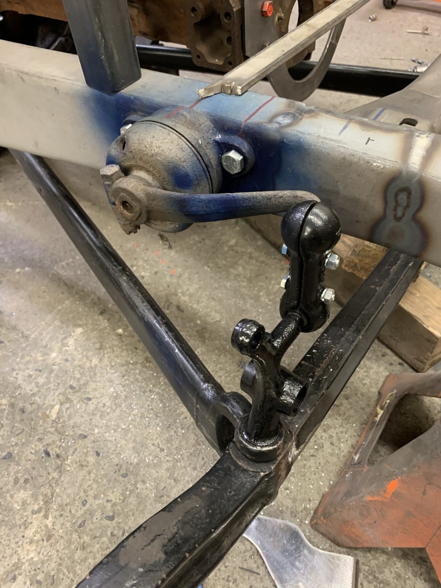

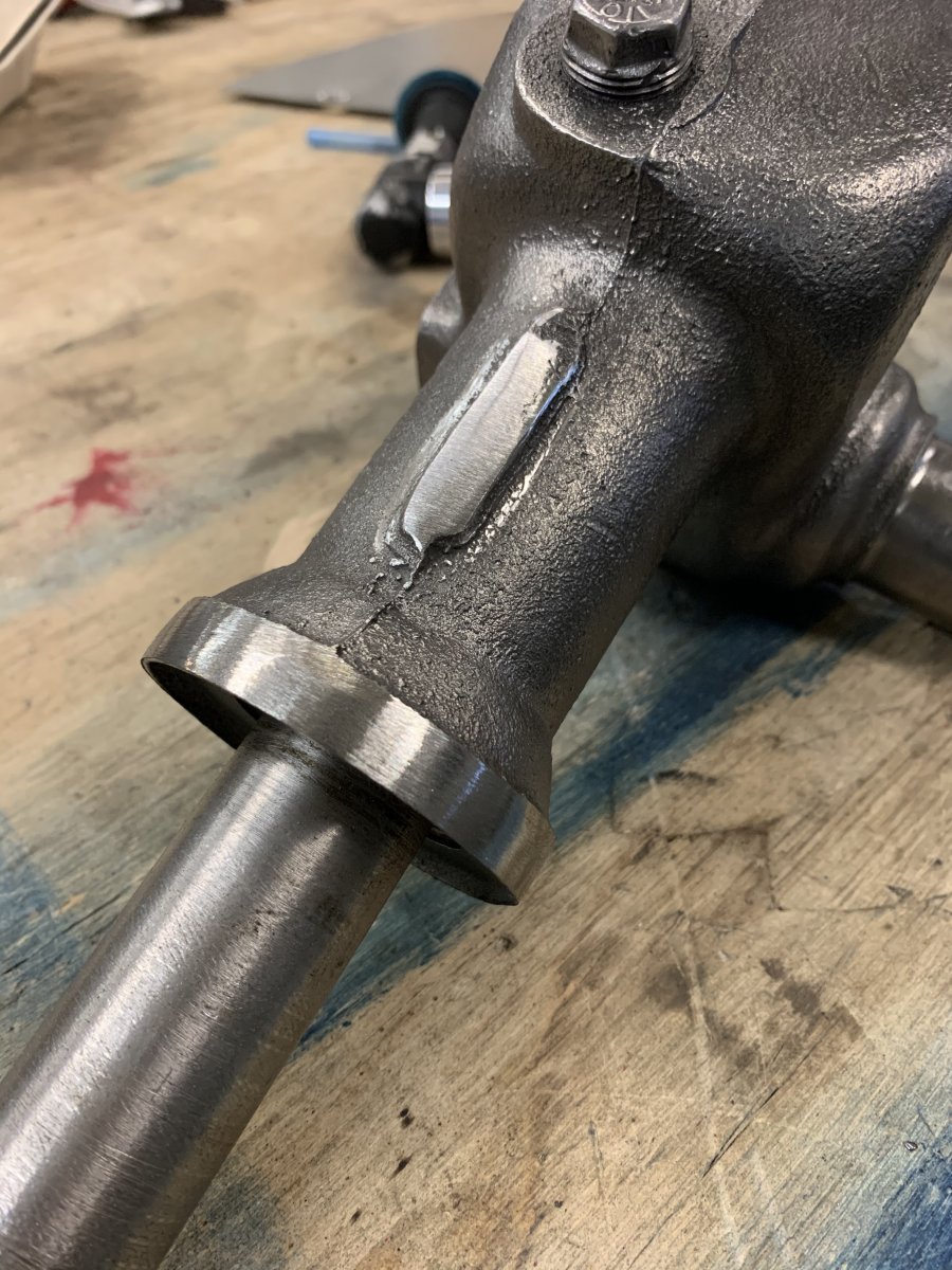

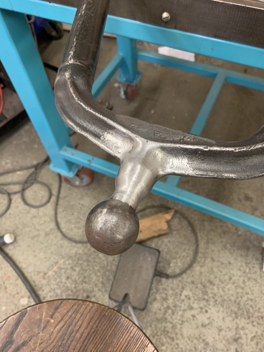

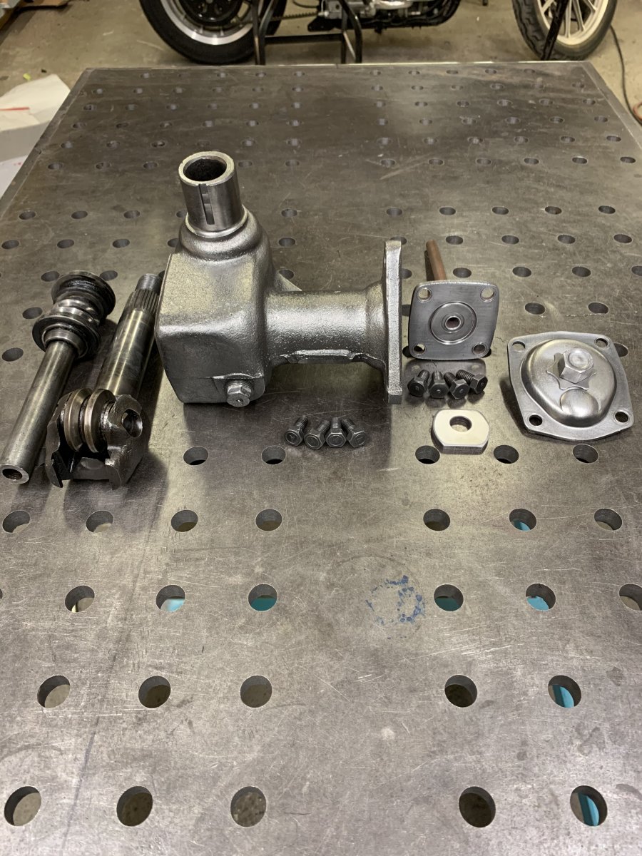

    Put some finish on my steering box and rod ends. 8B39804B-1938-4CE1-B503-70A177C03827.jpeg 4915A924-05DB-4D5F-A0A1-2751E0EB2397.jpeg F357C88C-F7D9-4680-ABFF-6041C7277FEB.jpeg

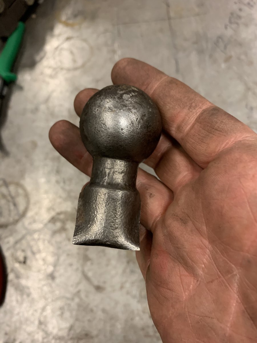

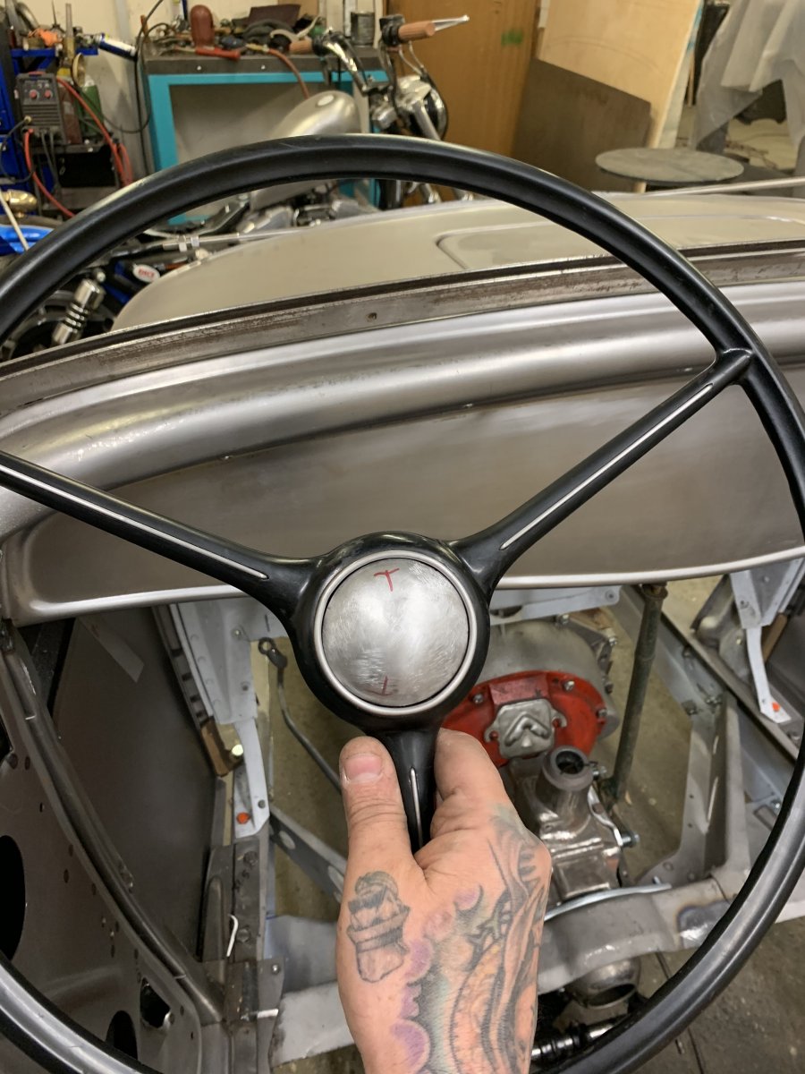

    I found a 1930s chevy steering wheel on eBay. The pictures were terrible but I could make out some stainless or chrome trim in the spokes. Never seen that before and the price was right so I pulled the trigger. It turns out it’s 37 chev standard and it s really nice , and I’m excited to use it! I ordered a horn button, but it was wrong sized, so I made one. I found an nos Chevy steering shaft too, so I grafted that into my steering box . 3D460235-87B8-4554-BF34-9A1F03EF599B.jpeg E980512A-6F47-4B4F-871E-E507544A7737.jpeg

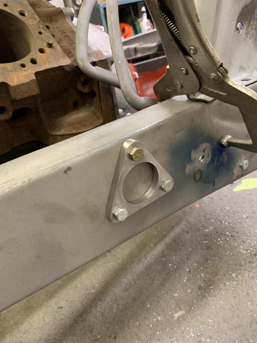

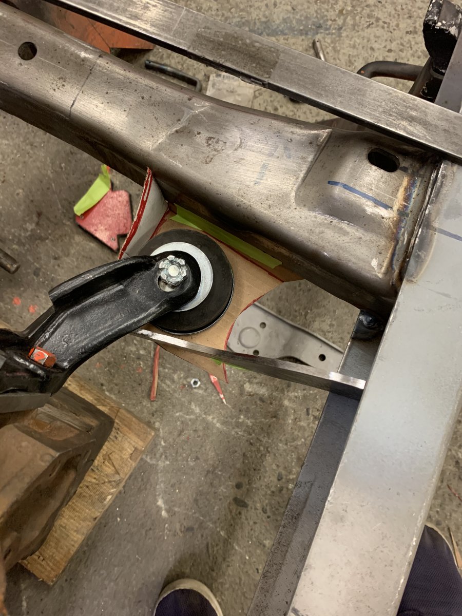

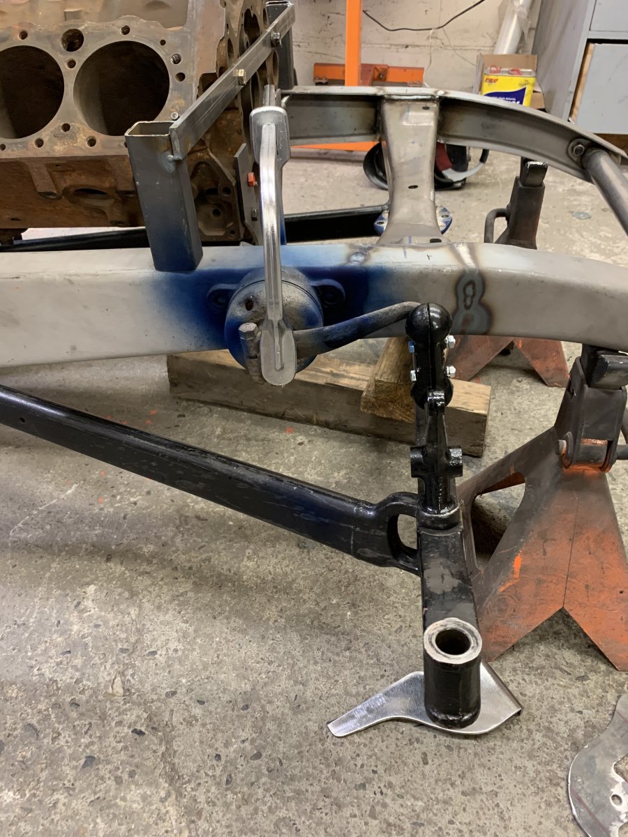

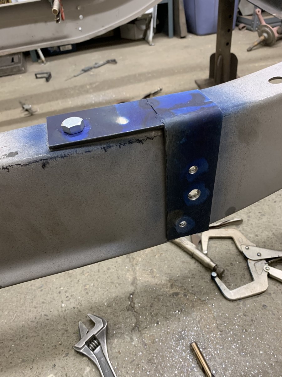

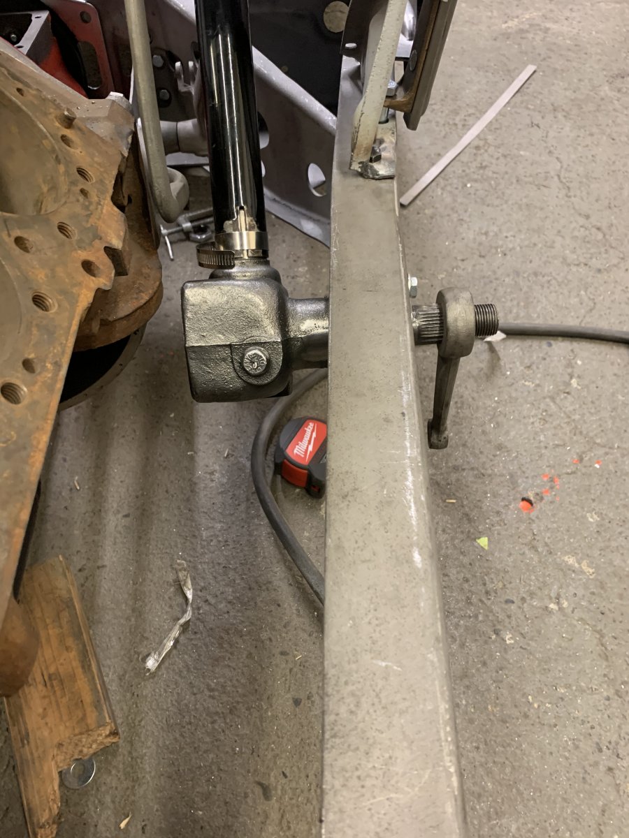

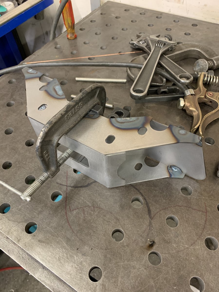

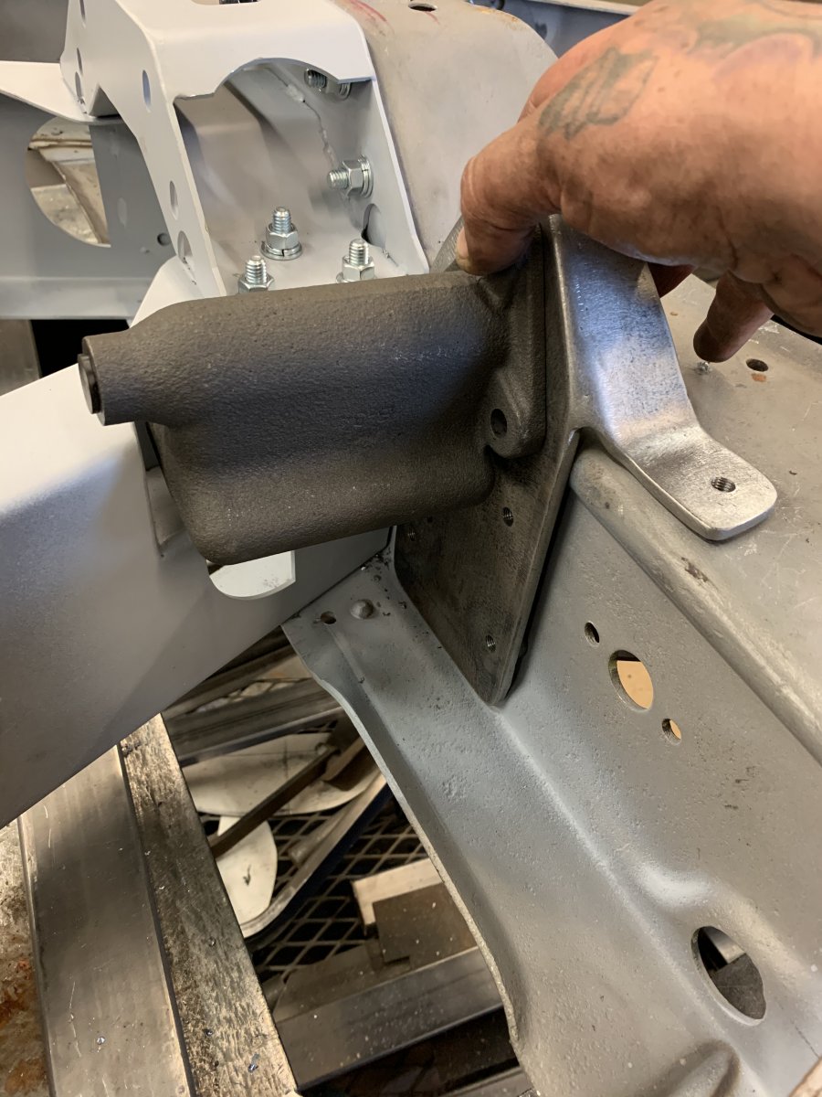

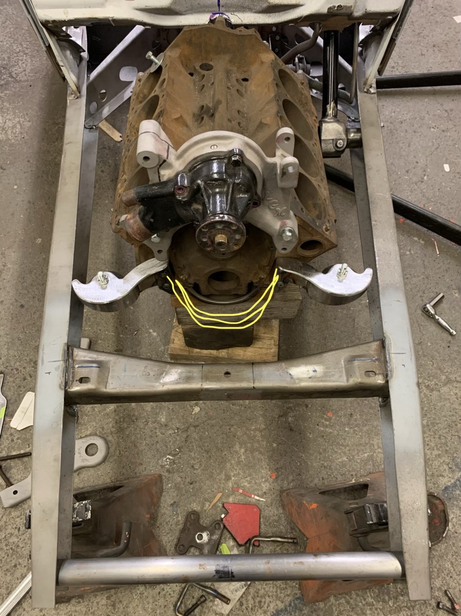

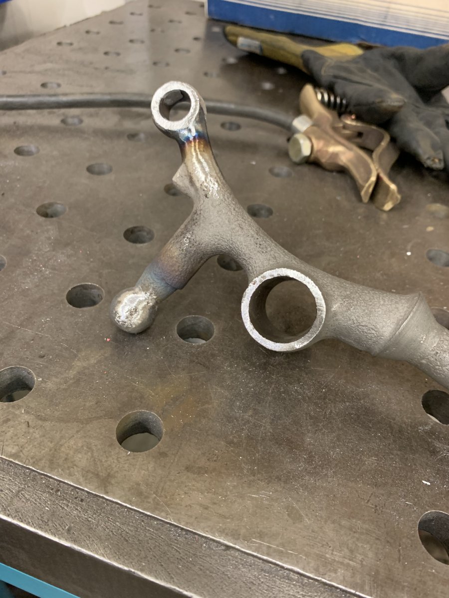

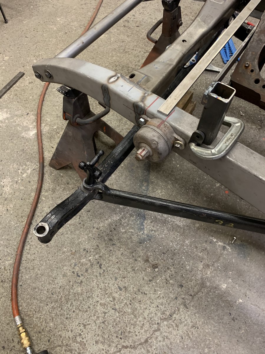

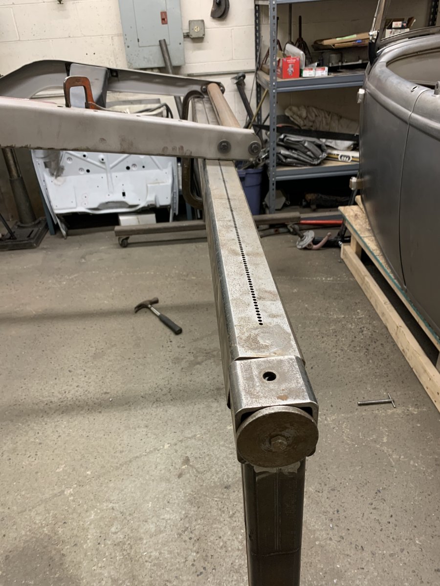

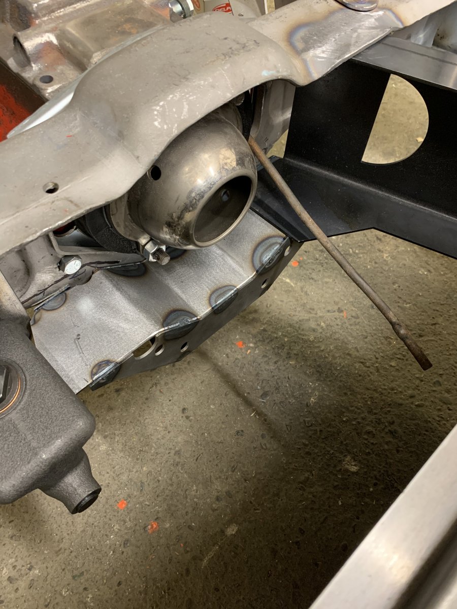

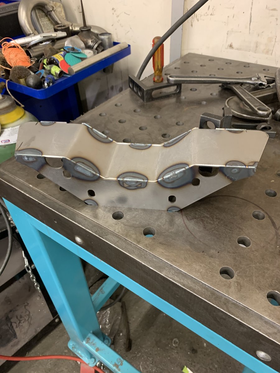

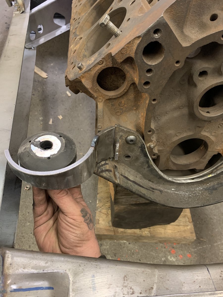

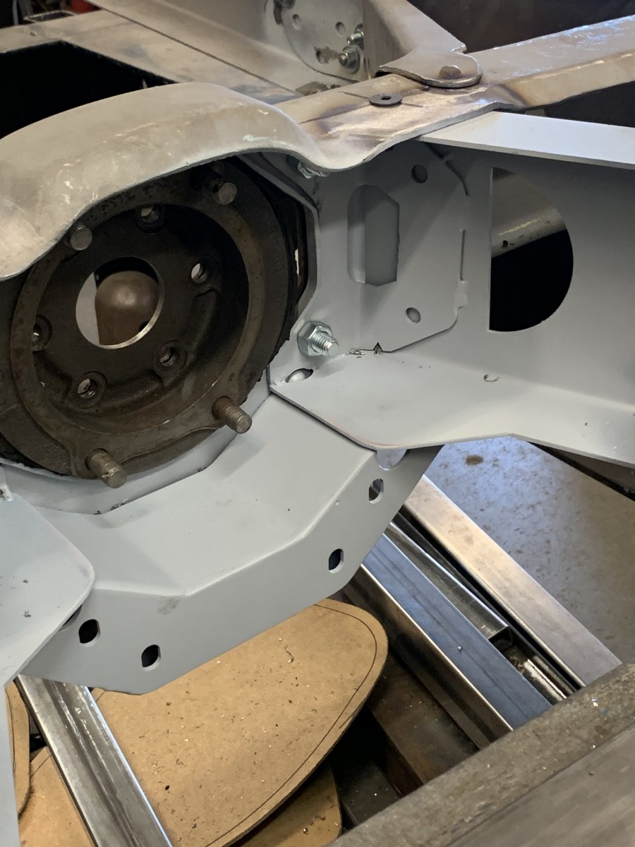

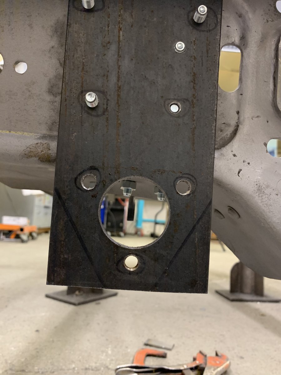

    So now that I have my frame home it’s time to get serious about having a roller. I was fortunate to find some 32 shocks, but finding I would need to partially box my frame for motor mounts , access becomes an issue. I made some threaded weld bungs and welded them inside my frame first. You can kind of see the simple fixture to hold the motor in place also . 2B50F99B-8AA5-4E22-B309-D3825F005D05.jpeg 13DE2493-8D7A-44F2-89AC-2F0377D0AFEB.jpeg A5EDDB92-4121-41C5-B089-0CC640369D9B.jpeg
  28. heyitsnate
    Joined: Apr 8, 2004
    Posts: 1,750
    heyitsnate

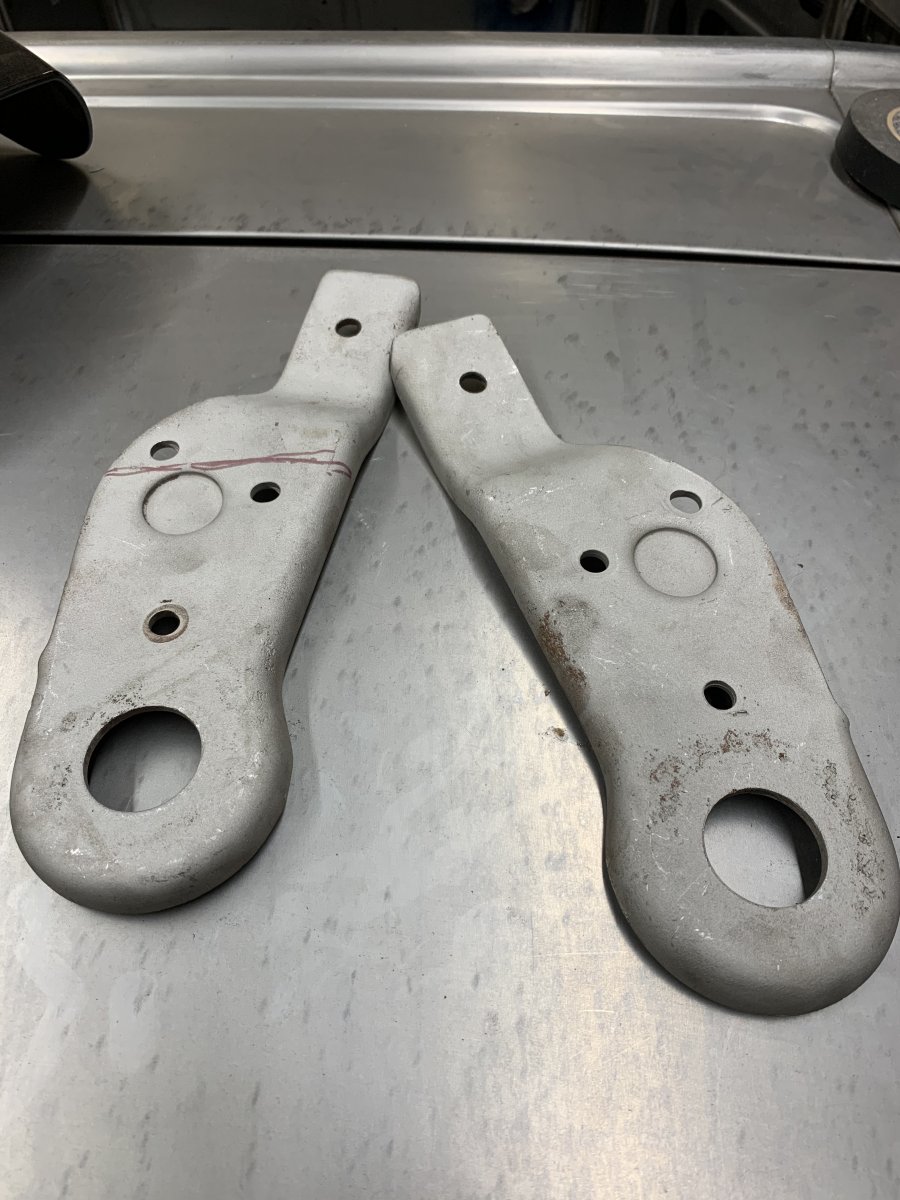

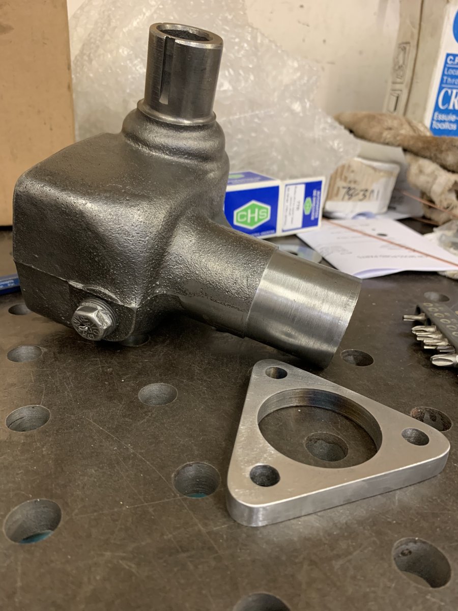

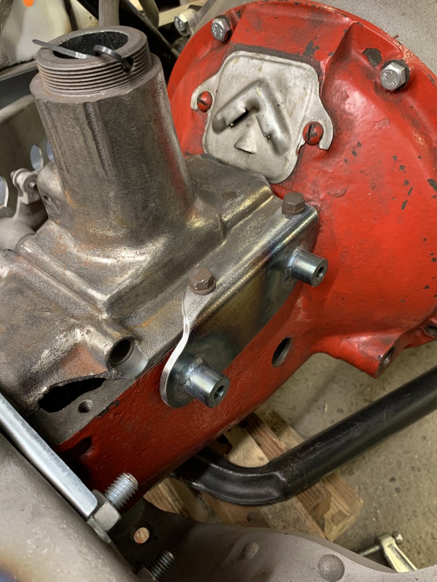

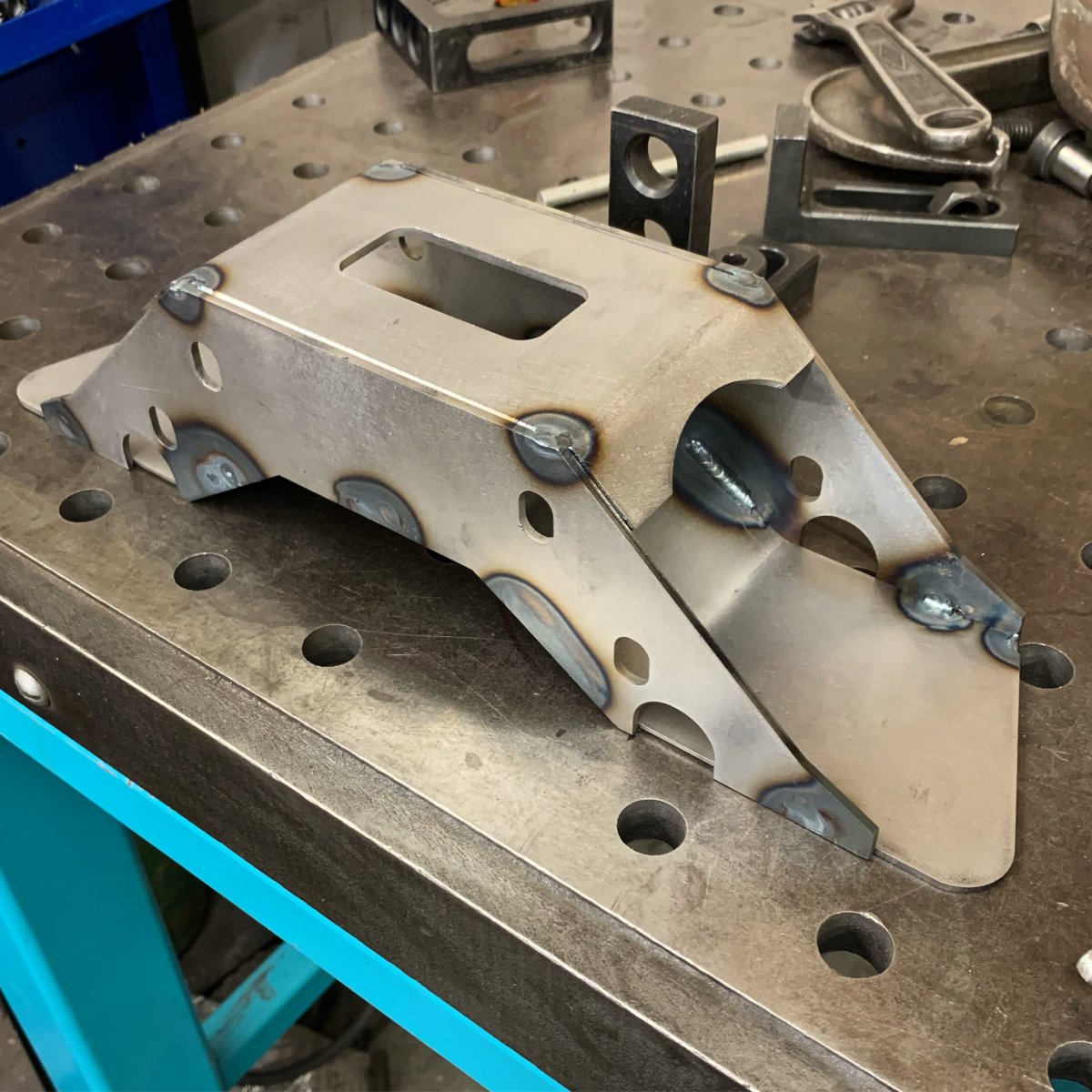

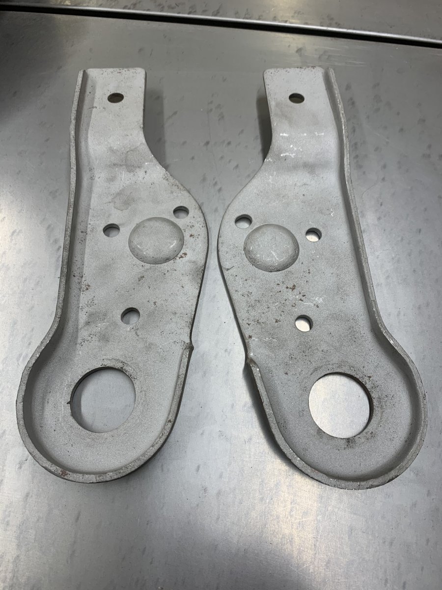

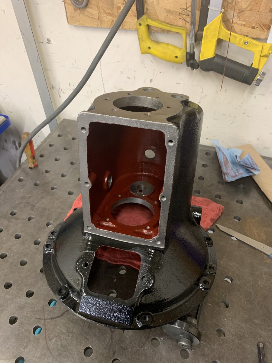

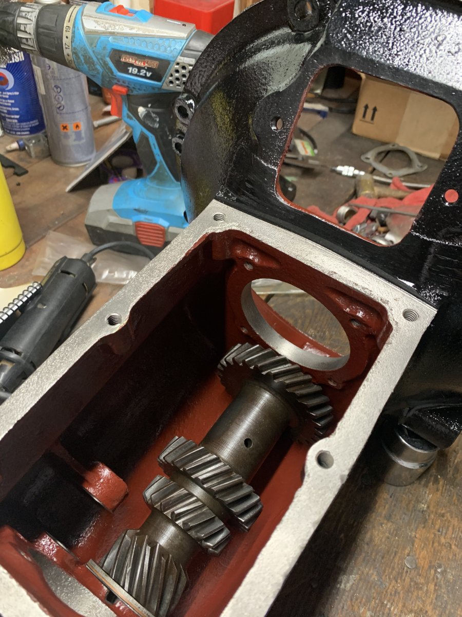

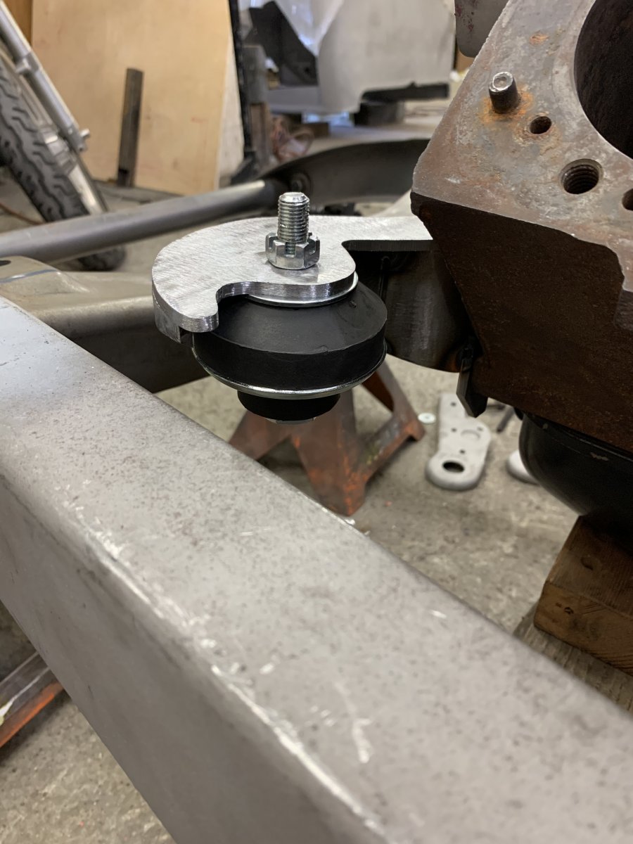

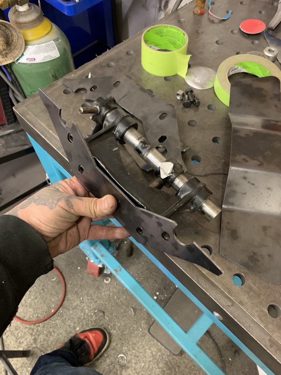

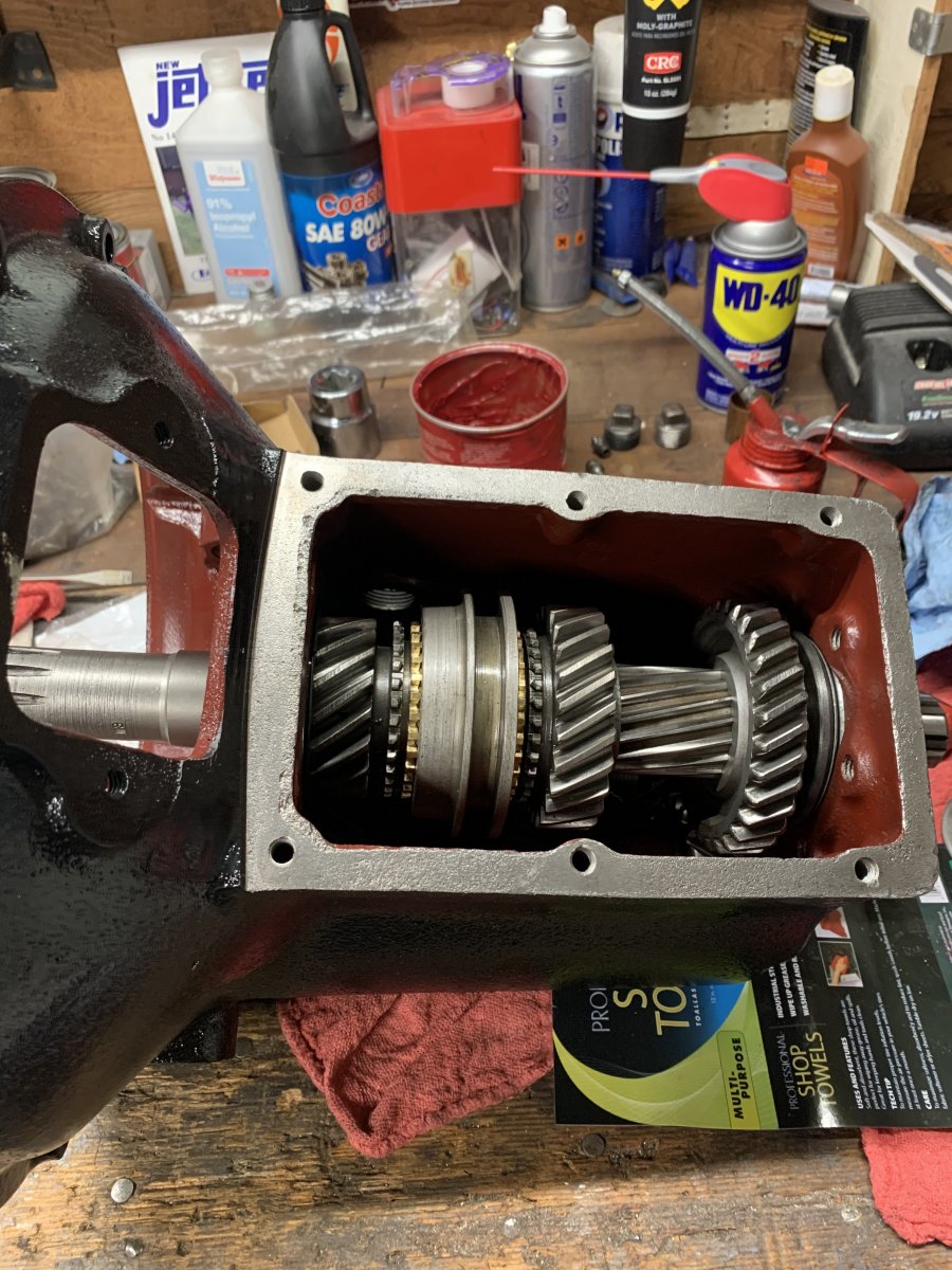

    A long time ago I got a 35-40 frame and it had these neat v8-60 adapters. I planned to use these, and figured I’d just do a hurst mount and these. Nice and simple, except hurst mounts don’t allow you to use a mechanical fuel pump, so I just went ahead and made my own hurst mount after I finished the boxing plates. 29F52E45-26BB-46A0-A034-6555D82D0450.jpeg 36CE214E-6F77-4AFE-90E1-14CB3A0095FE.jpeg Pics to follow.
