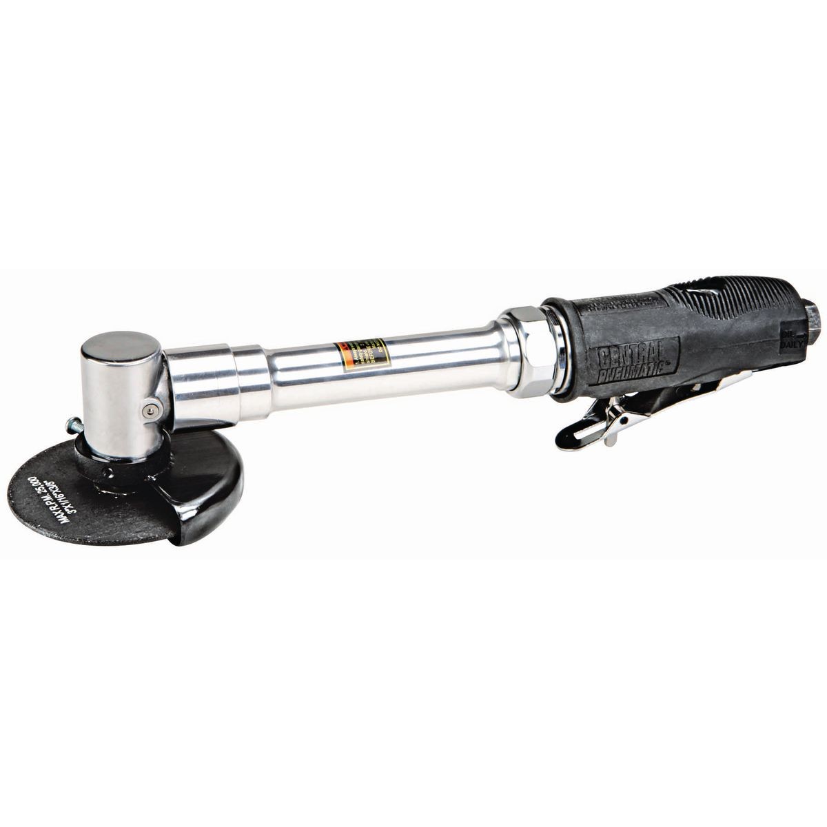

    So there’s this,
    Air powered, great for getting into sticky tight situations and easy to handle. For certain 1 handed operation out of position and no real issues when it jams.
    Running this on edge over sheet metal bodywork welds gives brain surgery Like precision. But if the weld is high as Mount Everest it’s not the grinder or a better grinder that will fix it. When it comes to bodywork, it’s the high spots that that eat time, set the pace, establish the line. Don’t make high spots with your welding wire.
