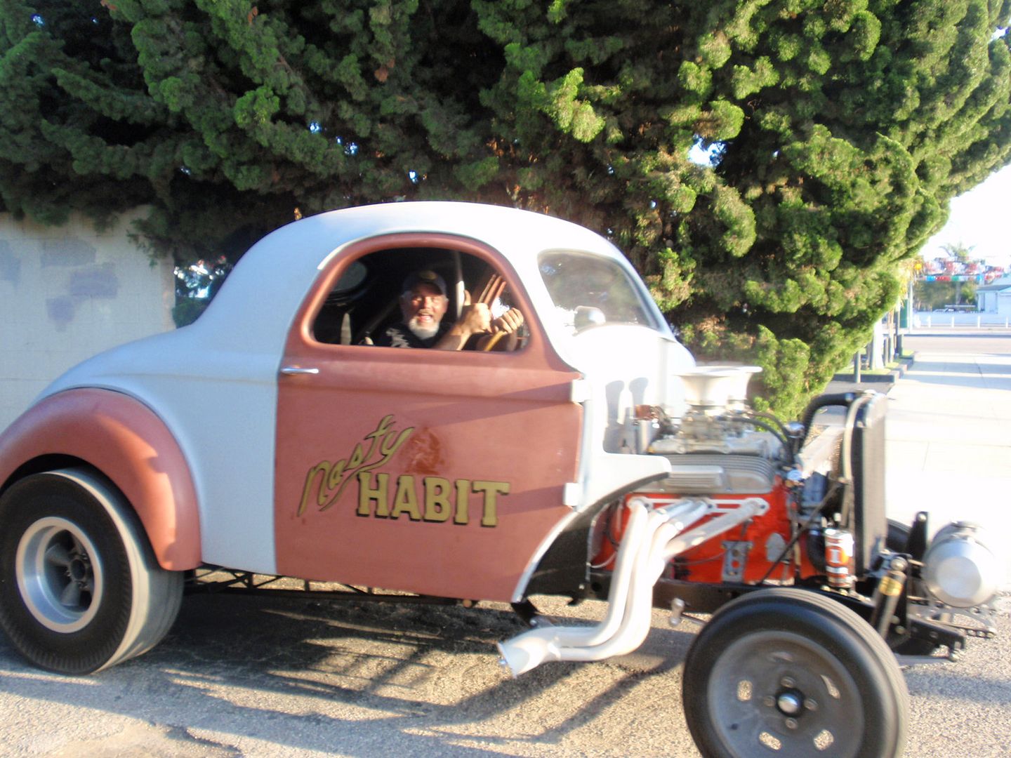

  1. Took our first test drive today. Pretty exiting but it was a short one, more on that later......

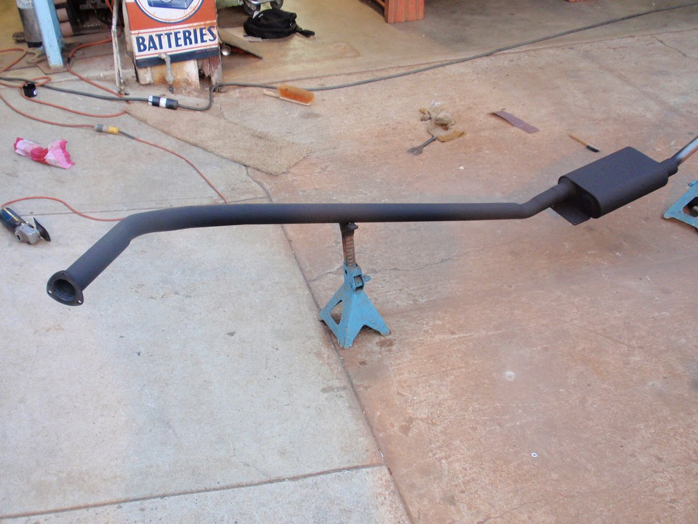

    I had a pair of swap meet Flowmaster mufflers ($40pr) so decided to use them, I mounted them behind the rearend and used 2 1/2" tubing to connect to the collectors. I had the muffler shop guy add a couple of bends and then I cut, fit and welded until everything was where I wanted it. Then I wiped em down real good scuffed em up and sprayed on some VHT black.

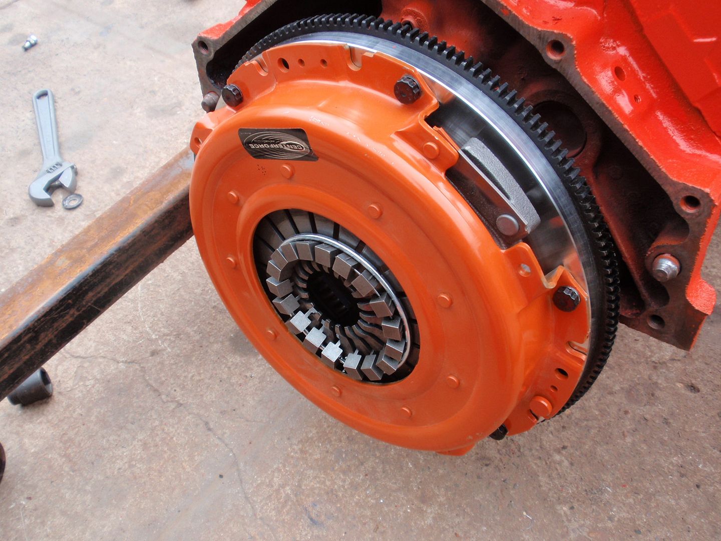

    I stepped up and bought a brand new steel flywheel and Centerforce 11" clutch and pressure plate. I plan on abusing it. I really wanted a McLoud dual disc setup but when I found out the price it reminded me that I can never have the shit I really want.

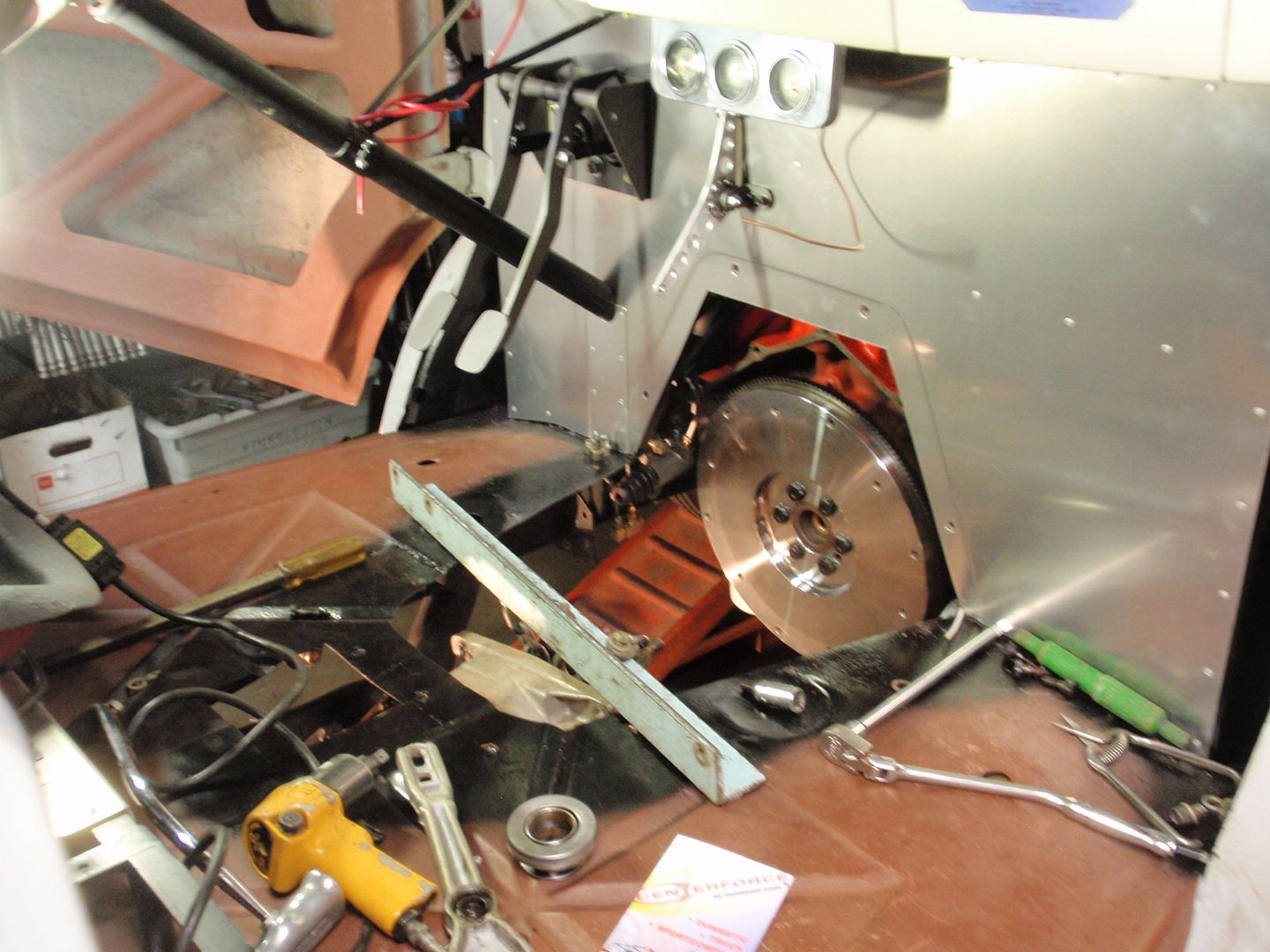

    In she goes....

  3. monster

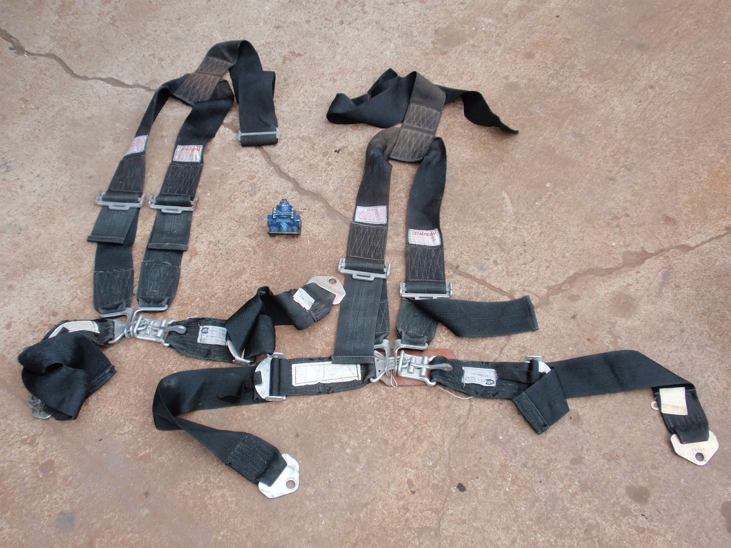

    Here are some more donated parts from cool friends. Simpson belts for workmate Perry and a Holley blue fuel regulator from Vic young..

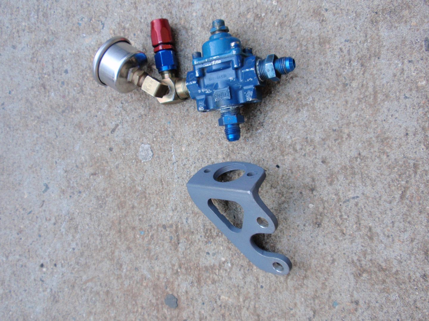

    So when I started planning my fuel system and was getting ready to order some fittings and hose and my friend Mike from work (who roasts the pig at our BBQ) says I'd better look through his left overs first, well that sure worked out great because 80% of what I needed was right there.
    I made this bracket to mount the regulator....

  12. There have been hiccups along the way. First my super duper Mallory fuel pump quit on me. I think maybe it needed a bypass line back to the tank, anyway Perry came through with a Carter electric pump and we were back in business. Now my clean braided fuel lines in the trunk became a patchwork of rubber hoses but it worked good. Of course the first fuel pressure gauge leaked and the brand new replacement refused to read anything over 2 pounds, I know there was more than 2 pounds because I had one of the carbs apart about 4 times today and the problem turned out to be too much fuel pressure. So it fired up and ran OK so I couldn't wait to take it for a slow cruise up the street. Shifter is adjusted and clutch works good, I pull into the alley and then turn up the street when I shifted from first to second the clutch felt good but there was no second gear. Put it back in first but nothing. No weird noises or anything, clutch seemed to work good. So my neighbor Jerry from 2 doors up (awesome machinist) helped me push it back to my back yard and we tried to figure it out. Everything seemed normal. So jerry left as my friend Daniel pulled up in his 56 Nomad. Next thing you know we had it up on my rack;) and had the tranny out, then the scattershield off and still nothing obvious. For some reason the pressure plate hadn't returned to position and came back as we unbolted it, weird. I will call Centerforce tomorrow and see what I can find out. Sure glad I designed this thing so you can get to the clutch easily.
