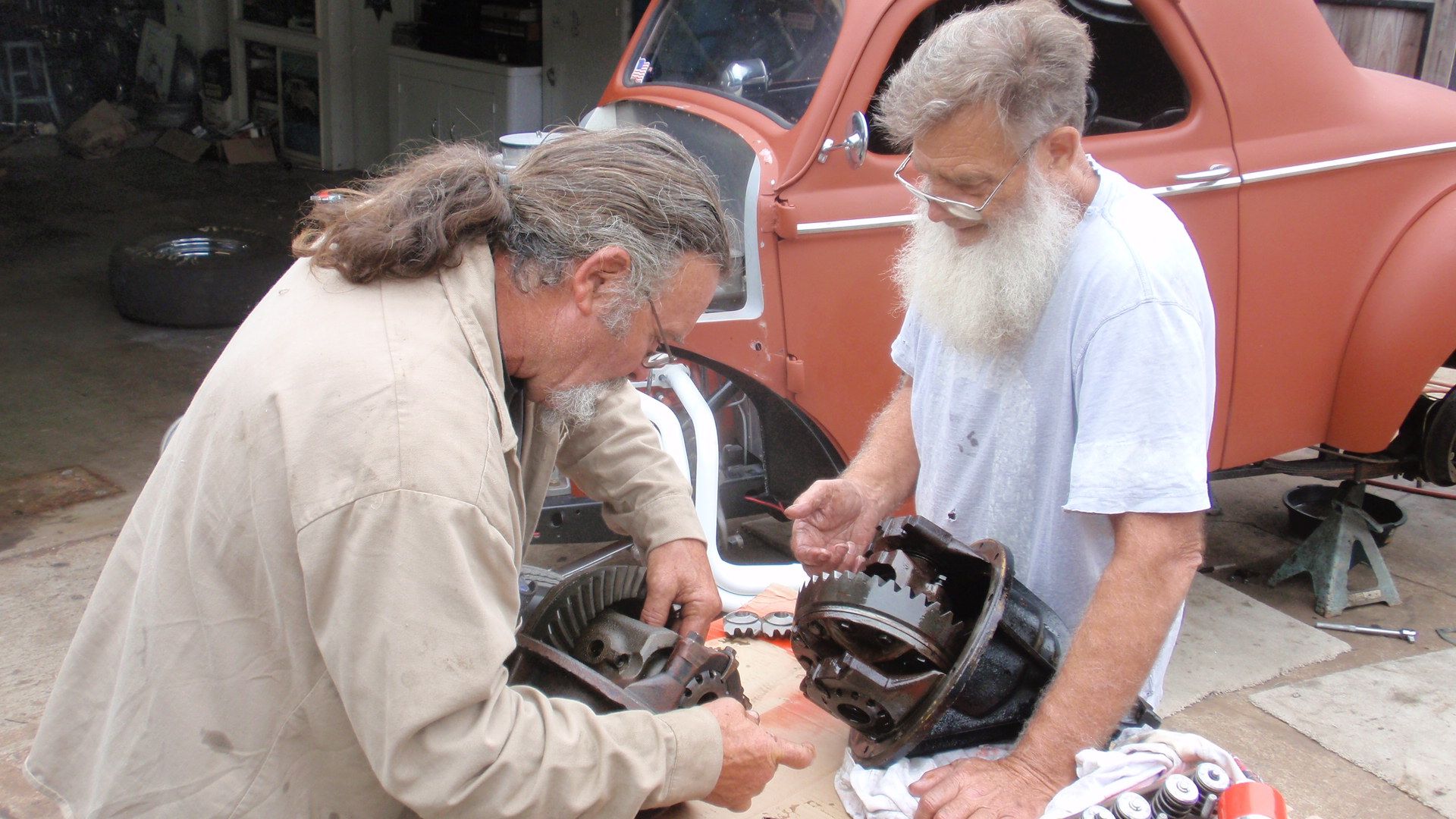

  10. My friends Perry and Jim helped change a few things on Saturday. I was more like a spectator as I was having a rough day that started with a visit to the emergency room for an unstoppable nose bleed. With a balloon stuck in my nasal cavity and heavy pain pills to help with the sinus headache caused by the balloon I was not much help.
    We were going to change the valve springs because it won't rev much over 5,000 RPM (floats the valves). After adjusting the valves and a test run it was obvious the 5.57,s just weren't going to work with an engine that won't rev. I had a 4.56 open 3rd member that was 31 spline. 4.56's would get me down the track further between shifts so we stripped the spider gears from the 5.57 and put them in the 4.56. Lucky thing we did because the cross shaft had snapped.We decided against changing the springs because the springs I have are too strong for the non screw in studs on the 327 and I didn't want to deal with the problems that could cause,ripped out studs, flat cam lobes etc. Limited funds prevent me from having all the parts I know I need, I just do what I can with what I have.
    Took another test drive and the gearing felt better but I really did like driving it with the 5.57's. I will miss the jump and the wicked 1-2 shift. I still wasn't pulling strong so we messed with the timing and checked the float levels. We made some improvements but it still isn't quite right. It should be good enough for a few fun runs at the H.A.M.B. drags! What it needs (obviously ) is a matched cam and kit. I have some nice ported out power pac heads with 2.02 valves so they can go on at the same time.....one day.
