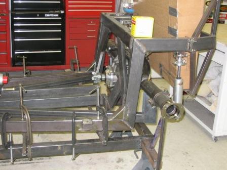

  19. AHotRod
    Joined: Jul 27, 2001
    Posts: 12,216
    AHotRod
    I fabbed my own 'truck-arm' rear suspension for my shortened-A-sedan.
  20. flynj1
    Joined: Mar 4, 2001
    Posts: 583
    flynj1
    from C.B. IOWA
    Be carfull building box tubing trailing like this. The chevy PU arms were built out of two c chanels to alow for some flex during body roll. Boxing them wont allow flex and sooner or later something gota give and probly without warning

  25. ray
    Joined: Jun 25, 2001
    Posts: 3,791
    ray
    from colorado
    that just isn't true! this setup works regardless of what you make the arms out of. because the front mounts are very close together, the triangualation makes for very little flex where the control arms bolt to the axle, yet the suspension articulates freely. also the longer the arms the less flex at the axle.

  27. Hackerbilt
    Joined: Aug 13, 2001
    Posts: 6,254
    Hackerbilt
    The binding the guys are thinking of would come from the stiffness of the tubing arms, combined with the distance between the front joints and the solid connection to the axle itself...not the actual type of joint at the front.
    Considering the amount of movement a car rear axle would see I can't imagine tubing being a problem...as long as the front joints were close together of course.
