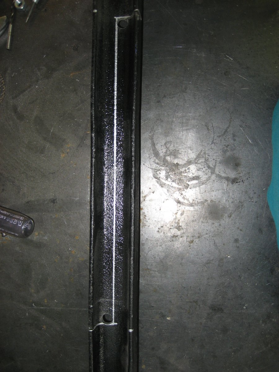

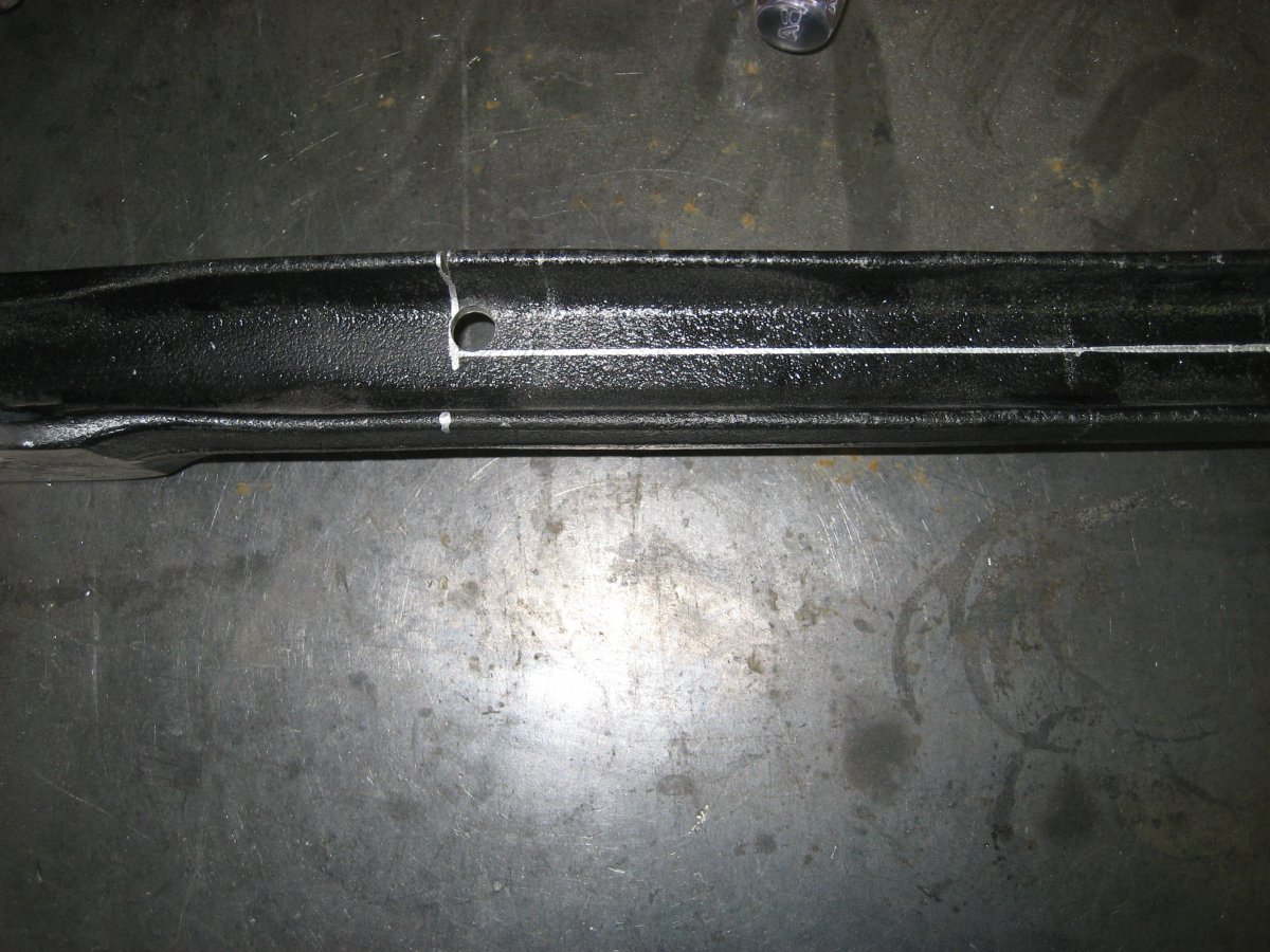

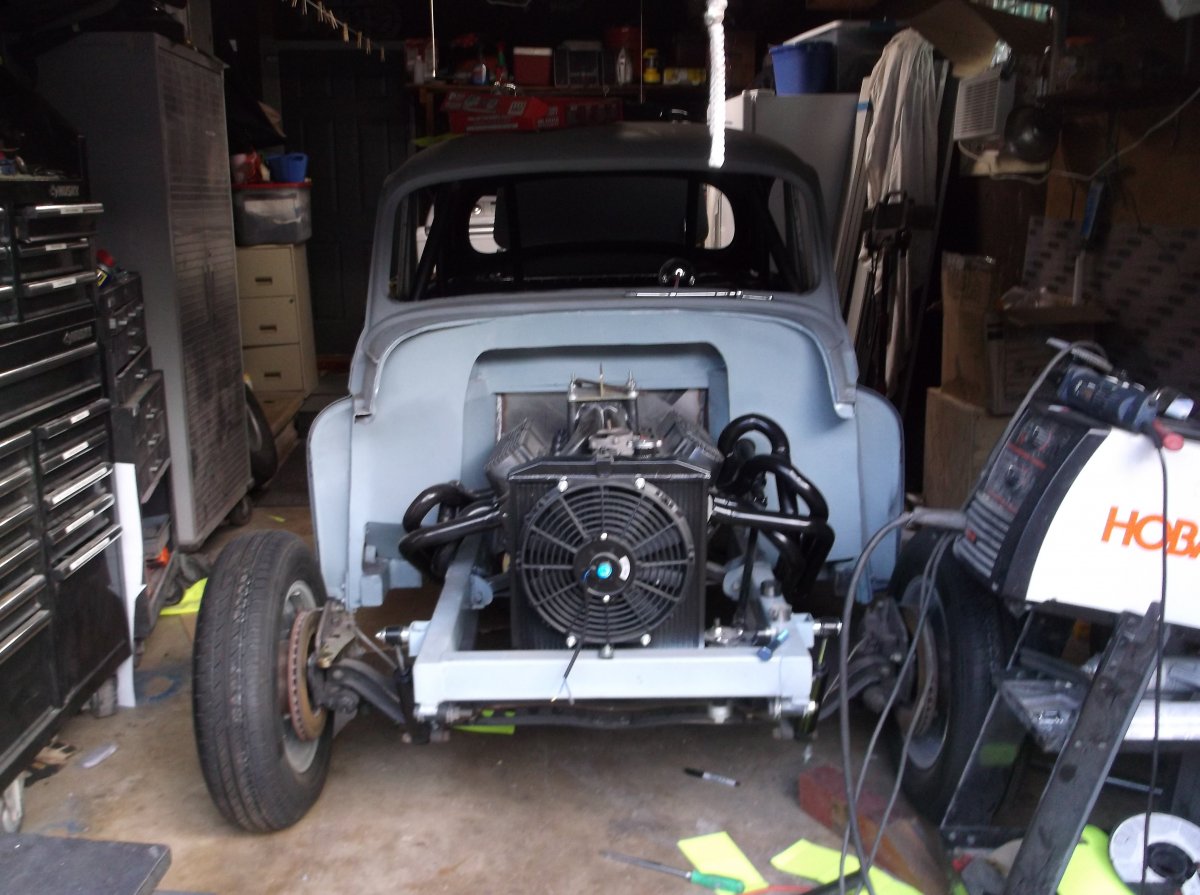

    I narrowed my '58 Chev I beam axle 5' to fit under my '39 Chev coupe. I did a "Z cut" and not a butt weld, as the Z cut makes a much stronger repair. I cut clear down through the I beam, and then cut half the top off one side, and half the bottom off the other side. Overlapped the two halves the 5" and beveled the edges of all mating surfaces. Then welded the joints from both sides, and after grinding the welds smooth I cut a piece of 5" long 3/8" mild steel inside the backside of the beam. Perimeter welded the plate, and it was done.
    It's likely stronger than it was before narrowing, and I see no reason to ever plate the front side also. I used 1.5" EMT tubing clamped to the axle beam to keep it aligned while I welded it on top, bottom, and one side. Then removed the tubing, and welded the other side.

  7. 1971BB427
    Joined: Mar 6, 2010
    Posts: 6,240
    1971BB427
    from Oregon
    I welded my axle with E70 mild steel wire on my Miller mig welder. It's a '58 Chevy 1/2 ton pickup axle. Welded more than one previously, and never had an issue. This image was as I was mocking it up under my '39 Chev coupe.
    And this is after grinding the front side. You can see the way it was cut down and across on the top, and up and across on the bottom to create the overlapped Z cut. After plating the back side I drilled the same "lightening" holes through the plate again. So it's thicker behind, but doesn't show from the front side.
    Not every axle should, or can be welded on. But the 1950's Chevy pickup axles can, as can the Ford truck axles of the same era. So can 60's Chevy van axles, and Ford Econoline axles.
    People who say axles shouldn't be welded on are often passing along the myths. And they're the same people who say nothing in your steering systems should be welded also. I weld up all my tie rods, and drag links using heavy DOM tubing, and weld bungs. They're far stronger than the wimpy threaded tubing most places sell as tie rods or drag links.
    PS-It also depends on where you're welding an axle! The center of an I beam has less stress on it than any other point on these axles. The further out towards the kingpins, the more stress. And anywhere outside of the springs should be no place to weld.
    I'd be more concerned with axles having the drop changed outside the springs, than welding in the center. I know it's done for years, but heating an old axle and bending it to reshape the drop always made me nervous.

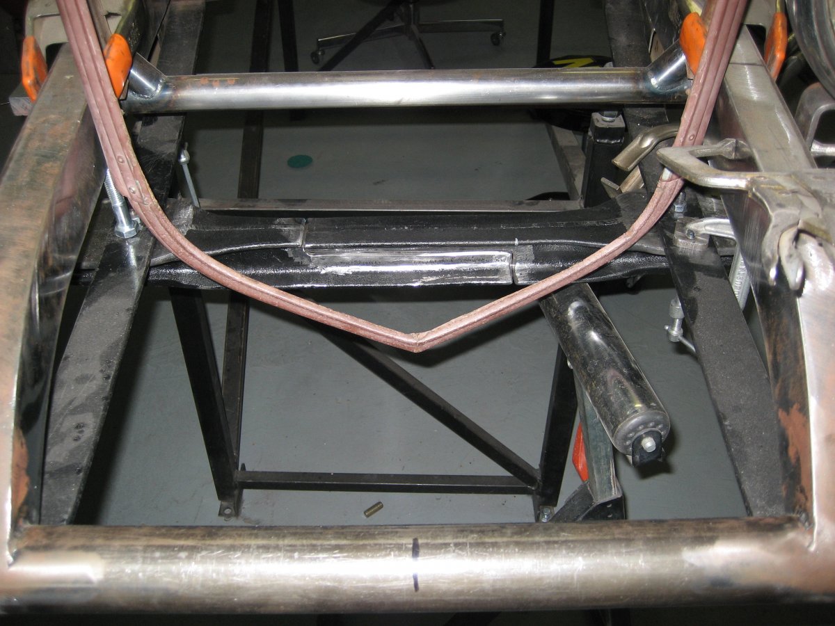

  17. southcross2631
    Joined: Jan 20, 2013
    Posts: 4,179
    southcross2631
    My avatar Morris Minor has a 1953 Ford F100 axle under it . It was given to me with a new disc brake kit and braided brake lines so I cut 6 1/4 inches out of it to fit my car.
    I simply made a jig to keep it straight after I cut it and stick welded it back together. I put a fish plate on the back. After I welded it back together I put it in my 40 ton press and tested the welds.
    After I was satisfied it wouldn't break I drilled a series of lightening holes in it. DSCF3461.JPG
    seb fontana likes this.
