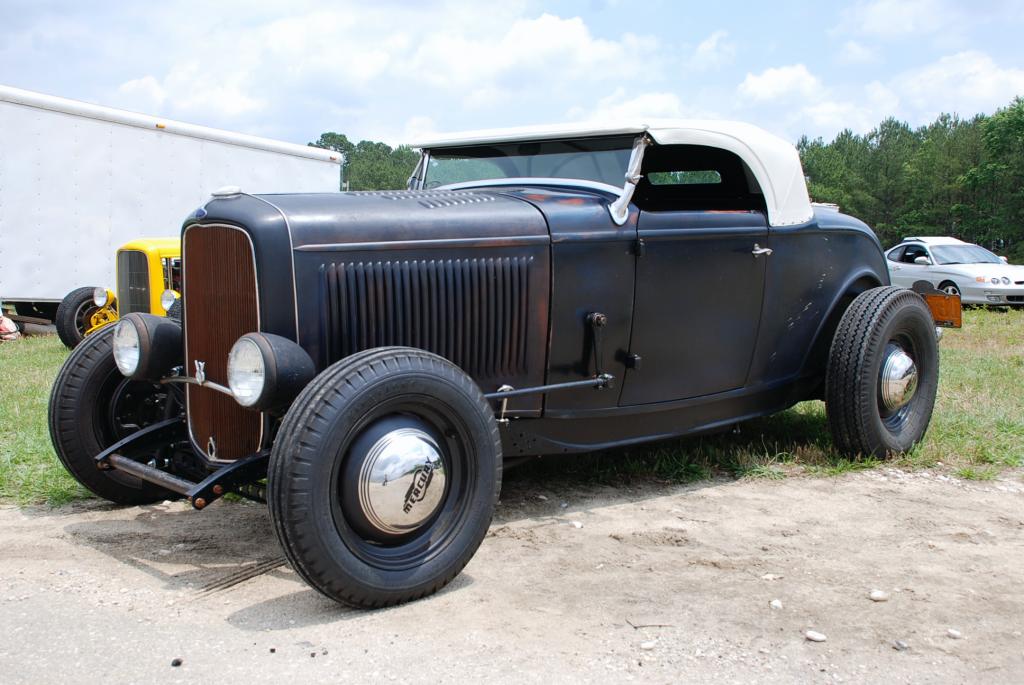

    I Just got back from Maxton about 600 miles with a new pair of 750/16 Nanco unbalanced and they did fine...
    A Boner likes this.
  20. revkev6
    Joined: Jun 13, 2006
    Posts: 3,350
    revkev6
    from ma
    they look pretty good, but they are 10 ply aren't they :eek:
  21. jackandeuces
    Joined: Feb 20, 2006
    Posts: 1,046
    jackandeuces
    Yes they are 10 ply ,and a little hard . My logic was they can not be any worst than front tires ,so I took a chance...As I said they did OK....
