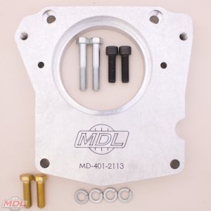

  15. Desmodromic
    Joined: Sep 25, 2010
    Posts: 571
    Desmodromic
    Pictures of the truck bell housing, and the corresponding adapter to a later Ford transmission. You might be better off to sell your adapter, buy a new one for a transmission of your choice. images (8).jpeg md-401-2113-new-edit_937_general.jpg images (7).jpeg
