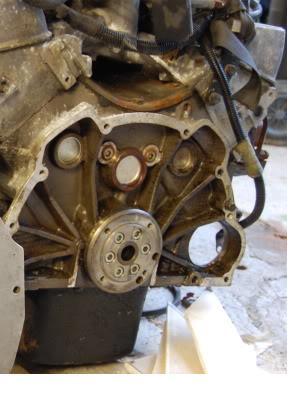

    Yes, the Buick 300 has the same BOP bolt pattern just like the 340, 350 and the 225, 231, and 252 V6's.
    The earlier 61-63 198 V6 and 215 V8 are what is different. Here's a Pic:

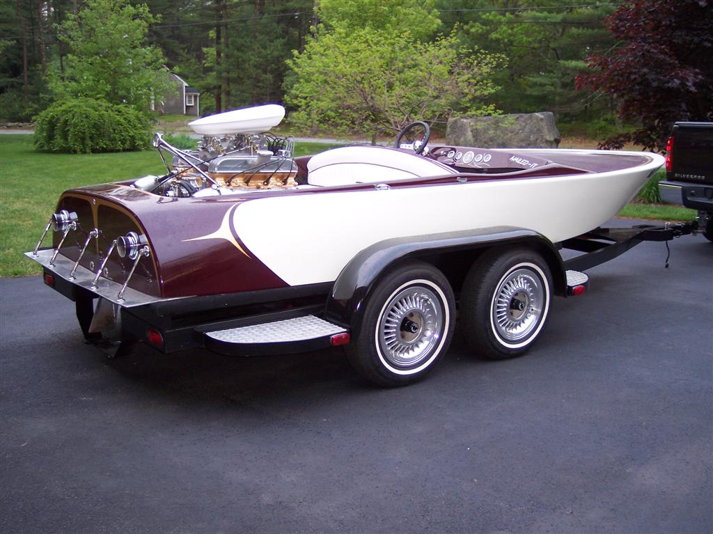

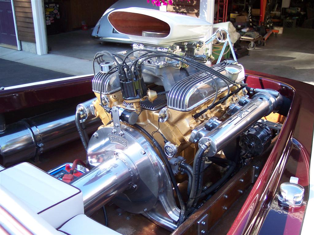

    Who the hell would want to put a Nailhead in a boat or anything for that matter???:eek:
    I bought my '65 Stevens for the 354 Hemi that was in it and the 55 Caddy wheels that were on the trailer with plans of chopping up and scrapping the hull and trailer. Once I got it home I had a change of plans!:D
    A few before and after pics...
