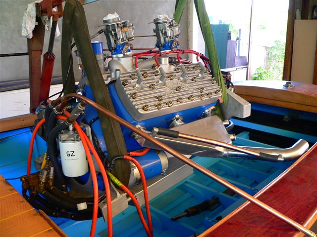

    Just measured venturi size about 15/16". Holley 94 was .94" and Stromberg 97 was .97", so the venturi is similar! Read that the later holley's went up to 1 1/16". After a bit of a search it seems the Holley and Stromberg's flow in the 160 to 175 cfm range, no idea what the Marvel-Chebler flows.
    I originally was going to cut gaskets but found a supply of nos gaskets (see picture) selling marine carby gaskets! Lighter springs for the enrichment circuit came from a local bolt supplier. Pump buckets are riveted on and leather, Quadrajet ones are the same size and I machined up new pump rods.
    Performance; They have performed without any issues since 2009 and have spent the last 50 odd hours on top of a blower running 3psi, just had to lean off the idle mixture from running on the na manifold.

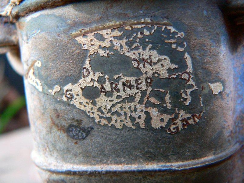

    Any forensic types here that can descipher the old decal?

    All I can make out is:
    Division
    Borg-Warner Corp
    Michigan
    Reading between the lines, I assume that means Marvel-Schebler Division, Borg-Warner Corp. Flint, Michigan. Since they moved to Decatur, IL in 1948, that gives you a rough date of your carb's age.
