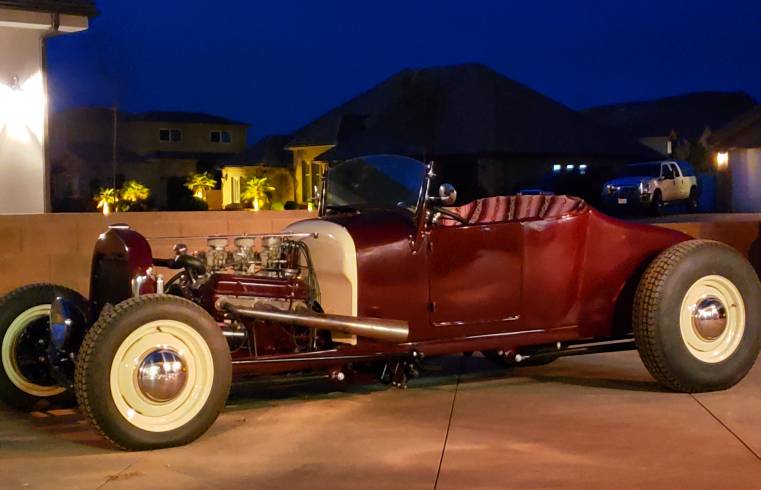

    Hey guys, ran the roadster around the neighborhood for a bit tonight - still has death wobble but significantly less. I'm going to play with tire pressure and see what I can come up with. Rear main seal is puking out oil so that needs attention too.
    As the sun was dropping behind the hills we had another amazing desert sunset, figured I'd shoot some pics as the lighting was great.

  27. Looks great, Eric. Your front tires look half inflated, I run 24 psi in mine and looking at the drag link angle to the radius rod angle this may give bump steer. I hope im wrong. Do you have any movement anywhere in the front end? May I suggest removing the front panhard bar and trying it out as going by the angle of the front shackles it won't need it unless the front spring settles some what. JW

    Thanks Jeremy. The tires are at 20 PSI, I think I'll take them up a pound at a time and see what happens. The drag link is parallel to the split bones although it may not look like it. No movement in the front, dropping the (unnecessary) front lanyard might be worth a shot.

  29. With those shackles as straight as they are there is no room or very little room for any movement and if the Panhard bar moves in an arch at all it will pull the front axle to the drivers side them back to centre. You need to try one thing at a time or you won't know what fixed it. Good luck and looking OH so good. JW

    20 psi sounds way too soft to me. I run 30 psi in my front tires, which is what Coker recommends for my application (525-16 bias plys). What's written on your sidewall?
