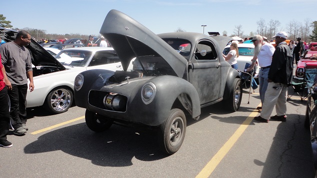

    drooled on this today at a local show.
  22. 1971BB427
    Joined: Mar 6, 2010
    Posts: 7,474
    1971BB427
    from Oregon
    What was he running for engine and trans Dave? Is that a clone, or a real deal survivor Willys?
  23. Here goes my reputation!
    I didn't meet the owner. I didn't photo or pay much attention to engine. Sorry. Sad when I think back on it.
    Manual trans.
    Here are a few more picks. Tough to say if it was a survivor or not. I would lean not. 009.jpg 010.jpg 016.jpg 024.jpg
