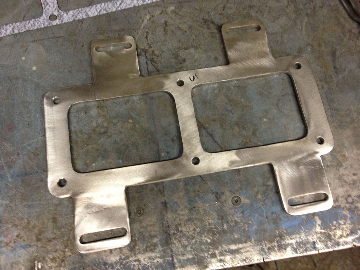

    I've always liked the look of Blower restraints so decded to get one, I was gobsmacked how much they were for a good one $450 plus, I don't actually need one so thought lets make one.
    Heres the look I was after
    Don't look that hard to make :)
    I didn't have any plate wide enough so went with 6" wide 1/4" stainless and made the strap ears seperatly, first job was to cut slots in the ears for the belts.
    Next job was to mark out the main plate and drill the mounting holes, plasma out the squares and weld the belt ears
    I was going to make the straps out of ratchet strap material but couldn't find the flame proof covers so ended up buying some proper straps that came with the covering, not really that expensive.
    Next up I plasma cut the anchoring plates in 3/16 BMS, luckily I had a friend nearby with a restraint on his blower so popped in and copied the rough shape. Found some 3/8" tube for the release pins so welded them on.
    I have a box of old pip pins and as luck would have it there were 4 x 3/8" in it which were perfect length.
    Can't make my mind up to either polish the stainless or black powdercoat it, Total cost ended up less than $100 :D

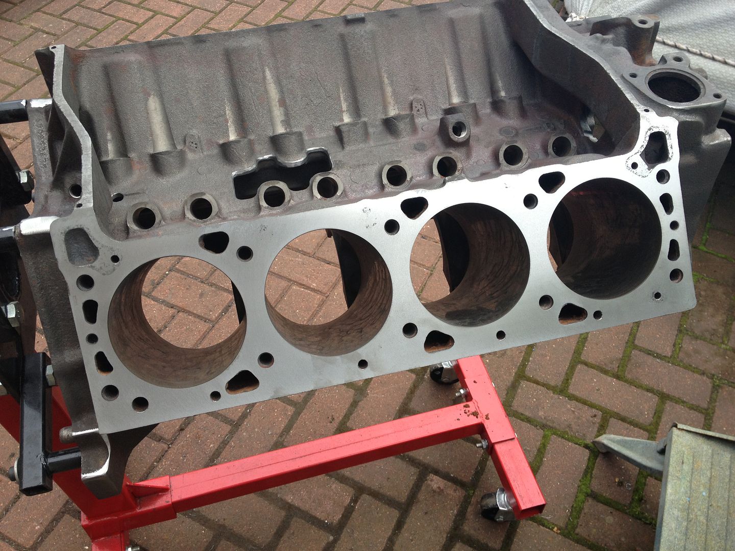

    Well i'm on a mission now so the block was taken straight to the hot tank for a good soak and clean while i painted the sump, got the block back and took it straight to my mate Brians machine shop where it was put on the Bridgeport to deck the block surfaces, 5 thou was all it needed which will also help improve the quench point.
    While it was on the mill the main cap dowels were fitted, the dowels live in the caps and the block is reamed to accept the dowels, this improves the solidity of the main caps a lot ad prevents any walking. also the tops of the main caps were all ground the same to accept a main stud girdle.
    Once all the precision machining was done the rest could be done at home so loaded up the block into the car and when home first job was to remove the excess casting flash from the block.

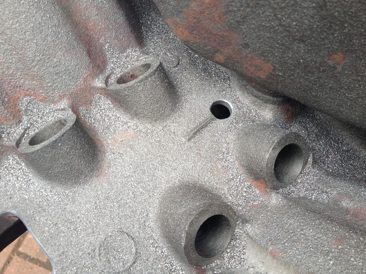

    Cadillacs suffer oil puddling at the rear of the lifter gallery so to get the oil back to the sump quicker a 1/2" hole was drilled in the rear of the gallery, also to get a little more oil to the timing chain the front drain hole was grooved slightly to get a little more oil to the timing chain.

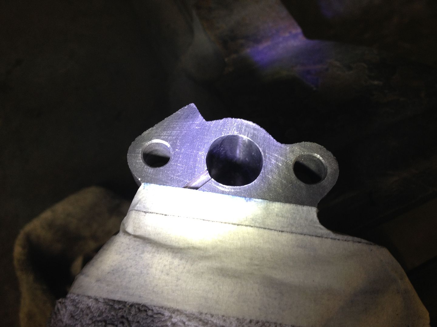

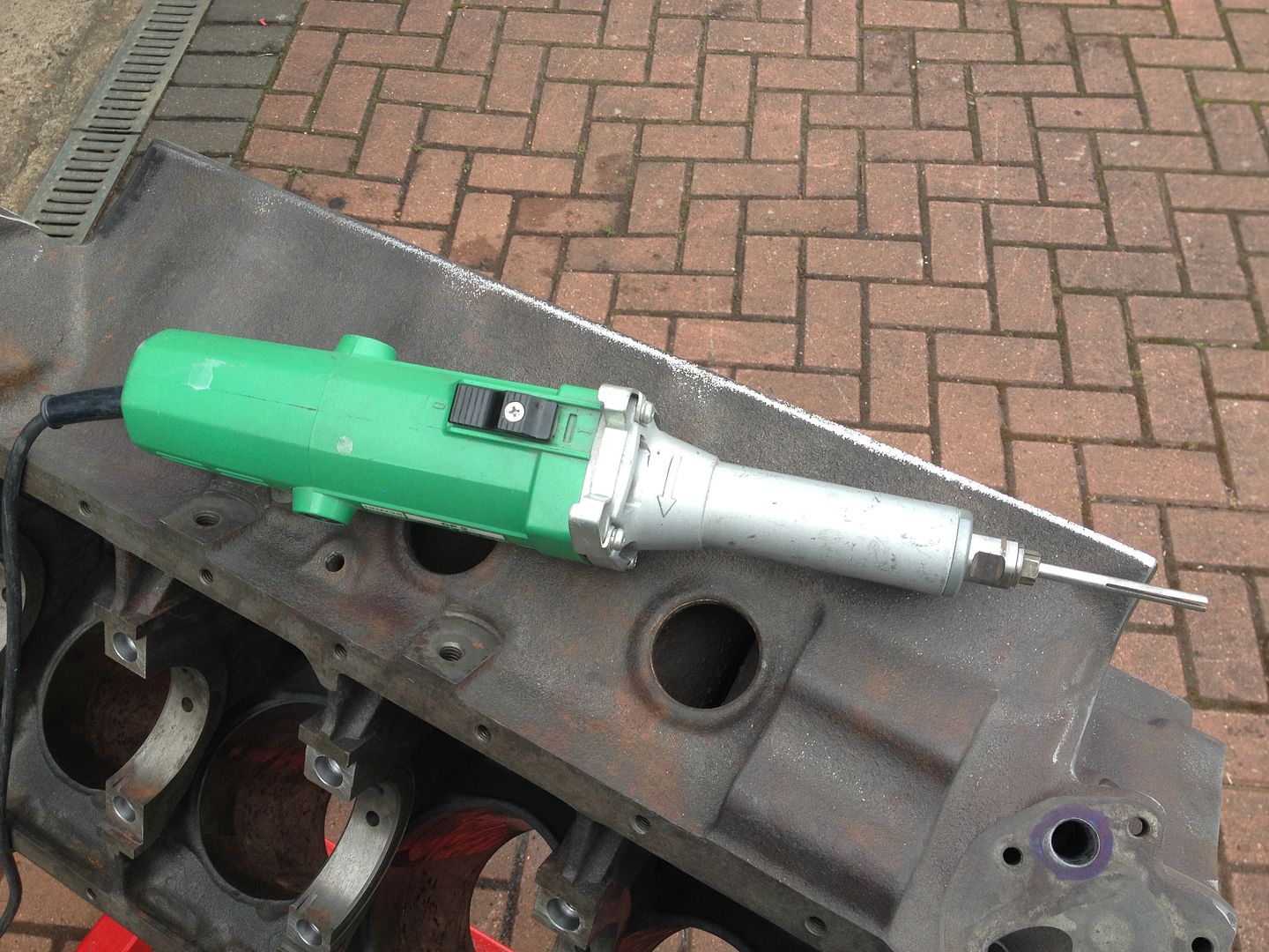

    Next job was to check the alignment of the main oil pump gallery, the pump is a modified Mellings pump, I was slightly surprised how rough the pump gallerys were so they got a complete smooth and polish, as you can see it was a little undersize and off slightly, a few minutes with the die grinder soon put it right and then the gallerys were polished to smooth the oil flow.
    That just about completes all the mods to the block so monday it will be off to be bored for the Probe forged pistons, hopefully won't be away too long as i'm champing at the bit to get it together.

    Nice work - please Heli-coil that oblong oil pump mounting hole.
  29. langy
    Joined: Apr 27, 2006
    Posts: 5,735
    langy
    Cheers, I think its the way the pic has been taken as its actually fine.
