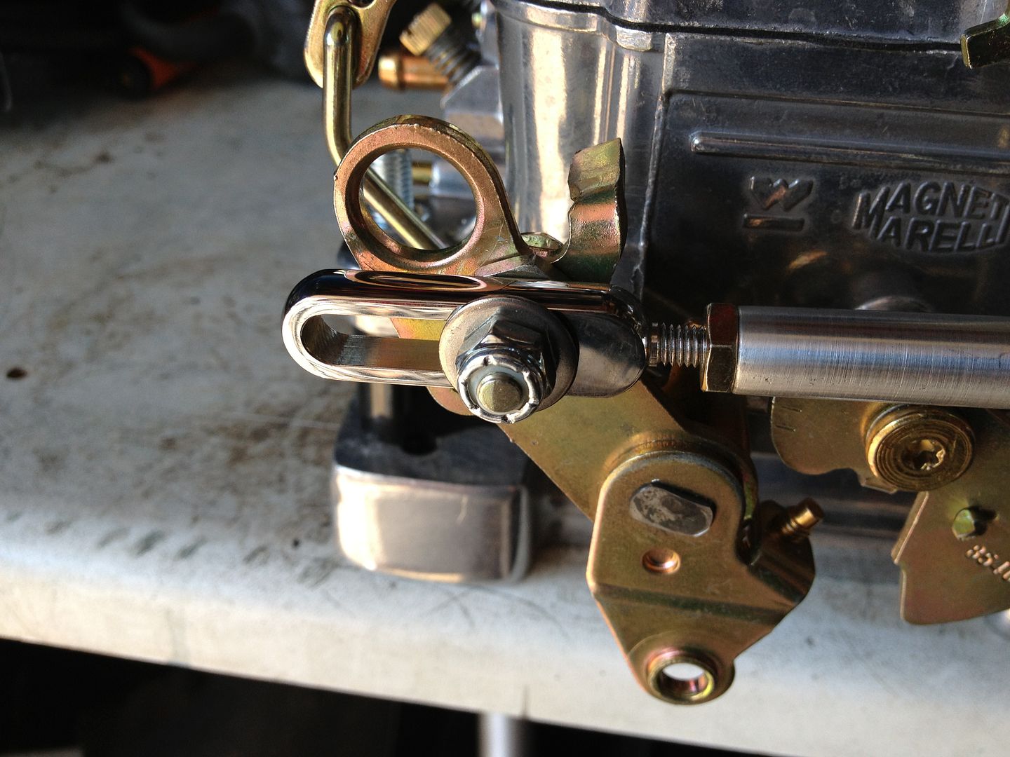

    Had a couple of hours spare this afternoon so decided to make a progressive linkage, Some of the bits that came with the carbs was Lokar but I was missing the main link rod between the 2 carbs, A quick search around the net gave me a picture so I found some round aluminium bar so drilled and tapped it to make it adjustable lengthwise, a small rose joint on the end and it all looked fine, the other end I machined up a bit of stainless to make a slotted end to make it progressive, my new milling machine has come on handy once again, how did I ever get by before I had it A quick polish and thats another pesky job ticked off
  3. very nice! Are you going to use the chokes on the carbs? if not I would remove the choke plates and all the linkage to clean things up a bit, maybe ditch the Edelbrock and Made In USA stickers, then they look like they belong.

    Maybe, I will see once its all fitted, the stickers don't bother me too much.

    Just personal taste, but the Edelbrock and Made in USA stickers take away from the mechanical simplicity look of the AFB.

    Langy fantastic work as usual. I have a question on your linkage. Are you using the rear carb as the primary carb and the front as secondary or am I not seeing it right? Usually it's just the opposite.

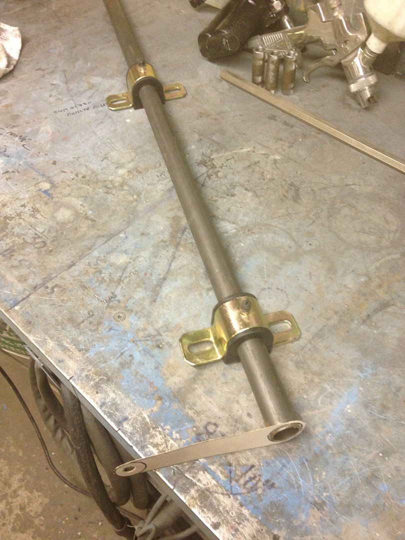

    Well whilst waiting for my heads to arrive I decided to make front & rear anti roll bars for the car, they are made from Chromemoly tube, 1" at the front & 3/4" at the rear, I'm using some Energy Suspension chassis mounts and an adjustable link each end comprising of 3/8" rose joints and some turned down stainless hexagon bar.
    The dual blades each end get boxed off to stop any twisting.

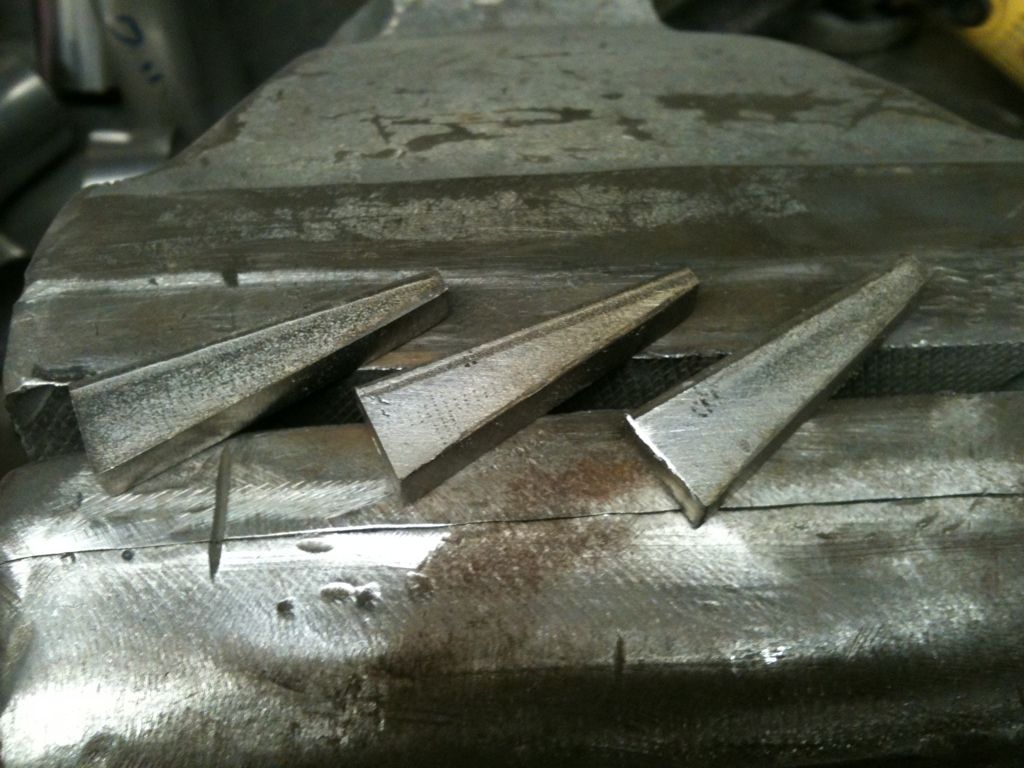

    Finished the blades last night.

    So did you have a way of determining shaft size and arm length? or are you just taking a wag at it and rebuild latter if neccisary? I have thought about doing the same on one of my cars and just wonder if i could save some time with some calculations or just go for it and and redo if needed.

    Calculated it mate, there is a chart on the Hotchkis site somewere, I reckon a 1" OD will do for me just about right.

    That sway bar is so cool!
    What is the Wall thickness? Or ID compared to OD?
    How thick and long is the bars/plate at the end?
    Could it be done with normal miled steel pipe, in a different size/wall thickness?

    Its 1" OD Chromemoly tube, its either 0.83" or 0.95" I will have to check as can't remember, 36" long
    Blades are 5" centres and are 1/8" BMS although I may remake them as I now have some Chromemoly plate
    Normal steel tube is no good as it don't have any memory.
