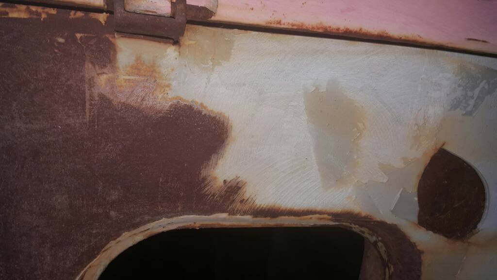

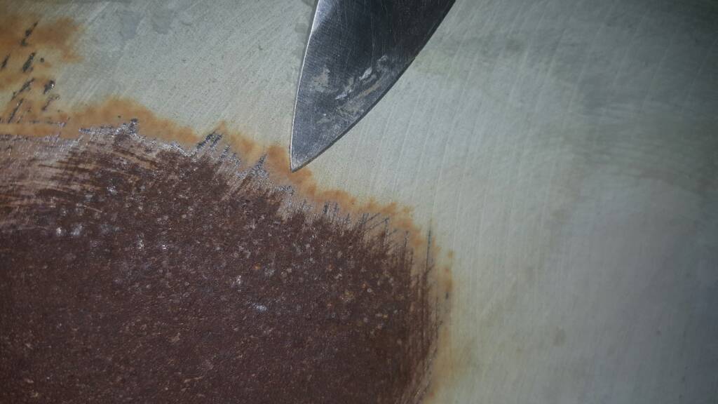

    I did pull top layer of paint off of the rear doors. Perfect example of bodyfiller going over bare metal vs epoxy first... But that's a different discussion.
    You can definitely see moisture went through the bodyfiller.

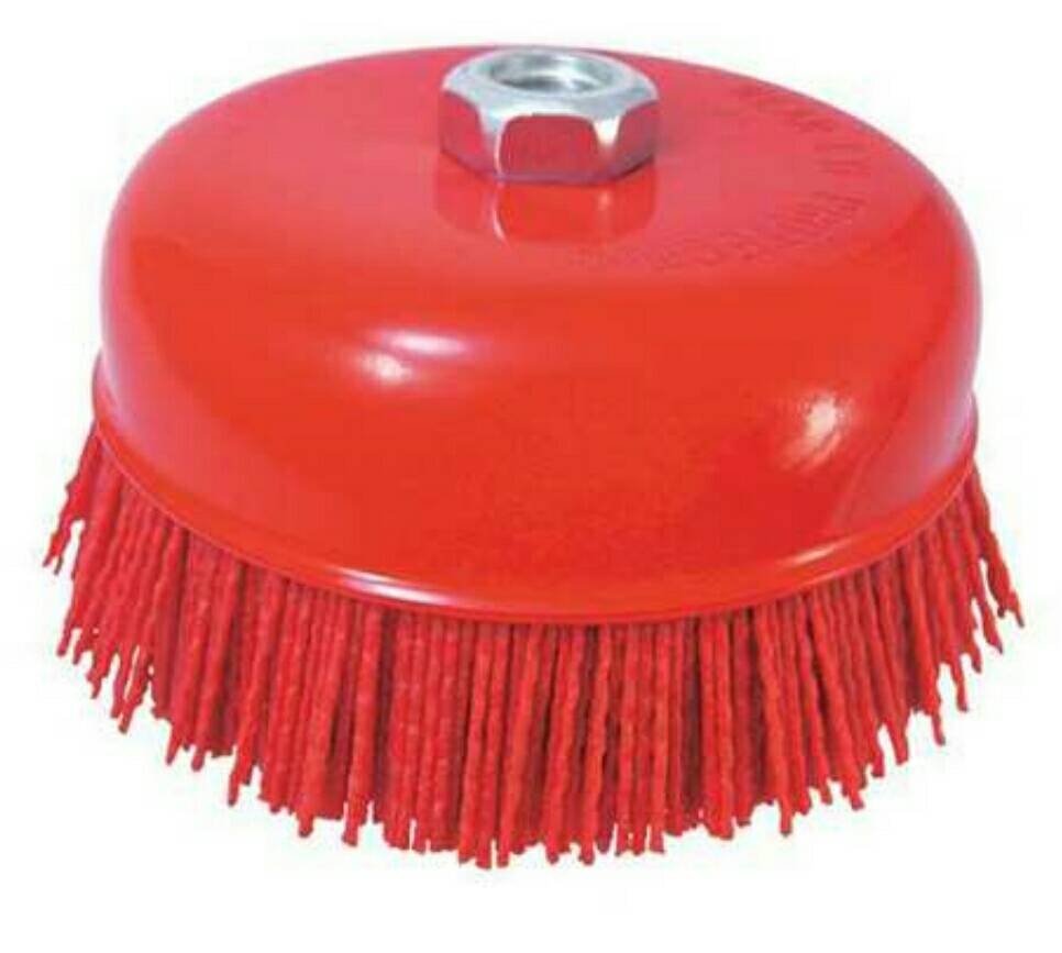

    We are going to start on the inside, all the wood has been replaced with metal, and the metal is flash rusting, so I am going to sand / wire brush then use the dtm reducer and epoxy.... That is if this new scuff wheel thing comes in. The guys doing bedliners use it and it is nylon and has grit on it. It connects to a variable speed buffer. It is supposed to work wonders for hard to reach areas. Here is a picture of the tool.

    Industrial strength scotchbrite brush that is progress. :p

  30. wouldn't it be better, cheaper, faster to have it blasted? i wouldn't waste my time with that brush thing.
