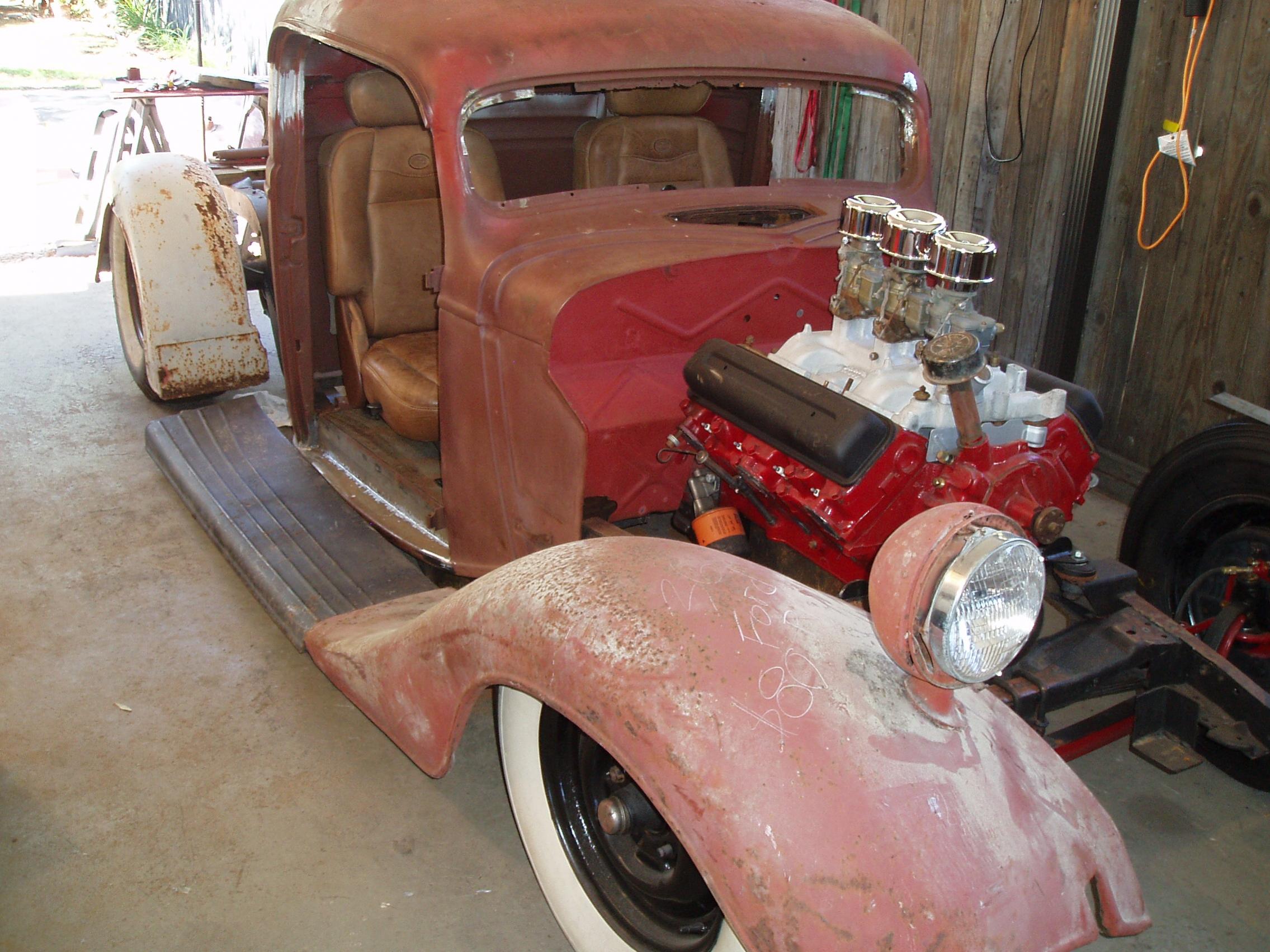

    I thought I'd start this build thread hoping it can help other non professional, garage builders. I picked this up a little over a year ago from another hamber. A lot of had already been done but needed to be refined. 1935 ford , 49 olds 303, channeled 3", frankland quickchange, firestone cheaters on wide 5, 3 strombergs.

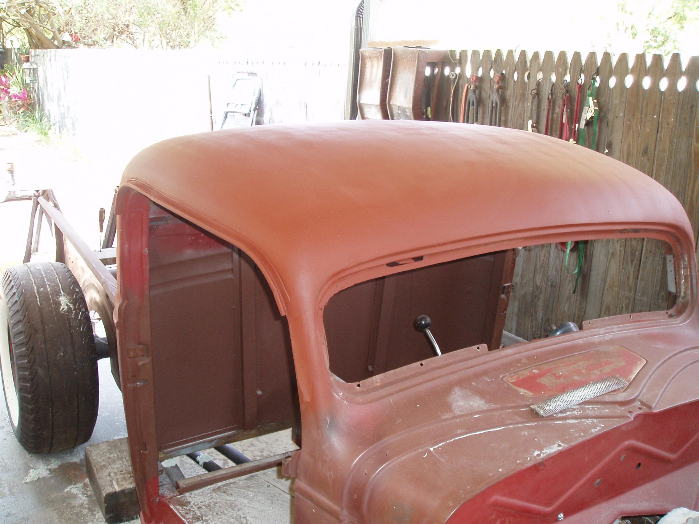

    I wanted to build a copy of the Canada customs 37, I thought I'd look good driving one. When getting ready to z the frame I made it to bolt together till I could find the right combo for the look I wanted. Started with a 6" z which gave the right look for a fenderless truck. Now how much to chop the roof. 5" is what I wanted 5 1/2 is what I got. That extra 1/2 was for squaring the cuts. When welding the posts together I used the cutoffs to insert into the doors and roof post, plug welding them in place. This helped reinforce the joints an help with alignment.

    More pics. I don't know how others do it but when trying to weld the extra 2"in the top of the roof the original metal would just blow away. I don't know if sitting in ths elements for so many yrs changes the metal temper. I ended up spotwelding strips to the inside of the roof to use as a support and a heat sink. I know others just use the clamps and butt weld, but this didn't work for me

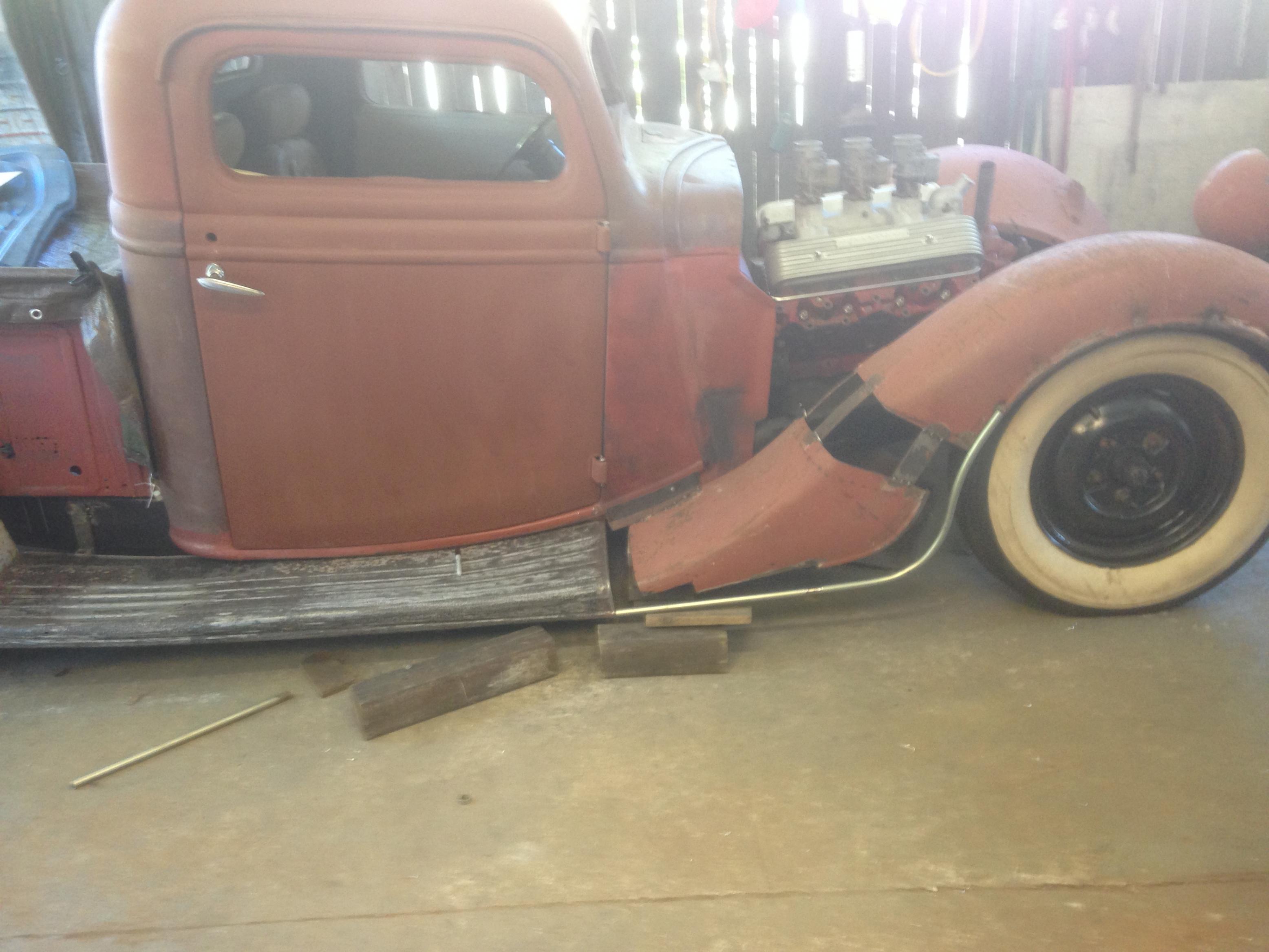

    Well as everyone knows ideas on projects change. At the turkey rod run I found a set of fenders and running boards that I couldn't pass on for 160.00. I've been seeing more and more fenderless trucks (rat rods) lately, and after posting some pics of the 35 with fenders and boards mocked up, with positive comments, I decided to go full fenders. The big issue was that with the 303 the cab needed to be pushed back 4" which means the fenders needed to be streched. I rearched the wheelwells using a conduit bender set up on my table saw, that is now used as a welding table.

  6. looking good!

    I've got no chassie pics now but need to tear down again. I"ll get some then. Here some of the inside. The P.O. gave me a 54? olds guage set so I set it in the dash.I finnished the firewall, tunnel, floor.
