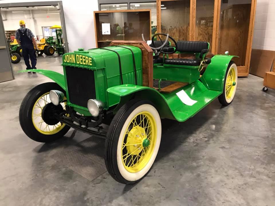

    speedo.jpg So I built this. Deere radiator, two cylinder vertical flathead engine, pedals, steering, seats and more. T frame with model A axles.

    That’s a one of a kind ride there. Do you drive it anywhere?

    Got it done for a show in June, but still working through some clutch and brake issues that make it a little scary to drive in traffic. I bought an aftermarket clutch disc, which I found out was a little too thick and I had to go in and put washers between the flywheel and pressure plate. The linkage to the brakes needs some better engineering also.

    Very Impressive...especially with the two cylinder.. Love it.

    Quick yet blurry video of the engine running. It's only rated at 15 horsepower, which isn't that far off a model T. It has a heavy flywheel and will spin the rear tires.

    Doesn't look like will have any cooling problems! NICE and green, too! Gary

    No, the original radiator for that engine is about 12x16.

    It's actually scary fast. Not so much top speed, but it is geared too high for close quarters. No way you could drive it on a trailer. If I had to do it all over again I'd have used a four speed tranny with a creeper low.

    It's out of a model 12A Deere pull type combine from the 1940s. It's actually the same engine used in a model "LA" tractor. As some of you probably know Deere used two cylinder horizontal engines in anything over about 20 horsepower, so I didn't have a lot of engine choices.
