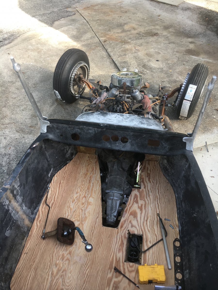

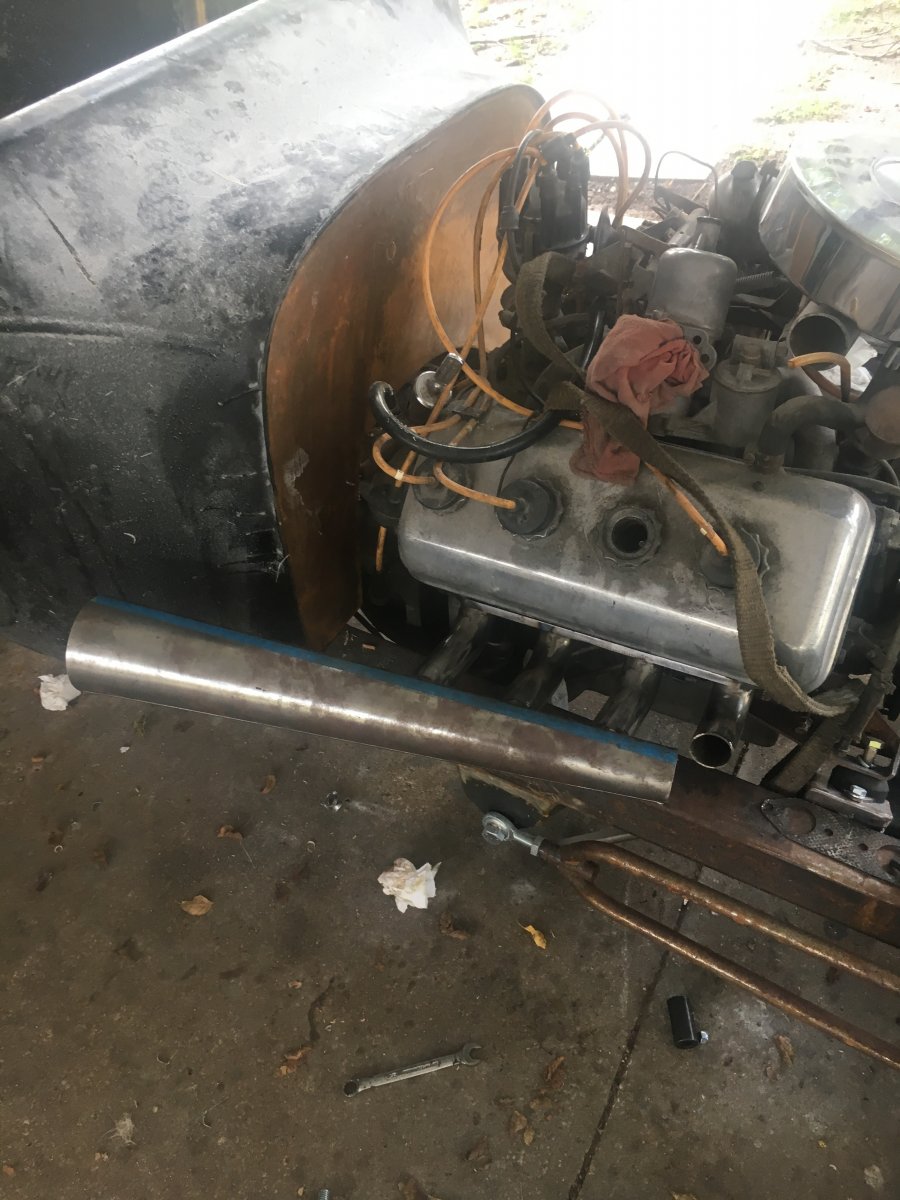

    435CCD2B-EB61-4553-8AFA-8DB3C0FDDB87.jpeg 9BA4DE64-ECF0-4D43-9671-A18493546297.jpeg A16534EF-A070-4268-B311-E7EEFC2688A0.jpeg 56E34EDB-BCEB-4556-80ED-744C43D08C59.jpeg 435CCD2B-EB61-4553-8AFA-8DB3C0FDDB87.jpeg 9BA4DE64-ECF0-4D43-9671-A18493546297.jpeg A16534EF-A070-4268-B311-E7EEFC2688A0.jpeg 56E34EDB-BCEB-4556-80ED-744C43D08C59.jpeg 435CCD2B-EB61-4553-8AFA-8DB3C0FDDB87.jpeg 435CCD2B-EB61-4553-8AFA-8DB3C0FDDB87.jpeg 9BA4DE64-ECF0-4D43-9671-A18493546297.jpeg A16534EF-A070-4268-B311-E7EEFC2688A0.jpeg 56E34EDB-BCEB-4556-80ED-744C43D08C59.jpeg 9BA4DE64-ECF0-4D43-9671-A18493546297.jpeg 435CCD2B-EB61-4553-8AFA-8DB3C0FDDB87.jpeg 435CCD2B-EB61-4553-8AFA-8DB3C0FDDB87.jpeg 9BA4DE64-ECF0-4D43-9671-A18493546297.jpeg A16534EF-A070-4268-B311-E7EEFC2688A0.jpeg 56E34EDB-BCEB-4556-80ED-744C43D08C59.jpeg A16534EF-A070-4268-B311-E7EEFC2688A0.jpeg 56E34EDB-BCEB-4556-80ED-744C43D08C59.jpeg I’m using a 1963 2.5 liter Daimler Hemi V8 with a Borg Warner 35 three speed auto. It’s all British made stuff.
    I had bought the engine in 2014, the intention was to build a sports car, but I couldn’t find a fiberglass body, I had this T body that I had bought years ago sitting around and in a moment of anger I decided to build this thing.
    I am almost finished, just an interior and windshield away. This is 18 months work condensed into this post.
    Because I wanted to keep the Brit theme going I made life hard on myself and made it right hand drive.

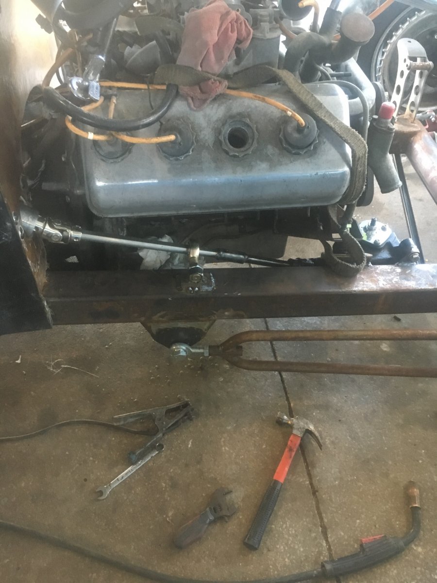

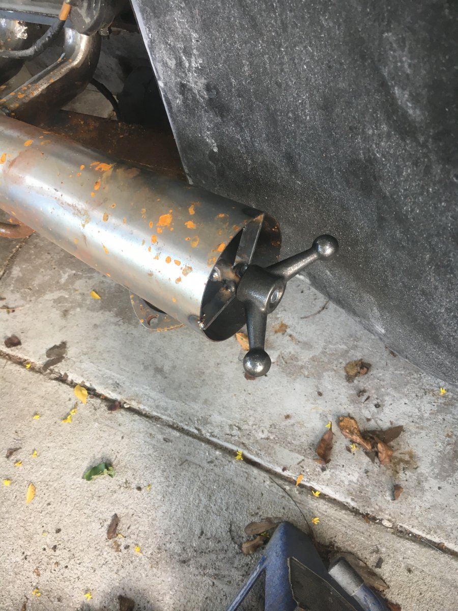

    Anyway, because of the odd engine I used I had to make everything from scratch, motors c mounts, transmission mounts, headers, etc. 3FFB0AD3-6E6A-44AB-B74B-90D4E1E4EBC2.jpeg C527817F-2DB4-4540-BEC9-D527744C48CF.jpeg 41F5F46F-88CB-4A3D-BE1F-D41E7F2536A4.jpeg 9F171780-7A48-46CB-8B7C-D4B8B889912D.jpeg 3FFB0AD3-6E6A-44AB-B74B-90D4E1E4EBC2.jpeg
