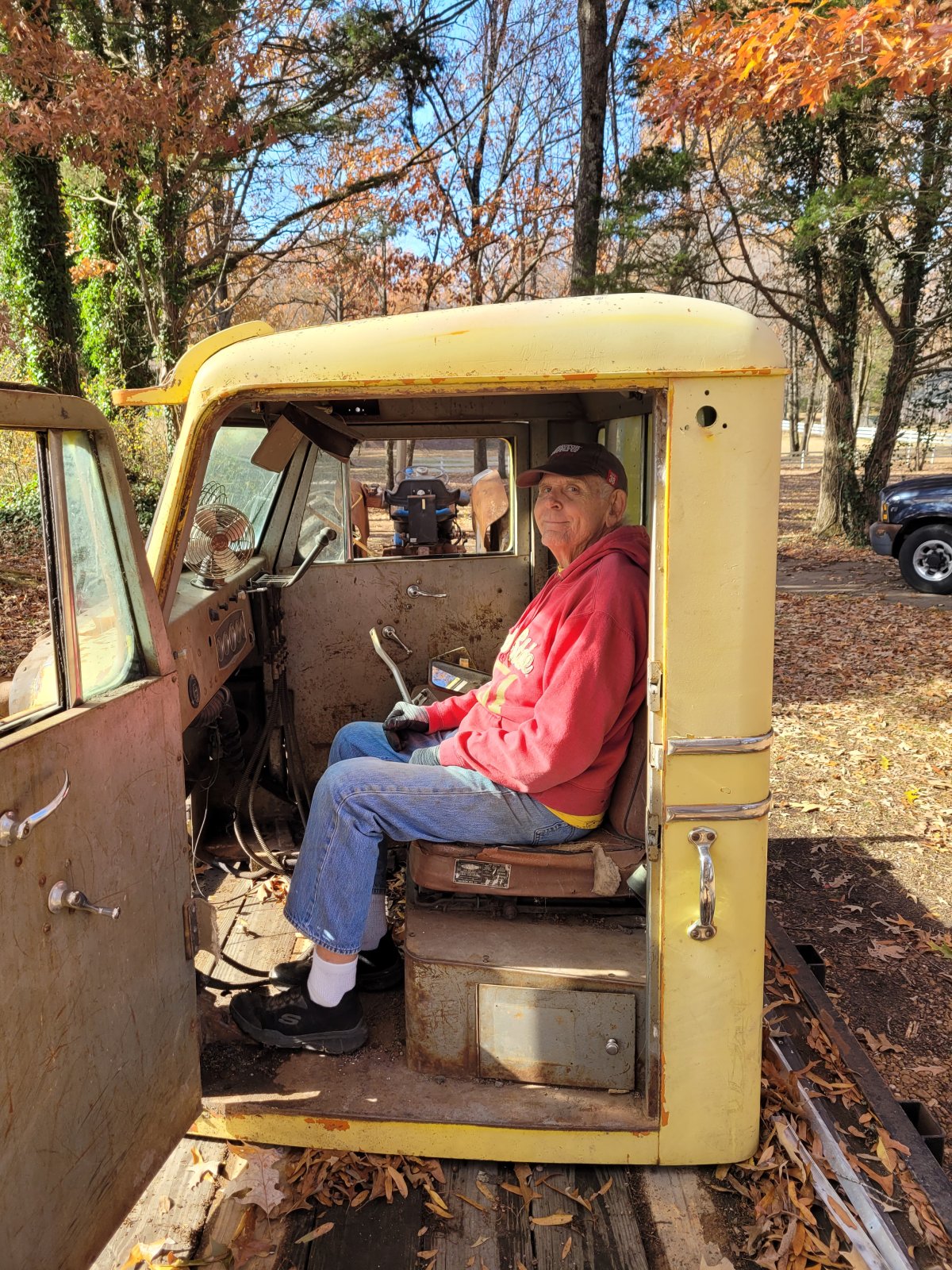

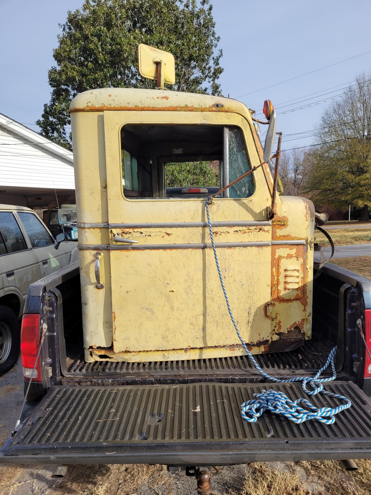

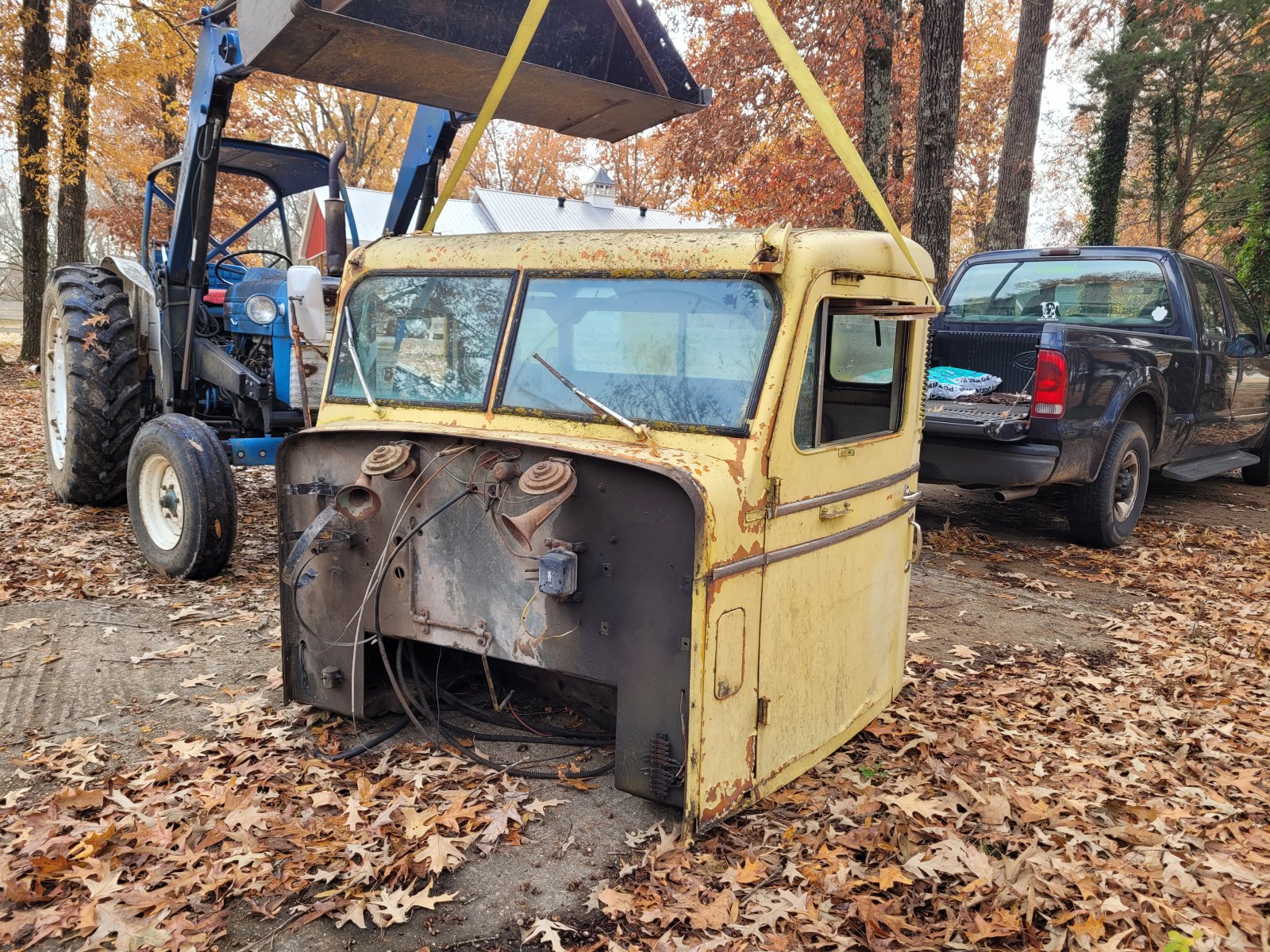

    Fast forward a couple weeks and I found an Oshkosh snow plow cab for sale (also in Nebraska). We went and picked it up on Thanksgiving.

    This cab is supposedly from the mid 50's. But the styling looks earlier.
    And has a cool stewart warner instrument panel.
    It does need work to blend with a Seagrave, but it is closer than anything else I've seen.
    ....and it is an all steel body.

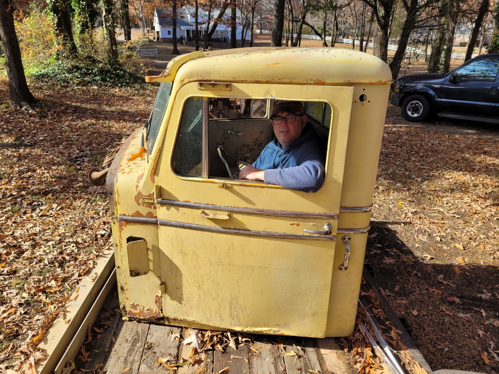

  7. Flipper
    Joined: May 10, 2003
    Posts: 3,395
    Flipper
    from Kentucky
    But it is big enough to maintain the proportions of a 30's pickup.
    ....a really big pickup
