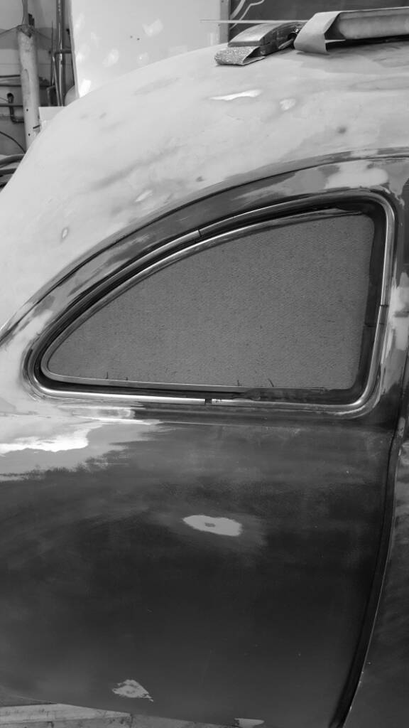

    Getting closer. Clips or weld is the question.

    Rear part of door window channel has a slight curve to it and is noticeable with the glass and stainless in.

    I have a few centers to pick from I use to have a bad habit of collecting parts. I will try and if it works polish it out. The problem with the stainless in a coupe rear window is it's such a weird tight fit and I worry about cracking the welding because you have to really flex them it get them in. I might have him do one and see if he can. Kustoms by Jimmy told me to buy a bunch and practice till I'm happy then do the real ones.
  10. Mr.Dickies
    Joined: Jan 23, 2007
    Posts: 664
    Mr.Dickies

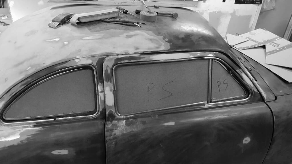

    The stainless pieces are just sitting on there but are cut to fit. Almost done with my window templates to mail them off to have the glass made. The templates were first made in cardboard then in 1/8" melamine. I must have put in and taken them out 20 times. Between getting the gasket to fit and the pieces to fit. I still have to have front pieces welded. The center piece I cut and hammered over and it is pretty nice i just have to sand and polish the end. I have only been putting a few hours in each day before machinist school but it's just about every day of the week.

    Passenger side glass templates done what a stinking pain. It's one step forward two steps back. Gaskets are cut and in place stainless cut and just sitting in place. For guys that have never done a chop the little things are what take the longest. For instance I had the front vents fitting great add the gasket nope rebend put in that fits good make templates for glass nope rebend okay that's better install door glass wow not so good anymore readjust three days later done. Re pop outs are even worse. Now I know why guys never finish their rides or run them without glass. I can say it makes me more nervous to cut the gaskets than the top off the car. Especially now that dennis carpenter doubled his price on most of them. I bought the rears for $50 now they are $100. The non pop outs use to be $25 now $50. Front vents were 1/2 even the little rubber the front vents close to are double. On a positive note I should be ready for primer this week if it's nice.

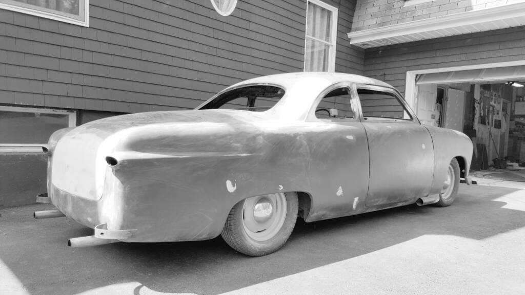

    Moved outside after bodywork finished. Ready for primer now that its not raining everyday.

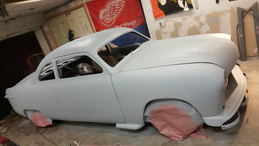

    First round of primer. Needs more body work but it's good for the summer. When i can afford to have a real paint job I'll blow it a part fix a few.things and then gloss paint it.

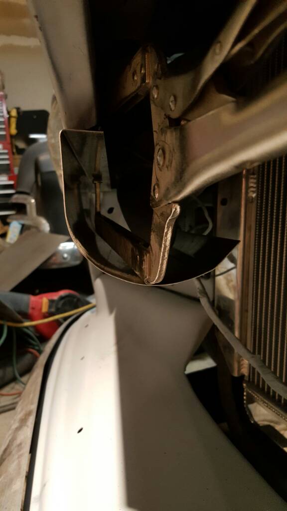

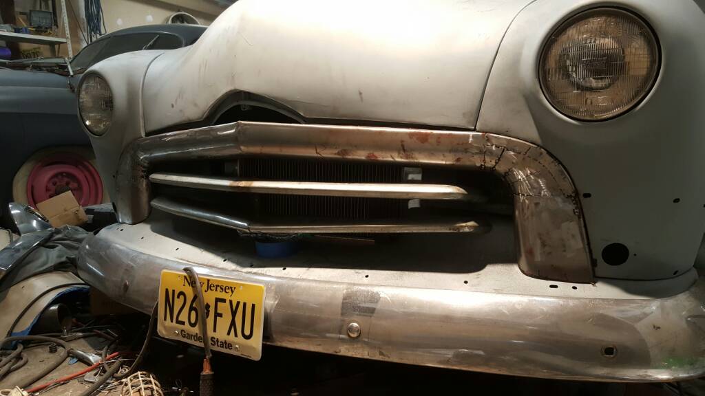

    Sneak peak of the current task. I'm building a merc surround just have the corners left and finish welding it. My still deciding if i will fill the dip or make a piece that fills it that attached to the surround. Grille is a Kaiser Allstate.
    rodncustomdreams likes this.
  21. Mr.Dickies
    Posts: 664
    Mr.Dickies

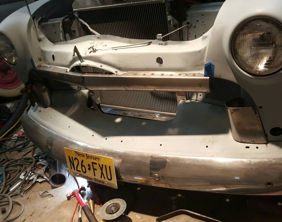

    One side down one to go. Almost forgot to remove the screw behind the bottom piece before tack welding it together.

    I like what you're doing w/ the grille. How are you putting that radius in the surround pieces - not the corners but around the whole perimeter? Do you have a slip roll or ??
  23. Mr.Dickies
    Posts: 664
    Mr.Dickies
    We have a few slip rollers at my work. A huge 8' one and a 36" one. I put it in move to my line then tighten it down then roll it. I tried different sizes to figure where I wanted it.

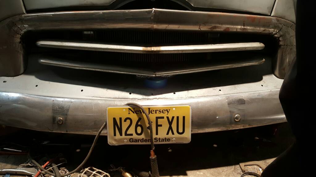

    Mr.Dickies

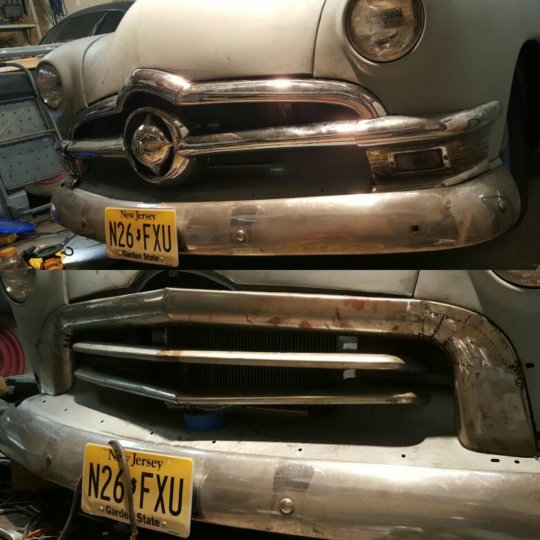

    Here's how I attached it for now. I have to decide if I want to keep it or not. I made it to bolt in so if I change my mind I could go back to the stock opening. Yeah Yeah Yeah i know. It would be less work to make if i was just welding it in because then I wouldn't have to worry about the flange fitting properly but I dream of a meteor surround and this is what I can afford to do. Last meteor surround I saw was mint for $700 so I'll take the $32 for 18g 4'x8' sheet and save the $668 for new wide whites. PS support your local shoebox crew

    Getting there.

    I sold the weld in surround I made after this one to a local guy and bought a louvered hood and don't like it and also not sure if I love the surround as much as I thought I would. So what's your opinion stock or Kustom?
  29. Stock looks fine - but stock.. I kinda like the simplicity of your custom version.. You asked! Anyhoo, I'm enjoying watching your progress and your decisions.
    Dave
  30. bengeltiger
    Joined: Mar 3, 2012
    Posts: 469
    bengeltiger
    I like the custom but the stock is iconic for these cars so either is a winner.
